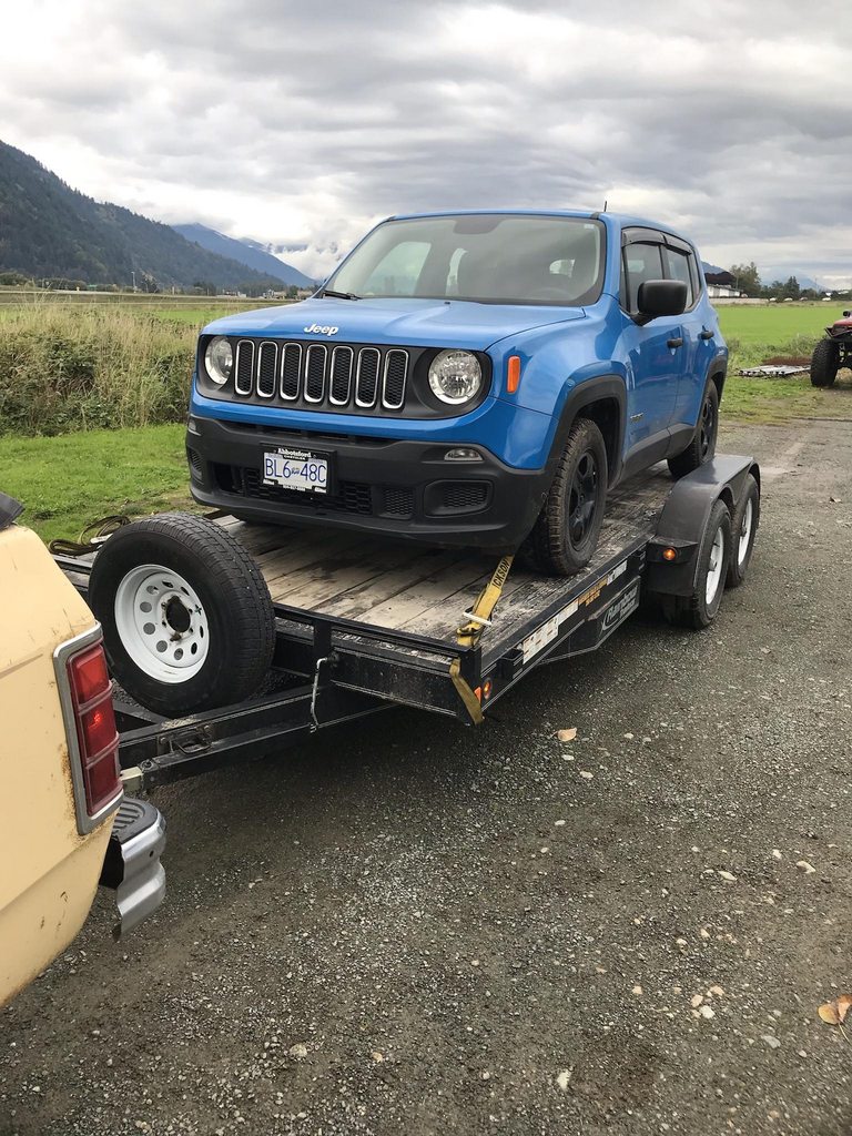

I've had Ol' Patches in the shop for some long over due repairs...been driving my Mom's little Jeep Renegade in the mean time.
Her car had been sitting at my brother place for almost a year after she passed away and my brother wanted it moved so I brought it home when I went down to look after some Will and Estate issues. A few weeks after that there was some major flooding and the whole area where I snapped that pic was under 6'-8' of water! Glad I got it home or it would have been a write off!

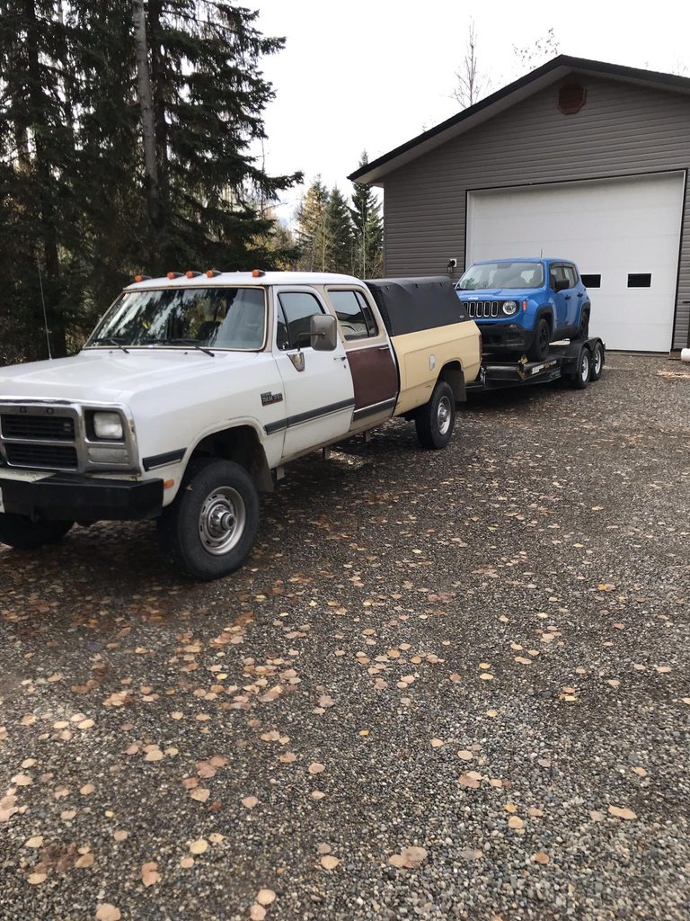

At Home...
I've been taking lots of pics of the work I've been doing, just haven't had time to update yet....will get to it eventually.

Jeeps and cummins! That's my brand! Throw a ducati on dat trailer and you have me exact LOL. Well, not so exact, but the brands right anyway.
