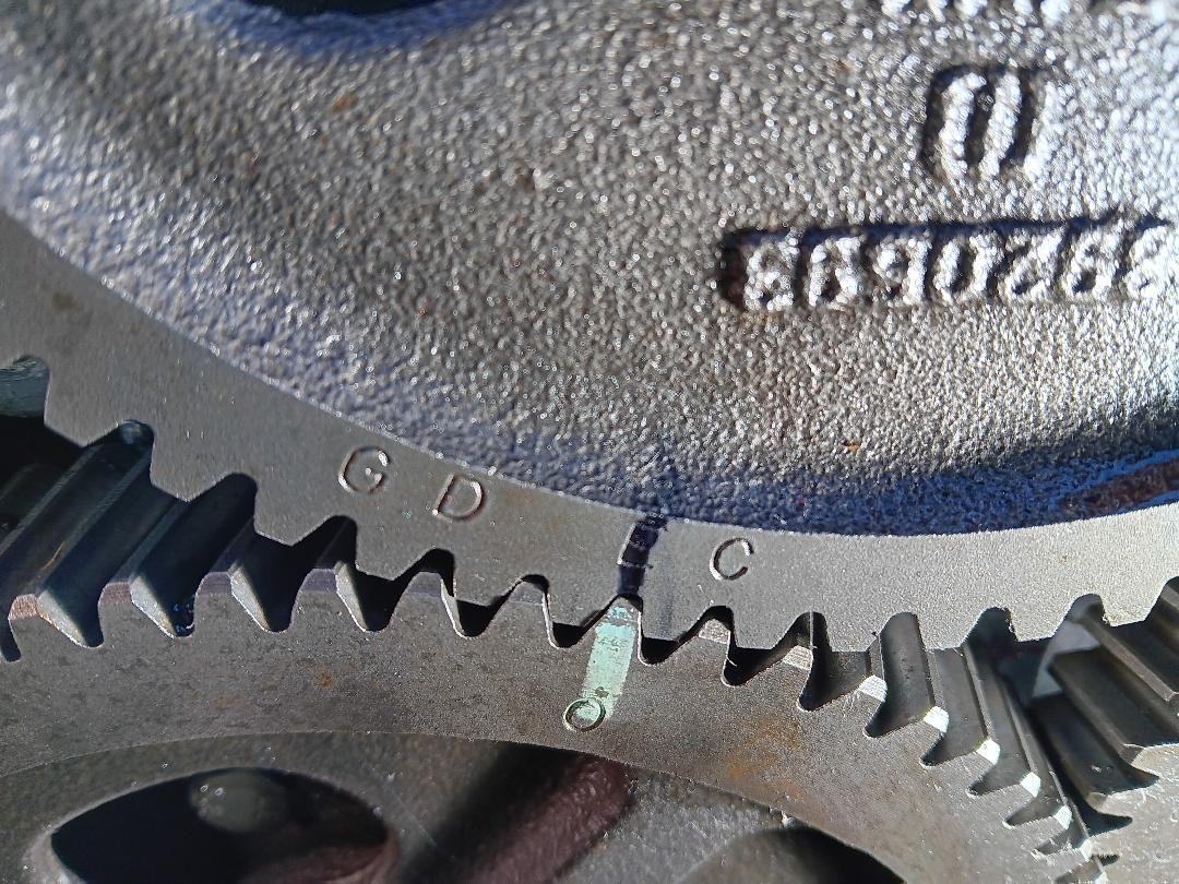

Blunders, and averted disasters. My friend put the IP gear on 5* advanced. I thought maybe THD purposely advanced the pump.No THD placed the pump in the right place. I ignored the fact that it was not advanced due to the timing marks being lined up on the pump to original spec.
I had bought a gear in a Cummins package of Ebay. 5 holes instead of 3. Supposed to be an upgrade in strength. That gear came with surface rust that I complained about. (Got to keep the gear and got all my money back.) I cleaned it with Rustoleum rust remover.
Evidently not for a 1st gen!
Probably not for a 1st gen!

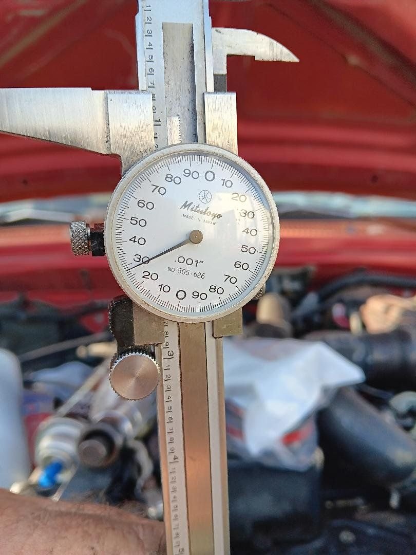

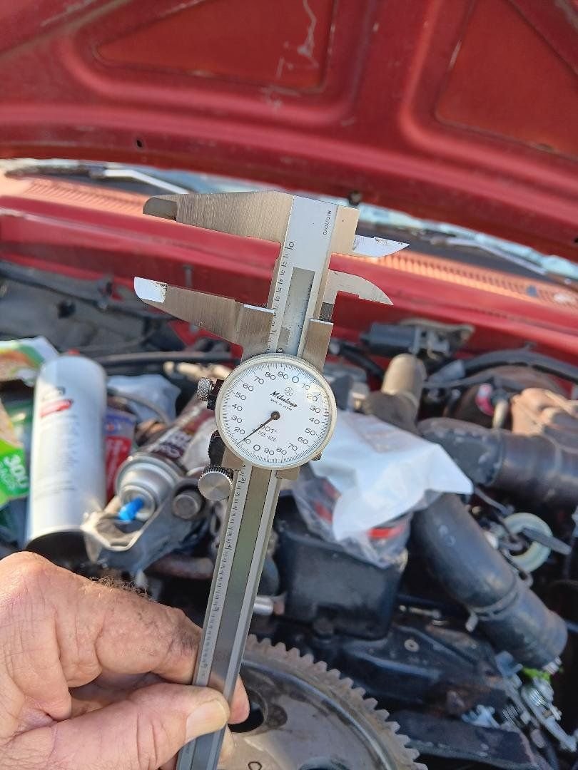

The one I ordered claimed it was for a 1st Gen. However the center is thinner. Looking how far the shaft stuck through VS the stock gear I broke out the calipers. I was right! It looked like the gear would mesh just fine. Take the chance of destroying the gears? Pass. No timing marks on the gear either
The Ebay gear thickness.
The factory gear thickness
Turned out my friend dropped the gear in 1 tooth advanced. You can't advance it without moving the input shaft. It won't drop over the key. Another observation I got was when I dropped the factory gear on properly lining up the timing marks the input shaft appeared to stick out further. I measured that to be sure. I was correct.
I loosened the set screw on the IP and rolled the shaft clockwise until it was 1 tooth advanced (?) Correct me if I am wrong.
