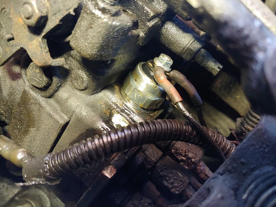

So, yesterday, I got in the truck to do a fence repair for a friend of mine (my wife), and the old brick stumbled and died after about 30 seconds of running.
The day before I noticed it stumbled a little while on the highway, but paid no attention to it because it ran fine afterwards. I guess it gave up the ghost in my own driveway.
Called Ollie, and he was laughing that I was in my own driveway, broked down. Haha. Funny, and a good thing. I tried the brassed tipped one off ebay, and it didn't work. The truck would not shut off.
Popped the hood, and noticed fuel running down the FSS. Sprayed it up, and found it leaking at the top, just under the wires where they're nutted down.
Never saw that before.
So I changed out the FSS (which seems to happen at least once a year with these chinese made pieces of crapola), bled the injectors, and she started back up.
Noticed the cracked wubber. Again, seems like once a year, no matter where I buy them from
"No mole reaky."
(in my best mandarin)
Torn rubber
Reaky sorenoid
dlippy sorenoid
Nu Sorenoid
Old brick
Fence day 1

NJTMan - you funny man! I've not heard of the FSS leaking there either. Have you tried sourcing the VW FSS? Not sure if they are any better now or not, but the last one I bought was way cheaper..
Not yet, no.
My big problem now is that the truck died again, this morning, again, in my driveway.
I started it up, let it idle, and about 30 seconds later, the stumbling, tons of smoke, and it died out. Seems to have lost it's prime again. No clue as to why / what / or where, as I just walked to my wife's SUV, and drove out of here. Luckily it's in my driveway, and not on the side of the road somewhere.

Geez Tman, how many of the gods did you pezz off??? Didn't you just have air issues a while back? And what ever happened to that "rod knock"???
