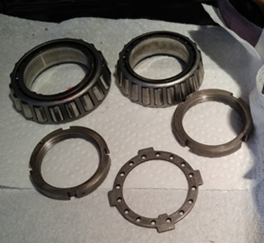

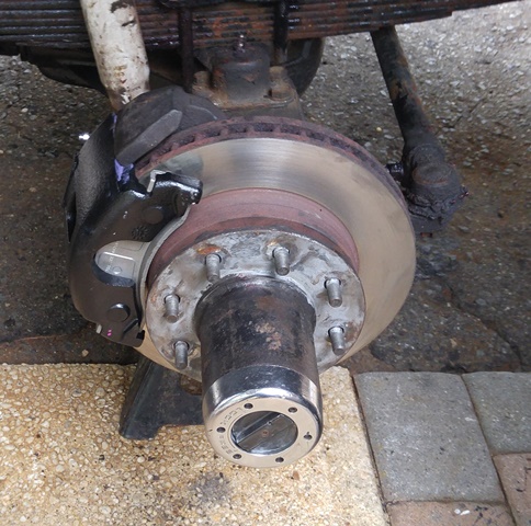

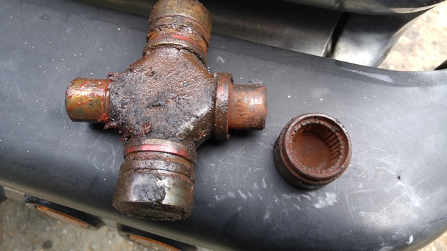

Today, I finished the brake job / axle bearing replacement on the doodge. Glad I did, as that one bearing was toast. I tried pushing a rod through the cross, but something was blocking it. I guess that's why these junk U joints are worthless.

So I cleaned the bearings first in mineral spirits, then brake cleaner. They're in good shape, as I only put them in about 4 years ago. This was the first time I "cleaned" them. Usually, I just repack them and put new seals in. Grease doesn't get very dirty, but I figured... what the hay...

New calipers and pads, after having the rotors machined. They didn't pulsate, but I figured it was time. The guy at the parts store, wasn't your normal "pimple faced kid". 25 years behind the counter, and it was very useful. He told me that a rep from Wagner showed up, and they went over issues people have with new brakes. He said the number one problem when someone resurfaces rotors is their failure to "clean them". He said that brake cleaner isn't enough. He wanted me to "wash the rotor surface with a scrub pad with dishsoap and water. Then use brake cleaner. He said this prevents metal dust from being embedded in the new pad, as it interferes with proper break in .

The new spicer U joints are far superior, quality wise, than those junkers from autozone..

Spicer Life u-joints are most definitely the way to go.
Originally Posted by MrFusion
I only use Autozone or Advance (or Napa anymore) on stuff I'm getting rid of or if I need it that day. I bought MOOG joints for my front driveshaft. They're supposed to be made in the USA. The quality seems pretty decent. I won't know til I run them.
From now on, I'm only using spicer. It was amazing the quality difference in the unit, vs the ones I've used in the past.
BTW.... if anyone cares to know..
Put the bearings in the rotor / hub, with the new seal. Install the first (inner) nut on the spindle and tighten it to 50 Ft lbs. Spin the rotor a few times to push the grease around.
Back the nut off, and re tighten to 39 Ft lbs. Take your torque wrench, and spin the nut loose 135* from that point. This sets the proper freeplay of the bearings.
Install the locking ring to the nearest hole. I usually move it to the closest hole that makes the internal nut a smidge tighter, as the pin never meets the hole the first time installed.
Install the outer nut and tighten it to 160 ft lbs or so. This locks the two nuts to the alignment locking ring. This completes the install of the bearings.
