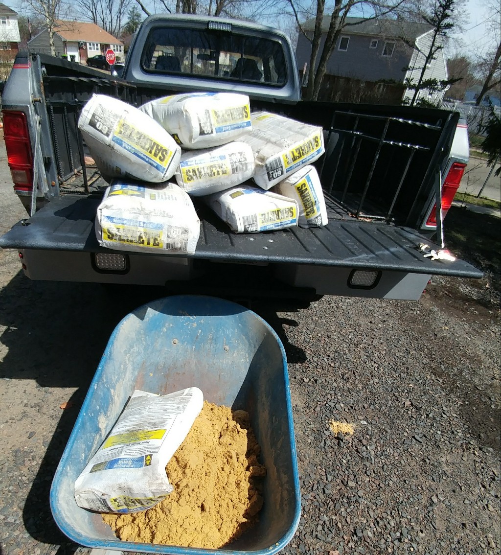

  #6015
Posts: 6,837
Today, I put the plow in storage, emptied and removed my weight baskets, and dumped 480 lbs of sand into the dogs pen. Now the truck rides like a bucking bronco again.
Lol
Glad to see winter leave us.
