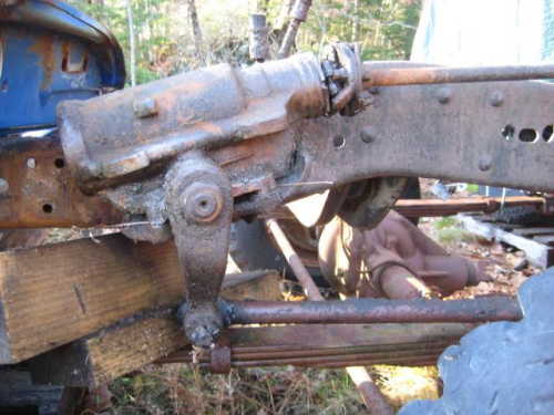

Reverse rotation steering is from W series from W300 down from 1972-1976ish

It is Reverse rotation steering that was used on certain older dodge trucks that doesn't put the strain of steering on the steering box mount because it moves the rotation from side to side to front to back. I am not an expert on it and that is a simplified explanation, because it came from my simple mind. They were a pretty good band also ...Mark

Ahh, more like what you see on big rigs. Now I finally get it. Thanks.
And thanks to Maybe, also. I bet this helps with the cracked frame at the steering box location too.

Yeah much better than the three leged plate. It changes the forces from pulling and pushing the vertical to rotational. It also improves handling.

That's specifically the reason why I chose to replace my existing steering to the older "RR" style. By eliminating that adapter plate, that cracks, and has been DISCONTINUED, I have the older / less susceptible to breakage system which should have never been changed.
Originally, it was changed to allow a better turning radius as the tire doesn't hit the draglink as you make a hard right hand turn, but then they realized that instead of having a "4x4" steering gear and a "2x4" steering gear listed and having to be produced, they could use one box for both designs. Penny pinching (IMO) was the primary factor. Terry Elders confirmed this over at cummins forum.
I would NEVER go back to the conventional / steering plate setup again.
And I don't ever have to...
