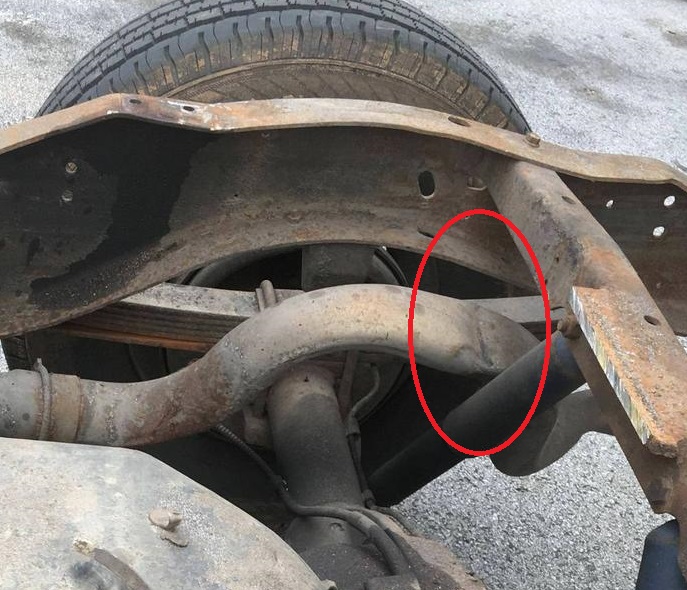

Your exhaust system is kinked. I can't imagine it runs very well with the exhaust closed off like that.

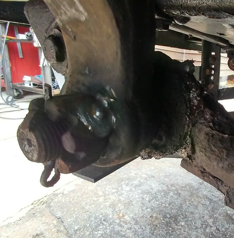

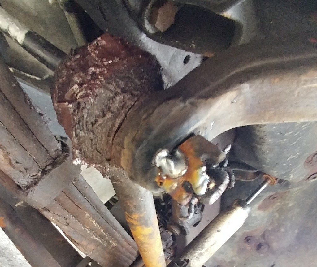

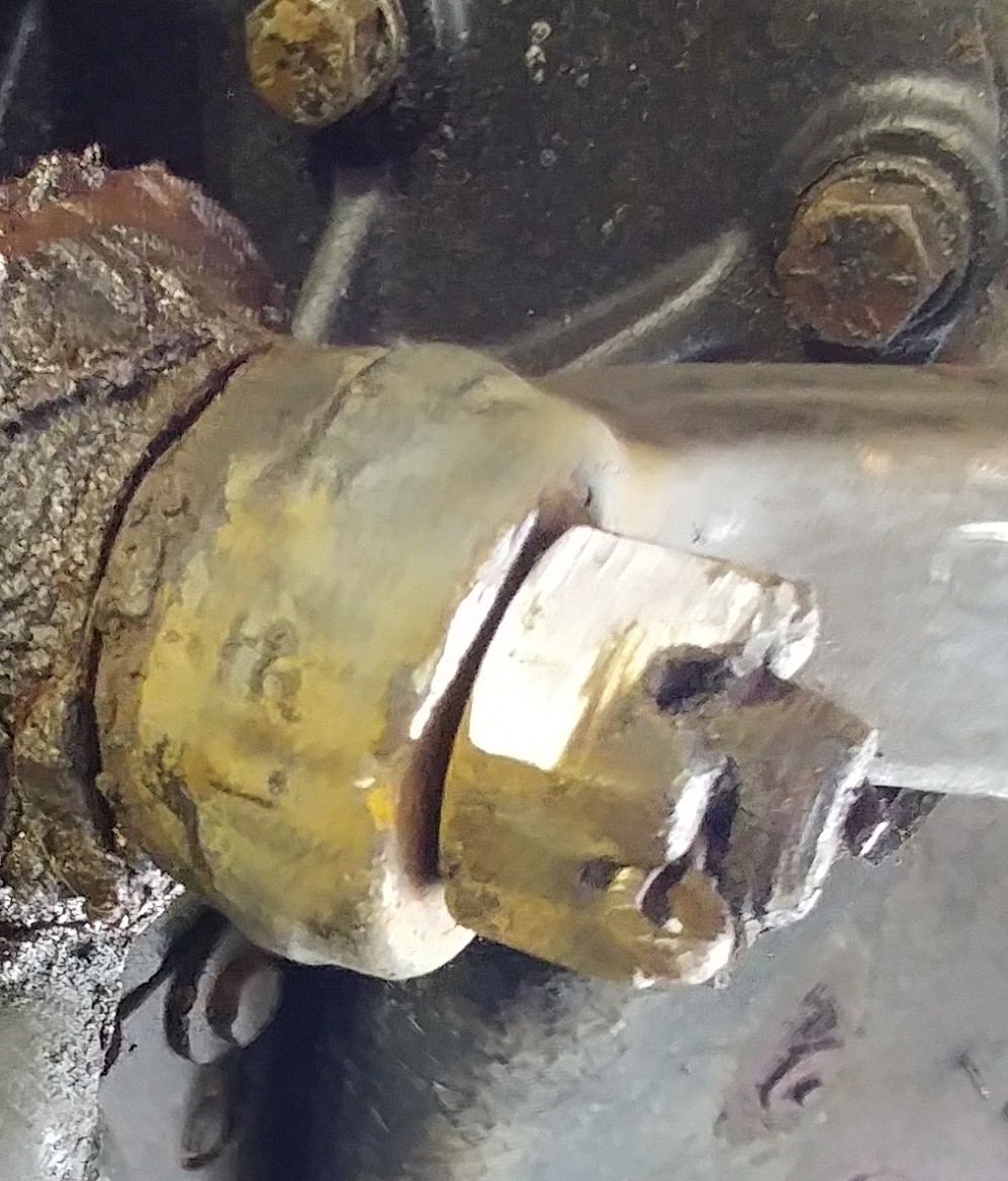

So I did my RR steering many moons ago, and haven't had much issue other than a slight leak in the gear itself, until recently.
I've been hearing a clunk in the front end,and today, the day of a Nor Easter heading in, I realized the drag link was going bad and the noise was the link moving about in the pitman arm end.
Well, after frantically calling every local auto parts store, and getting " its in Tennessee," or "factory order only" which means they have to make it from scratch.
Ugh. What's a boy to do?
Break out the welder.
Took a big "C" clamp, and compressed the loose pin into the Pitman arm end, where it is supposed to be. Discovered the nut moved 1/32 to 1/16 of an inch outwards. Cleaned up the metal, and flooded weld onto the crown nut, and into this gap that shouldn't be there. Welded the nut to the tapered pin end, so it can't come off while plowing snow today and tomorrow.
Ill cut that nut right off, clean up the minimal spillage that the pitman arm received, and when I get a new drag link, ill be back at new.
No more clunk. What a pain not having these parts available. Ill be ordering an extra one to have in stock for the next failure.
Attached Thumbnails What did you do to your Gen 1 today?-0312181440_hdr-1-768x781.jpg   What did you do to your Gen 1 today?-0312181441a-1-1024x863.jpg   What did you do to your Gen 1 today?-0312181428-1.jpg
Good eye! The cobbled-up exhaust was also damaged in the accident that hit every panel on the passenger side, definitely on my list of stuff to fix!
