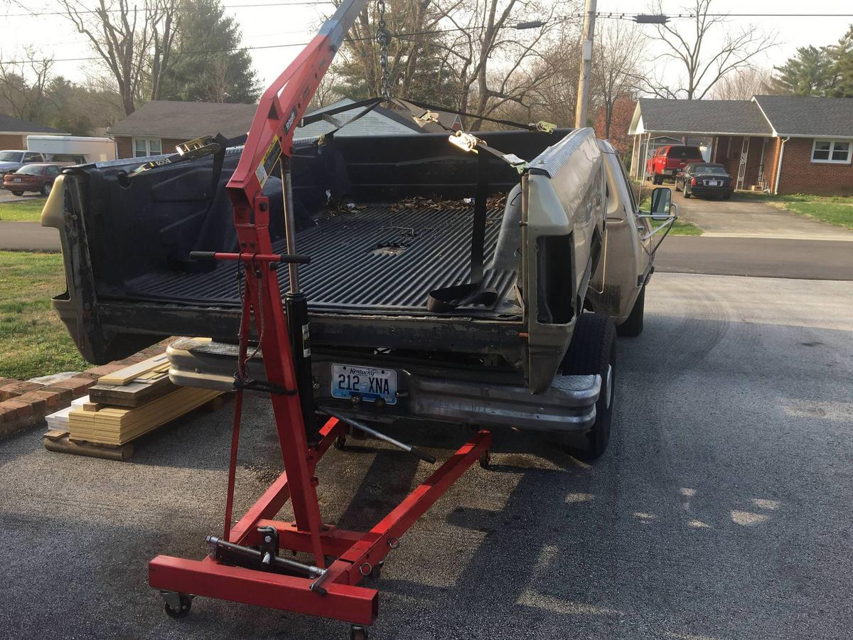

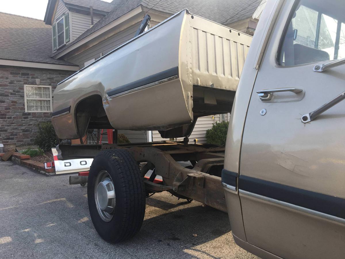

Today I swapped the bed from the black parts truck to the '92 D250.
A cherry picker seemed to work really well to pick up the bed, but it could use a slightly longer arm insert to increase the reach. Another 6-8 inches would've made the job go a lot faster...

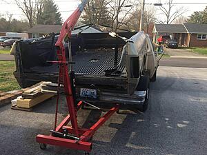

I was happy with how easy it was to move, it actually rolled around much easier than when loaded with an engine.

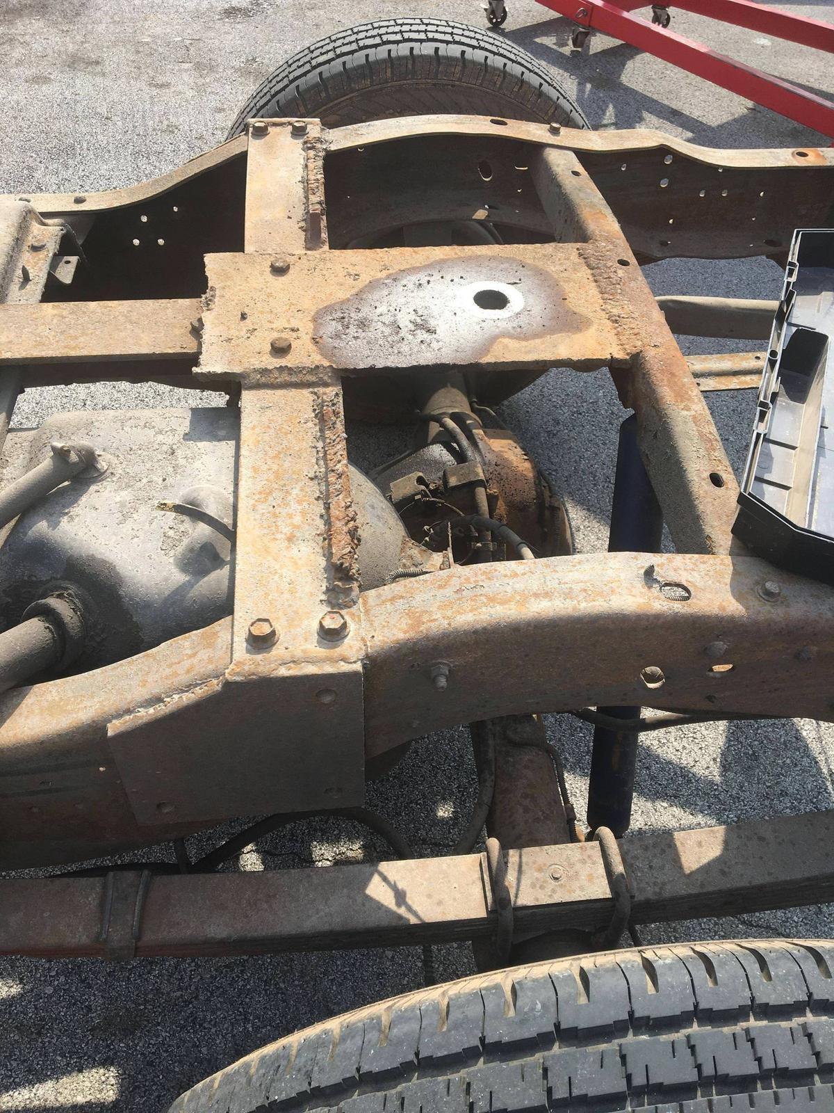

People who buy welders should be subjected to an I.Q. test!
This was a previous owner's attempt to fabricate a ball hitch mount in the bed.... :tsk:

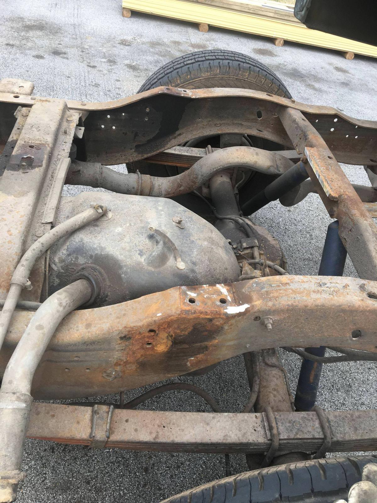

That mess took about 2 hours to remove without damaging the frame, brake lines, wiring, fuel tank, etc. - but I was able to remove everything except some leftover steel plate welded along the length of one of the crossmembers.
When you use a 1/2 ton bed on a 3/4 or 1-ton you need to remove these little spacers for clearance, there are 2 on each side. The heavier trucks have a slightly taller frame in these areas. A Sawzall made pretty quick work of them...

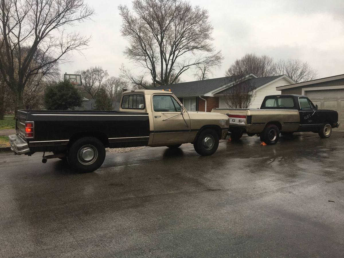

Bed swap is complete! Next come the doors and fenders!

cool! another multi colored truck on the site! wish my bed was that rust free...even with the dents.

That hitch was better than mine. Mine had 4 L brackets welded downhill with 6013. 3 of the 4 brackets I knocked off with 2 whacks of a 2lb hammer.

I thought the pivot point should be a bit further forward for stability.
