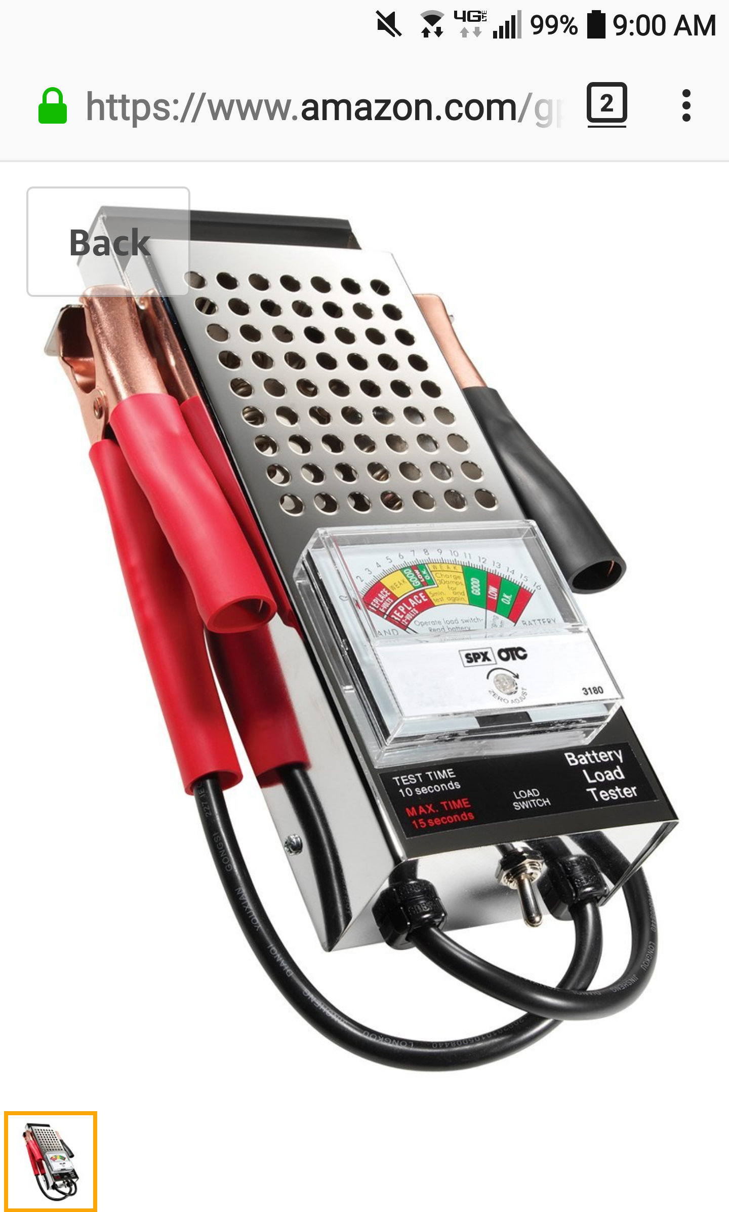

When I worked as a wrench, 30 plus years ago, we had this tester, which would not only tell us the condition of the battery, but also the charging system. I know you have your digital meter inside the cab now, but I would like to see this on the battery, before you start it, and during the initial morning start up. See what is happening, at the battery cables during start up and the first minute or two. See if its corresponding to what you see at the meter in the cab.
Really crazy how things have Changed, over the years. That tool was several hundred dollars, back in the day, and now its less than a case of beer to own one...
