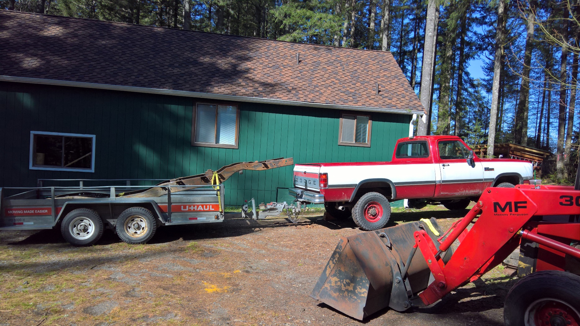

Picked up my 92 W250 frame from frame shop today. She is all dialed-in and within factory specs. Next step is to blast, prime and paint her.
Also, ordered rear spring hangers and shackles from ATS Springs and have a message into JungleJim for his front spring HD frame bushing kits (Shackle end).
