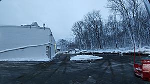

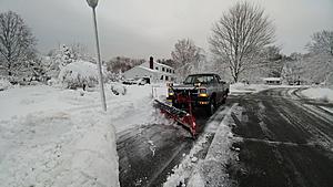

So, I spent about 13 or so hours in the brick, plowing lots, driveways, and avoiding suicidal deer in the middle of the night that for some reason head right out in front of my truck while I'm driving around. The plow would make deer burgers out of them, I'm sure, but I really don't want to find out.
So, I'm into the plowing thing for about 10 minutes, and I'm backing up, and I stop to look at some dude parked in front of the building I'm plowing. He's an employee, and either he's back stealing from the place, or he's a good Samaritan delivering goods to some needy family in a bad area of town. Either way, I completely forgot about him, cause I smelled something BURNING !

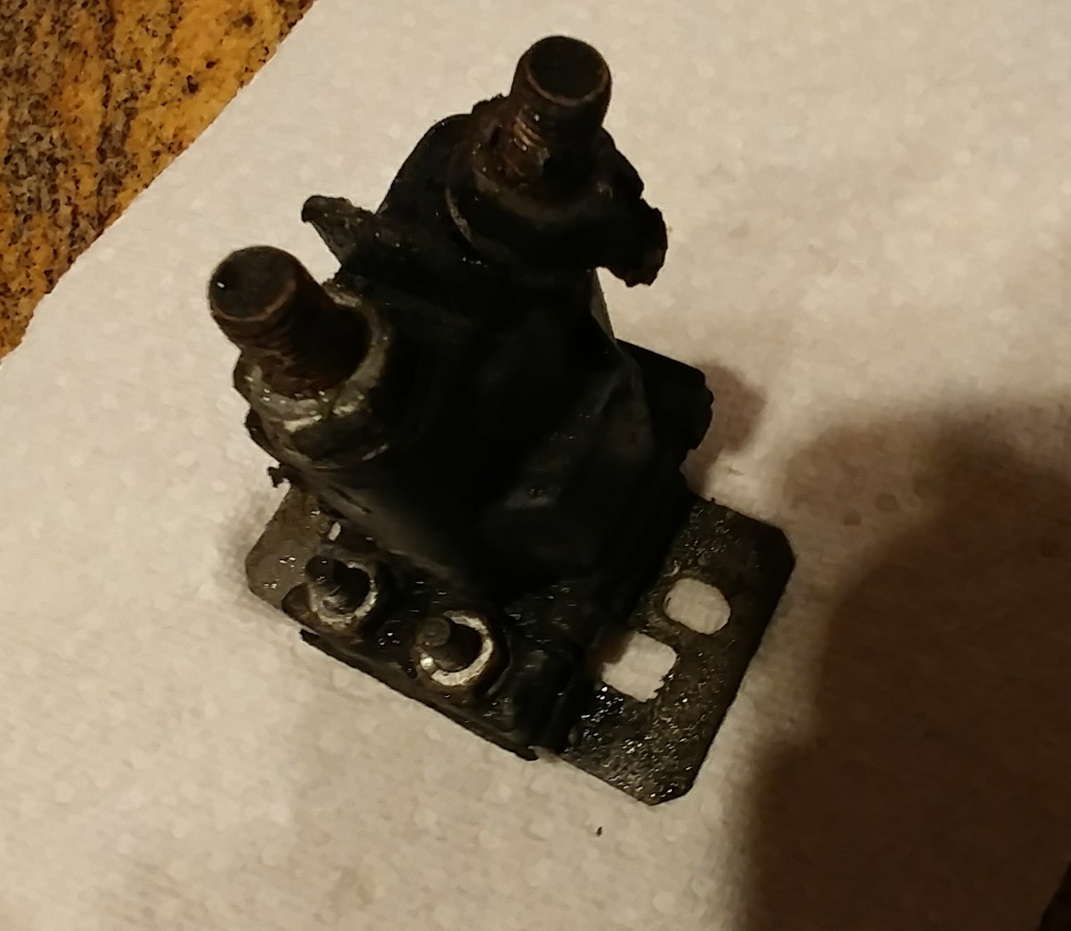

I turn the truck off, and my plow motor is running. Pull the controller off in the cab, and it's still running. pop the hood, and I gots me a FIRE just about going on. Smoke billowing out of the fenderwell. My Plow solenoid is stuck ON !
Well, dumb monkey never put a fuse in there preventing overload, and luckily I was able to pull the battery cable off and stop the plow from turning my truck into a towable junkpile up to Ollie in VT.
Note to self: new solenoid every couple years, and put fuses in there to prevent forest fires.
No idea what that guy was stealing, because I head back home as fast as possible. Luckily there was no damage, other than the solenoid.

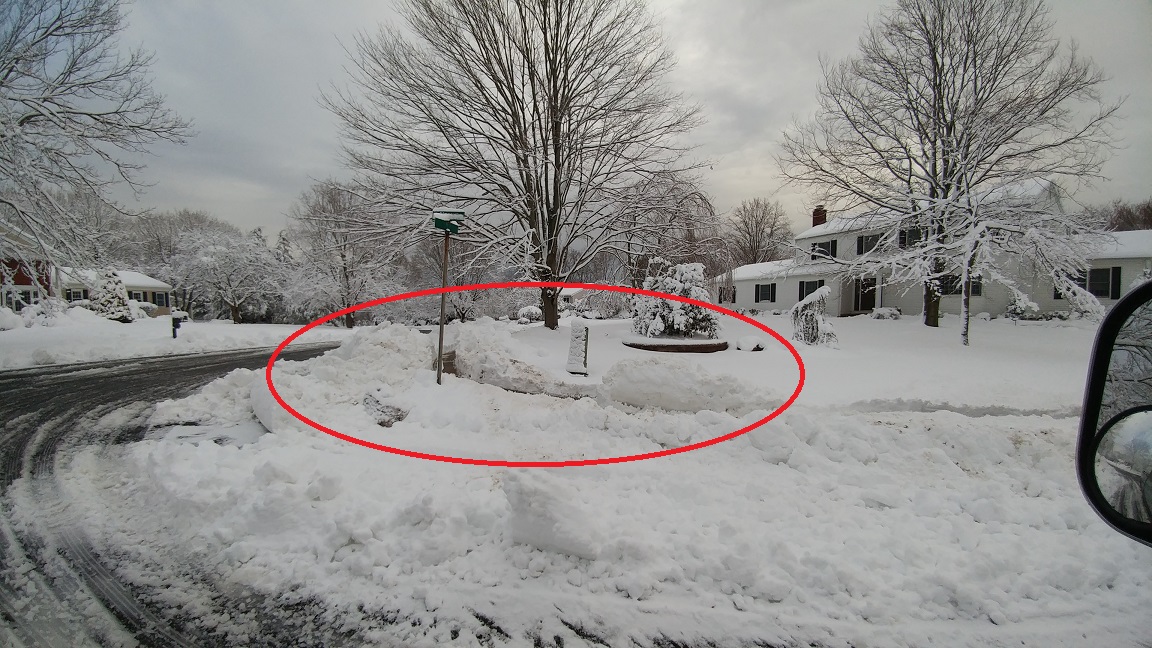

Some township guys should be shot. They blasted this guys property (which I have to clear the walkways), and nearly ripped out the telephone service box just behind it. They plowed the snow into his property nearly 6 feet. A foot to the left, and that phone box was toast.
Idiots. I had to hand shovel through that mess at the corner, as the snow blower was too short.

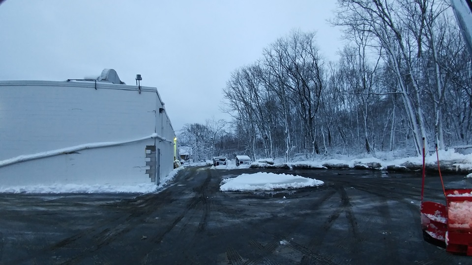

The pile of snow in the middle of the lot is covering a 1.5' deep hole that I will not drive through ever again. Until it's fixed, which most likely will never happen, they live with a pile of snow covering a hole deep enough to swallow a small car..

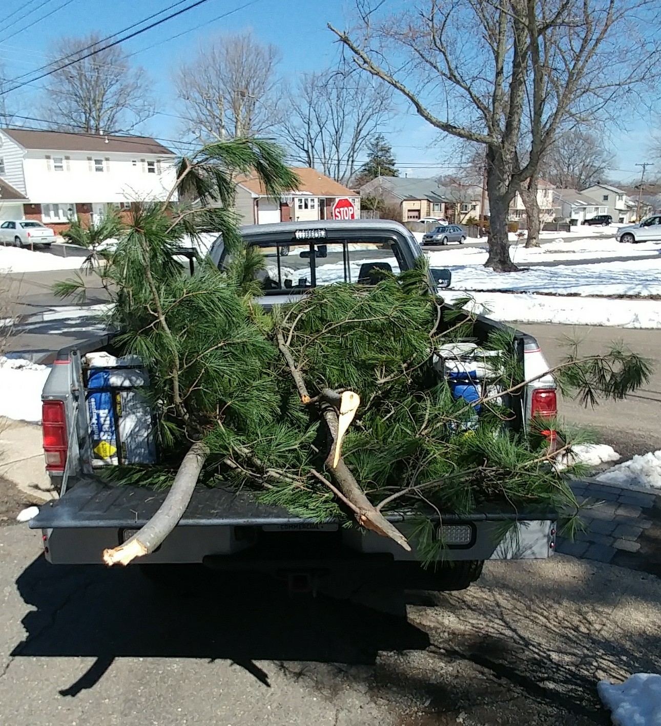

Used it like a truck
