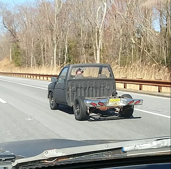

Saw this on the road today. Pulled the guy over , and offered him a square trade. My 92 1st gen. He said no way, as his ride was way more valuable. He went on his way.
Yeah... I guess he was right.
Lol
Lol
Man, what a sweet ride.
