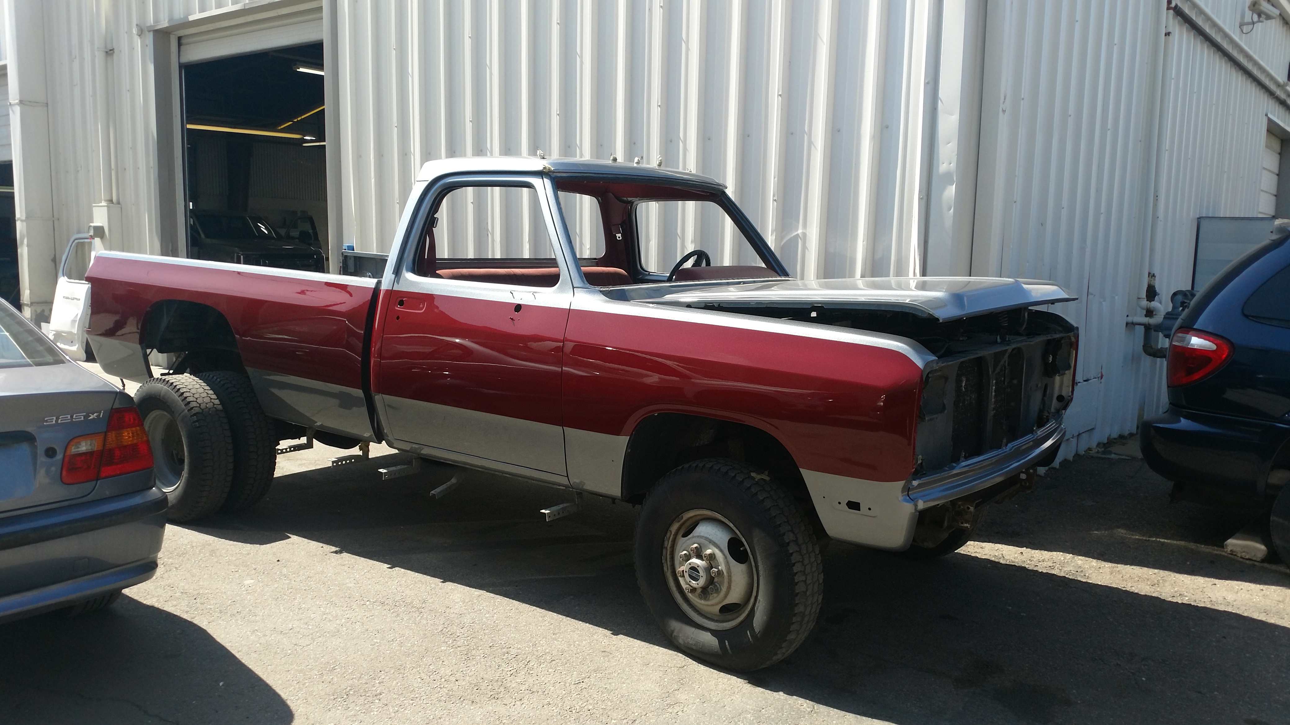

I've been absent for a couple years now.... but for a good reason!! Finally got my old girl painted and am in the process of putting it back together! Can't wait!!!
Attached Thumbnails What did you do to your Gen 1 today?-fb_img_1503705772100.jpg   What did you do to your Gen 1 today?-img_20180326_124040662.jpg
Truck’s looking beautiful. Great color combo!
