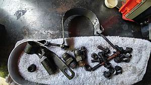

Small parts in rust converter

After

What is this rust converter home brew stuff you use?

Phosphoric acid.
Available under many different names and product uses.
Paint stores usually carry this.
Amazon Amazon
Eats the rust off of metal, while leaving the original metal untouched, coating the surface with a non conductive coating which then can be primed and painted over
https://en.wikipedia.org/wiki/Rust_converter
