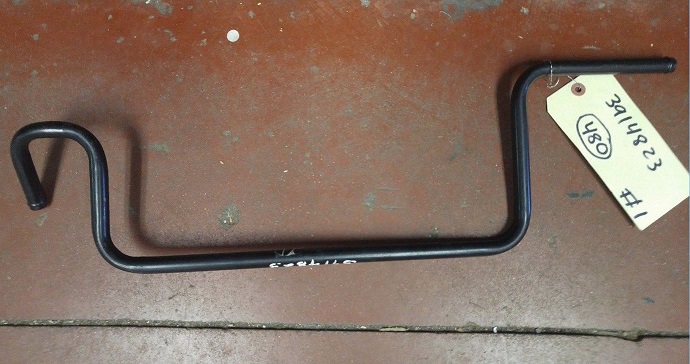

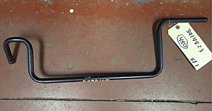

Got an email today telling me that the cummins coolant tube I ordered is on it's way here, by friday, supposedly...
Cummins #3914823
Ebay # 142183562051
We shall see, eh ?
