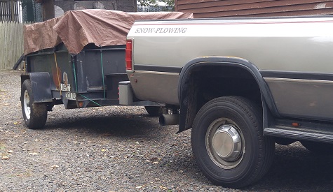

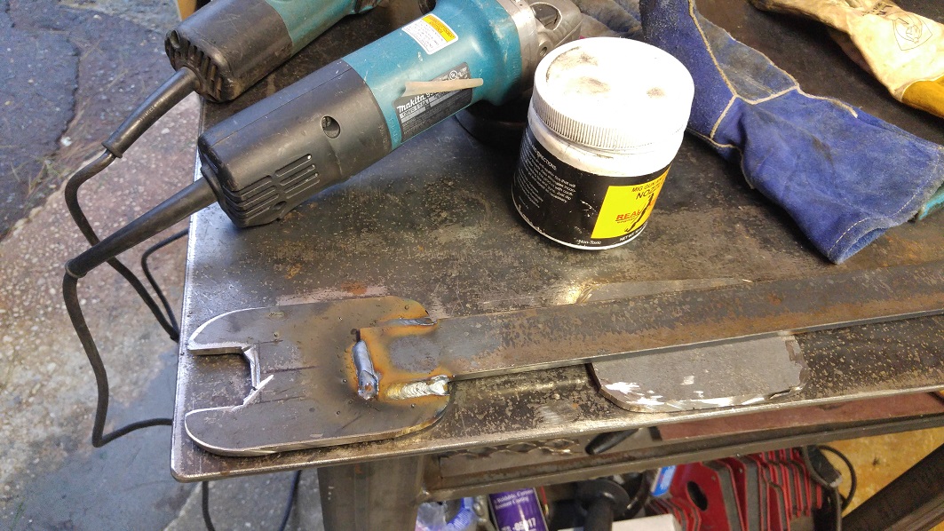

Today was somewhat productive, albeit a bit rainy....

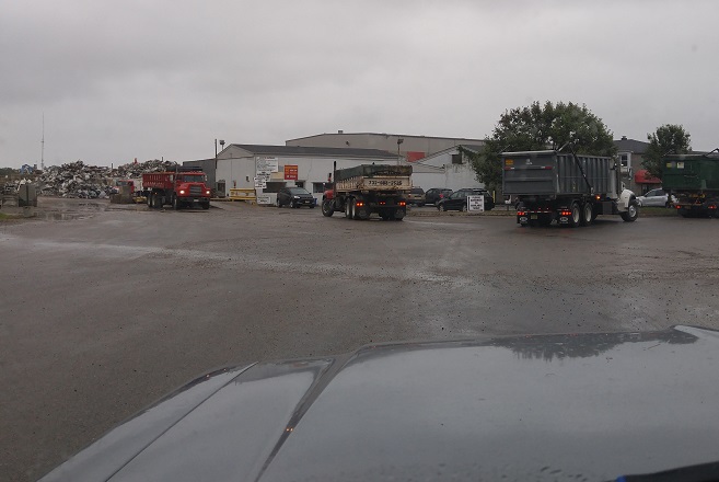

Took trash to the dump

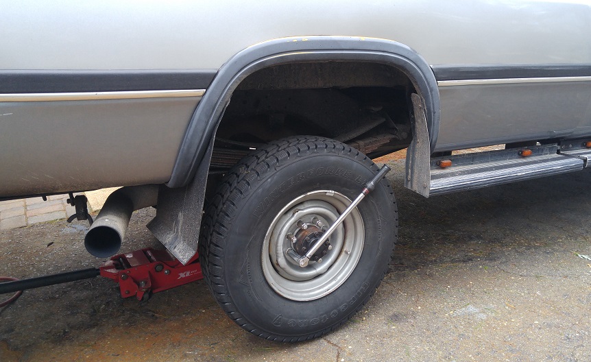

Adjusted rear brakes
Installed winter tires
greased the front prop shaft and steering / kingpin assemblies

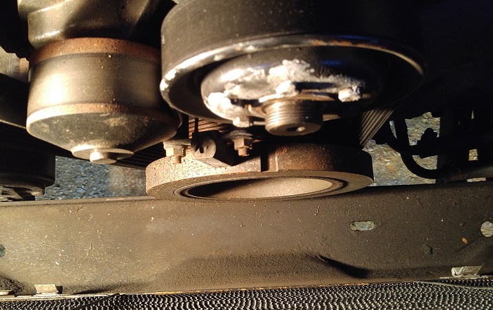

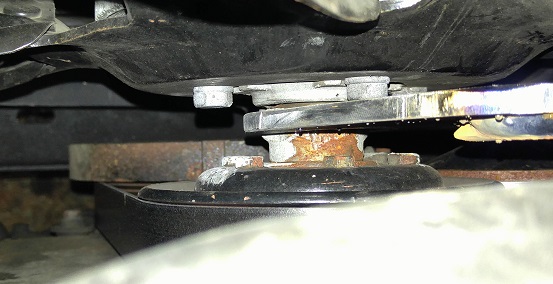

Then came the fabricating....

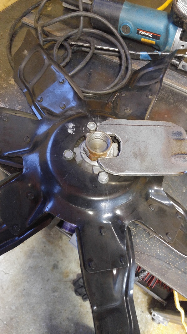

Made myself a "fan clutch" tool.
Used it to remove the fan and shroud, but then I couldn't get the bolts off the harmonic balancer. I ordered a High Torque ratchet to see if that will work, otherwise, I have to pull the radiator out, which is what I'm trying to avoid......
Oh well.... there's always tomorrow.
Attached Thumbnails What did you do to your Gen 1 today?-0929161113.jpg   What did you do to your Gen 1 today?-0929161147.jpg   What did you do to your Gen 1 today?-0929161435.jpg   What did you do to your Gen 1 today?-0929161813.jpg   What did you do to your Gen 1 today?-0929161822.jpg
I have got to make a fan clutch wrench too.
Another option is to use a small hand-sledge hammer and chisel on a corner of the nut. usually you have to hold the pully somehow as well if you plan on using non-impact torque. You'll replace the fan clutch and nut before it gets buggered up enough to be compromised in any way, no matter how many times you need to remove it. IIRC, the nut is a 33mm.
Others have used an air hammer with chisel.
I just ground the open end side of a cheap wrench. Ground the size off the side too
I've used the air chisel in the past on an old clutch fan replaced years ago. I started this task by using the air chisel, but it was damaging the 1 7/16 (33mm) nut . That's when I took out a set of calipers and began fabbing up ..

Ha! That just made my day. Nice wrench...id recommend painting it some neon color, so you don't lose it before you need it again later down the road.
