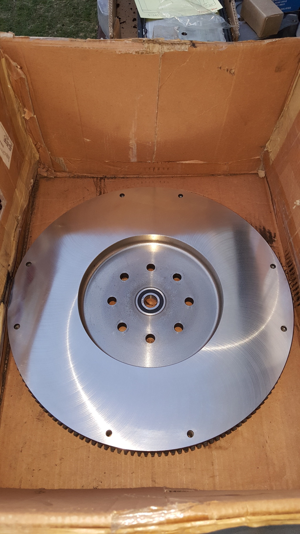

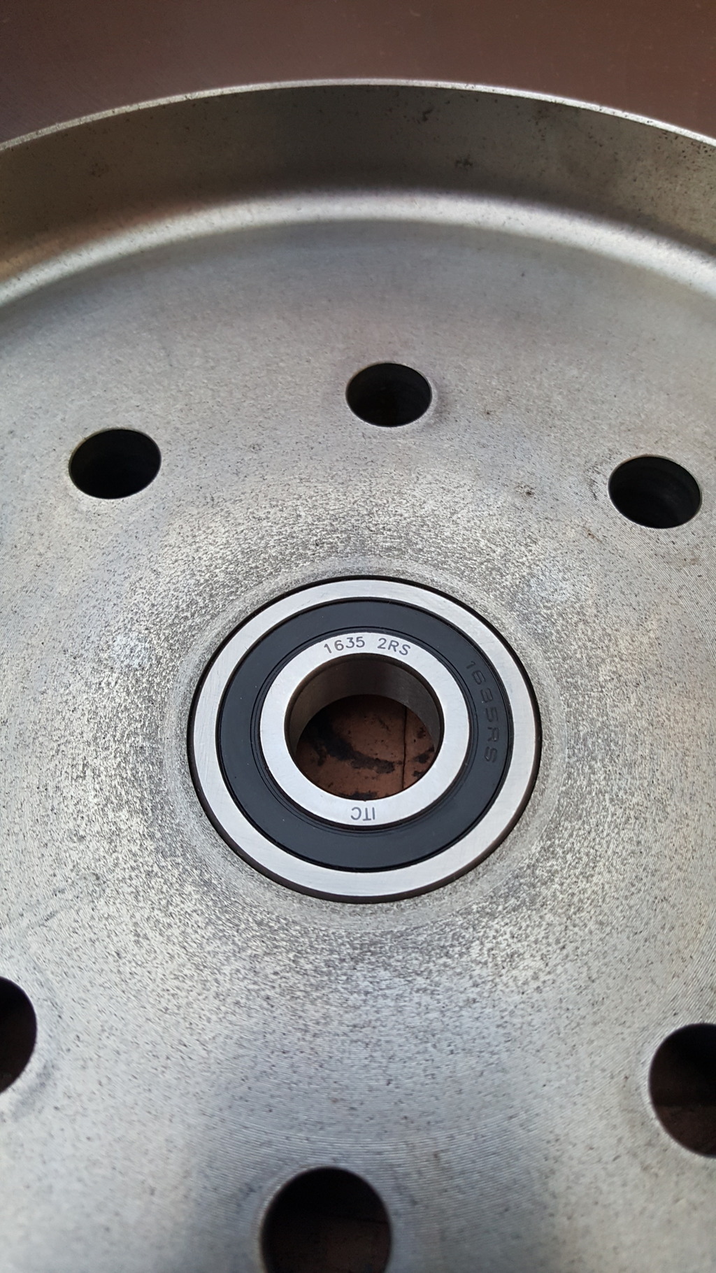

Friday I had my South Bend flywheel surfaced. Machine shop said they ground off somewhere around .015" of material to get it true. I also sourced a new sealed roller pilot bearing and tapped it into place.

A brand new flyweel had to be cut ?
Where was it manufactured, if I may ask ?

No, not new. I should've specified that. I installed this flywheel and clutch back in 2010. Bought the Con OFE kit. The flywheel was worn where the clutch disc makes contact. Normal wear from what South Bend told me. Nothing to be concerned about. A surface grind until it's true is all it needed.
That sumb!tch is heavy!

Sure is. Floor jack and a couple of guide pins to mount it. BTDT

I planned on buying a couple of studs (or bolts with their heads cut off) to hang it from while I get the bolts started.

I use a floor jack to take the weight then "fine tune" locate it by hand.

I had my cousin help me and used a couple bolts with the heads cut off as guide pins. Worked slick!
