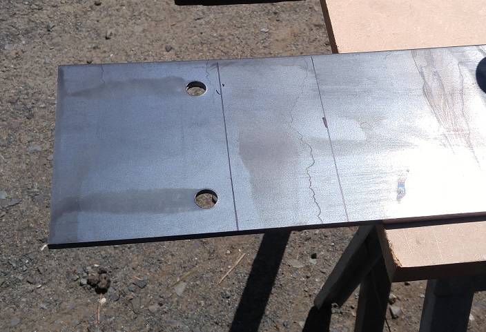

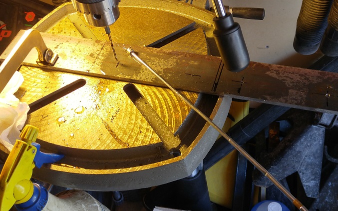

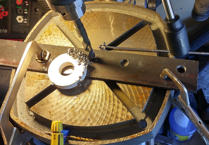

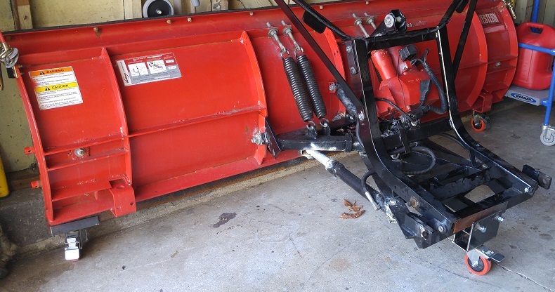

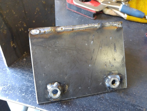

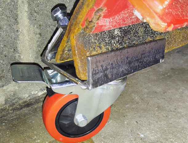

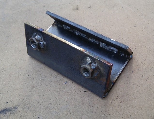

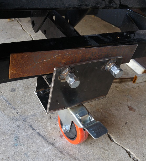

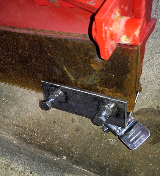

Put my snow plow away (again), and this time, I broke the furniture dolly I used for rolling it around in the storage unit. I can't move the 550 lb beast around without wheels, so I made up my own.
These bolt right on to the plow, and now I don't have to worry about breaking a wood dolly anymore .....
Fun...

Good looking work T-man!
I like the bolts that tighten down on it so it can't slide around.

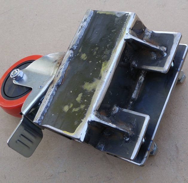

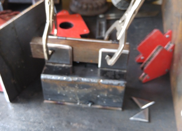

Finished my quest for custom dollies for my brick's plow..
Unfortunately, or fortunately depending on how you look at it, it moves so easy, it can unsuspectingly roll away on you if you unlock all the casters, and are parked on a hill (which this storage unit is)..
This one was more difficult, and took a few hours to make, as the placement of it required some "extra" thinning..... of the mush pile between the ears.
Fun, either way...and I get a little better at welding each time. With practice, I'm sure I'll be okay at it in a few years.
