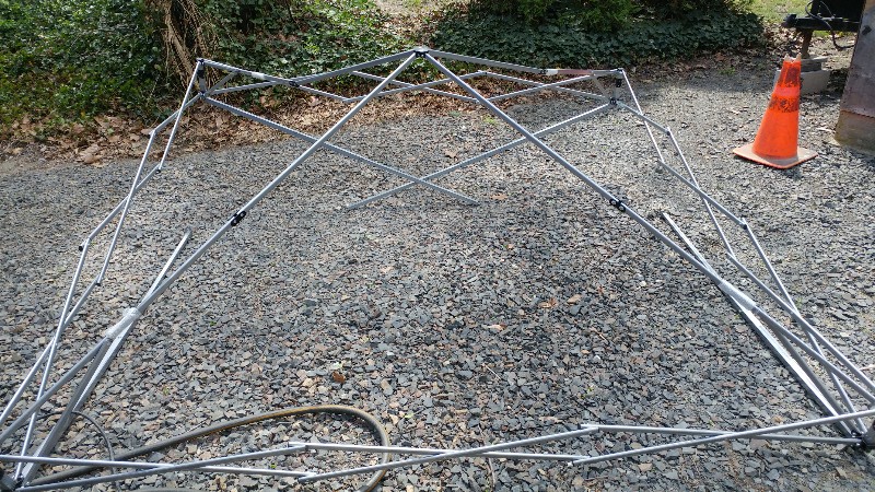

Today I used the brick to transport a broken window to the window shop. Mother nature poked me with her screw you stick , as I had my 10 x 10 pop up canopy fly through my second story bedroom window just for ha ha"s. Gusts were pretty good around here, and I guess ill be ordering a new canopy as that one that tried to get in my house broke its legs on the way back down to earth with the help of its peeved former user....

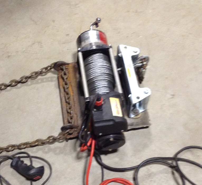

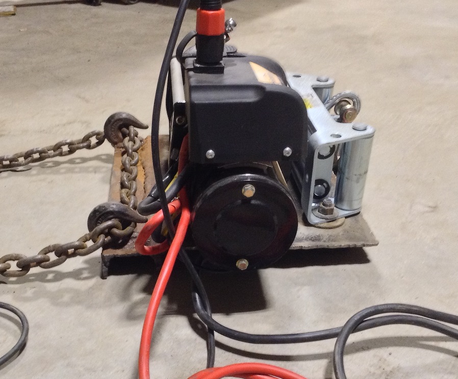

For those about to rock....
or get pulled from a ditch. Which ever you prefer...
Ollies Winch gizmo. Very inventive, flexible and ingenious way of doing a winch... someday, of which I will replicate myself.
Not sure if Ollie invented it, or just copy and pasted it. Either way, I think it's cool...

I saw a much cheesier version of a winch plate in my Northern Tools catalog and the light bulb over my head lit up. From there it was just beer engineering after dinner one night. I torched some scrap metal out of an old flat bed head ache rack. Then I torched some welded on hooks off the same bed and welded those on the back of my plate. I then drilled the needed holes on the plate and used 2nd gen cab mounts as rubber feet. The winch was a cheap winch rated at 9000# I bought years back from Northern Tools for under $300. Other than the beer, the welding wire /Argon and OXY/ACT gas it was just using things around the shop. I have used it for all sorts of goofy stuff since I made it. It is very convenient to be able to use it on the front / back of any truck or chained to the front of my trailer too drag stuff on with.
It is easier to loan out to a friend in need than your truck with the winch permanently attached to it.

"Beer engineering".. Like it!!
