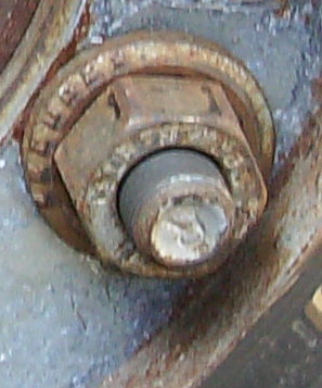

Did some more research and it seems my front lug nuts are not original stock nuts. They are Securex MF39946 units. They have been on the truck since I got it. I have not found an online source for them.
In the attached pic you can just barely make out "SECUREX" forged into the washer.
