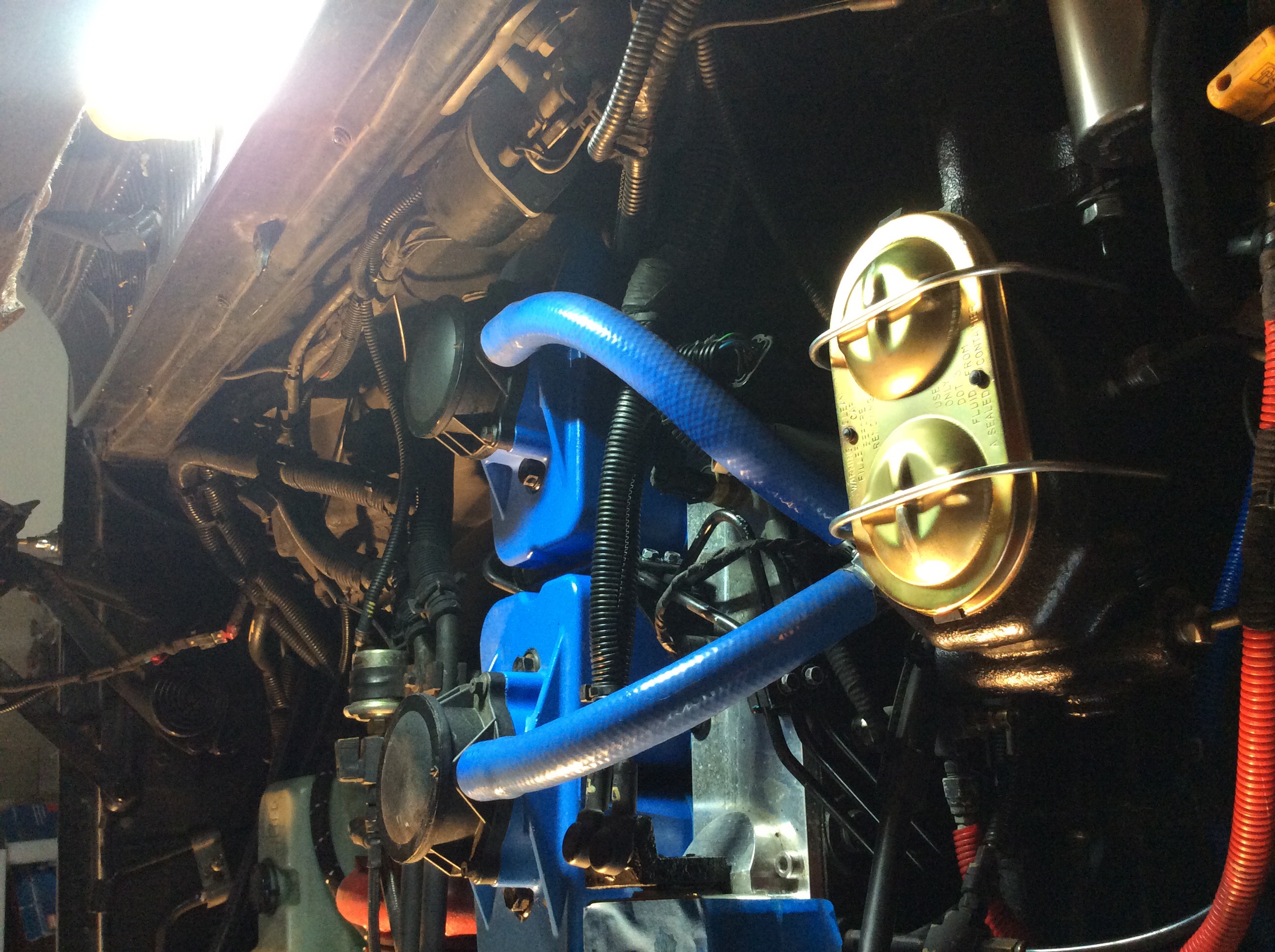

At a standstill with the Hydroboost conversion project till the filter comes in, and used the time available by finally installing the second dual valve cover set that I had. Didn't think I'd use it, cause I couldn't source an actual "wye" fitting with 3/4" end connections. didnt like the looks of a tee fitting. Found one finally, so tied them all in

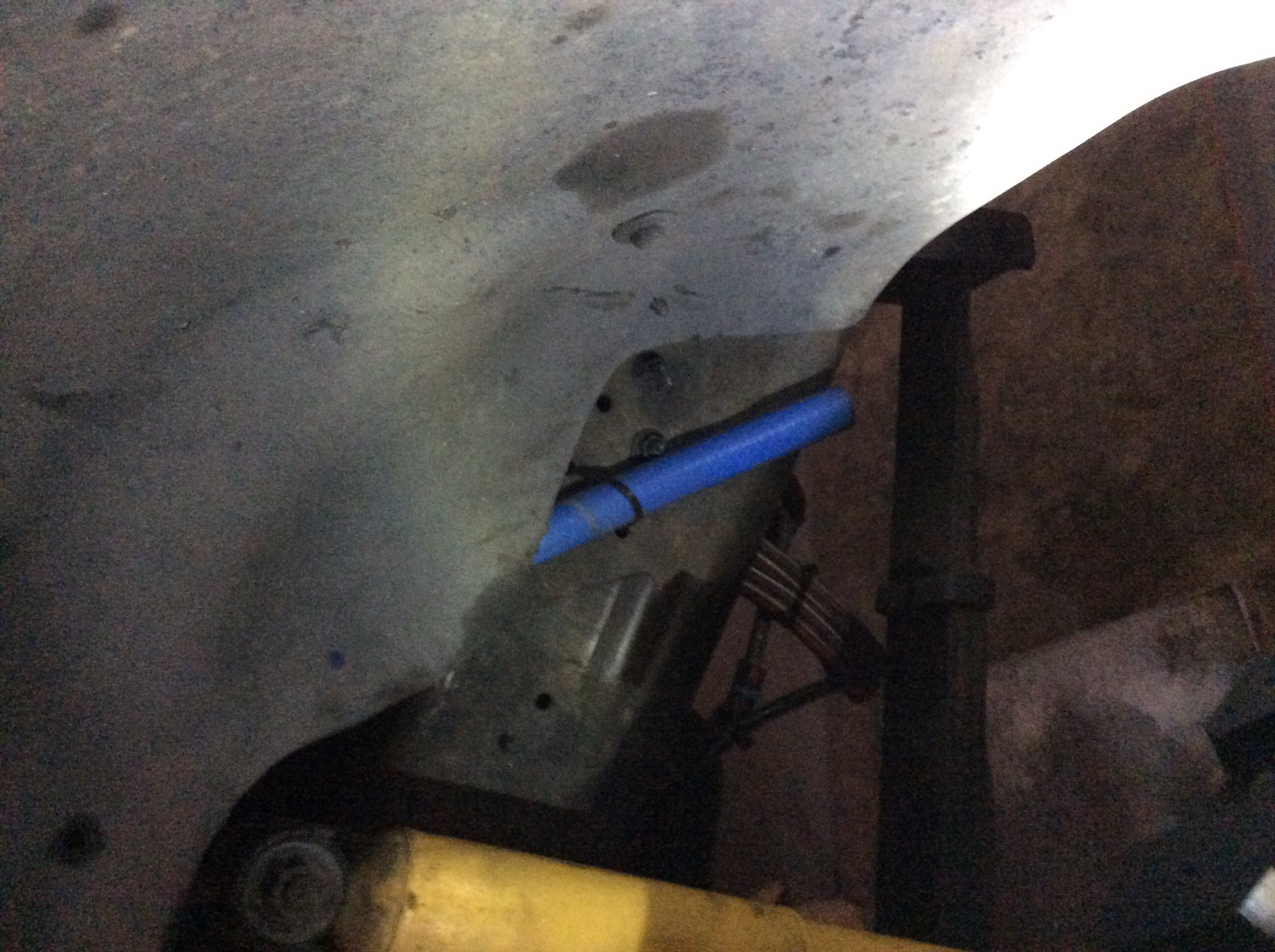

The 3/4" silicone tubing terminates nicely at the wheel well, outside of the frame.

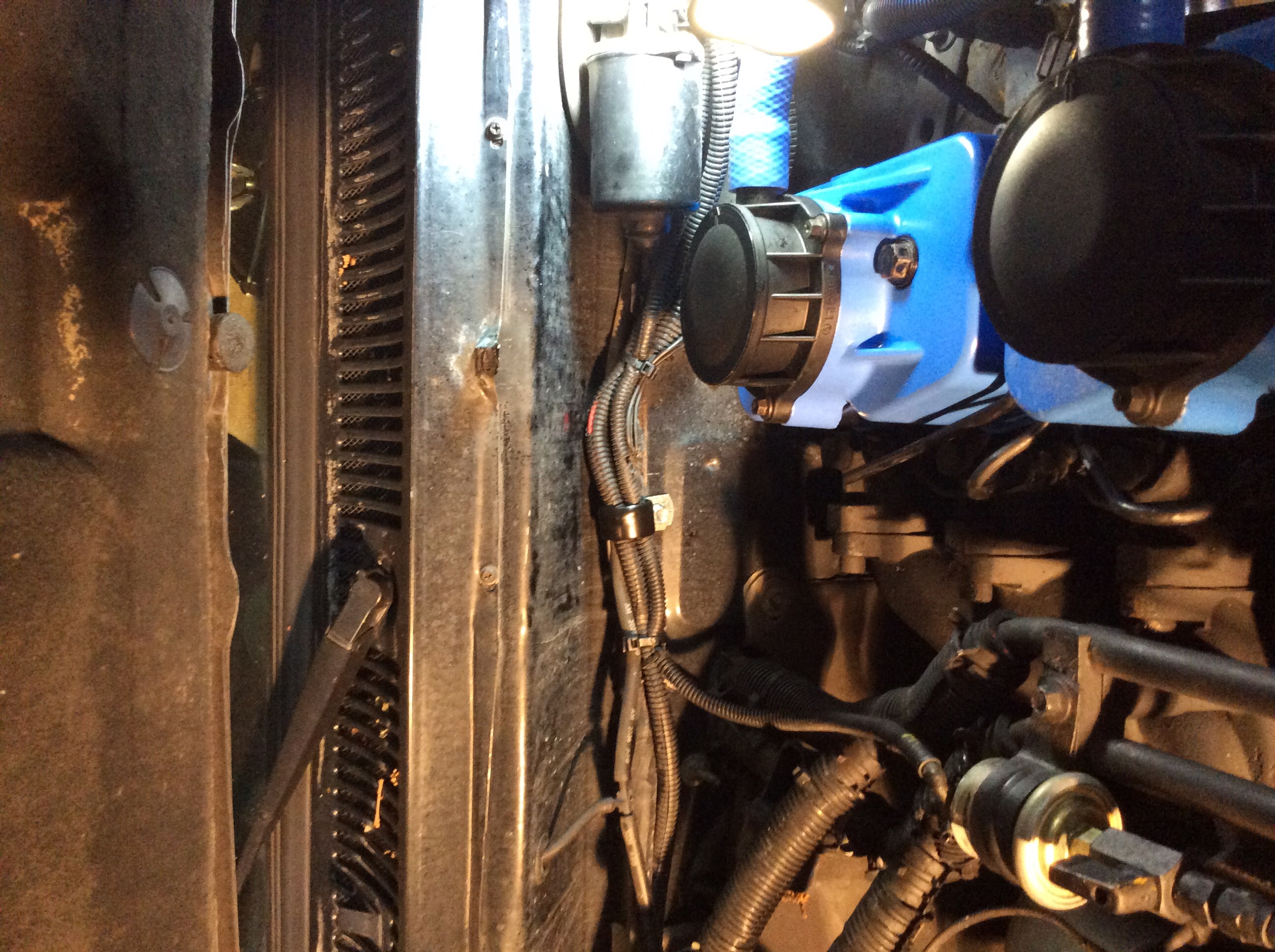

Never really cared for how the factory wiring looms, vac lines and washer fluid tubing was attached to the firewall with those chintzy clips. I'm sure it looked great back in the day when new. This has been bugging me for years, as some of the vac lines and such were too close to hot parts. Decided to clean it up some today. Nothing fancy, just a couple of zip ties, and a 1" rubber coated clamp from Orileys.

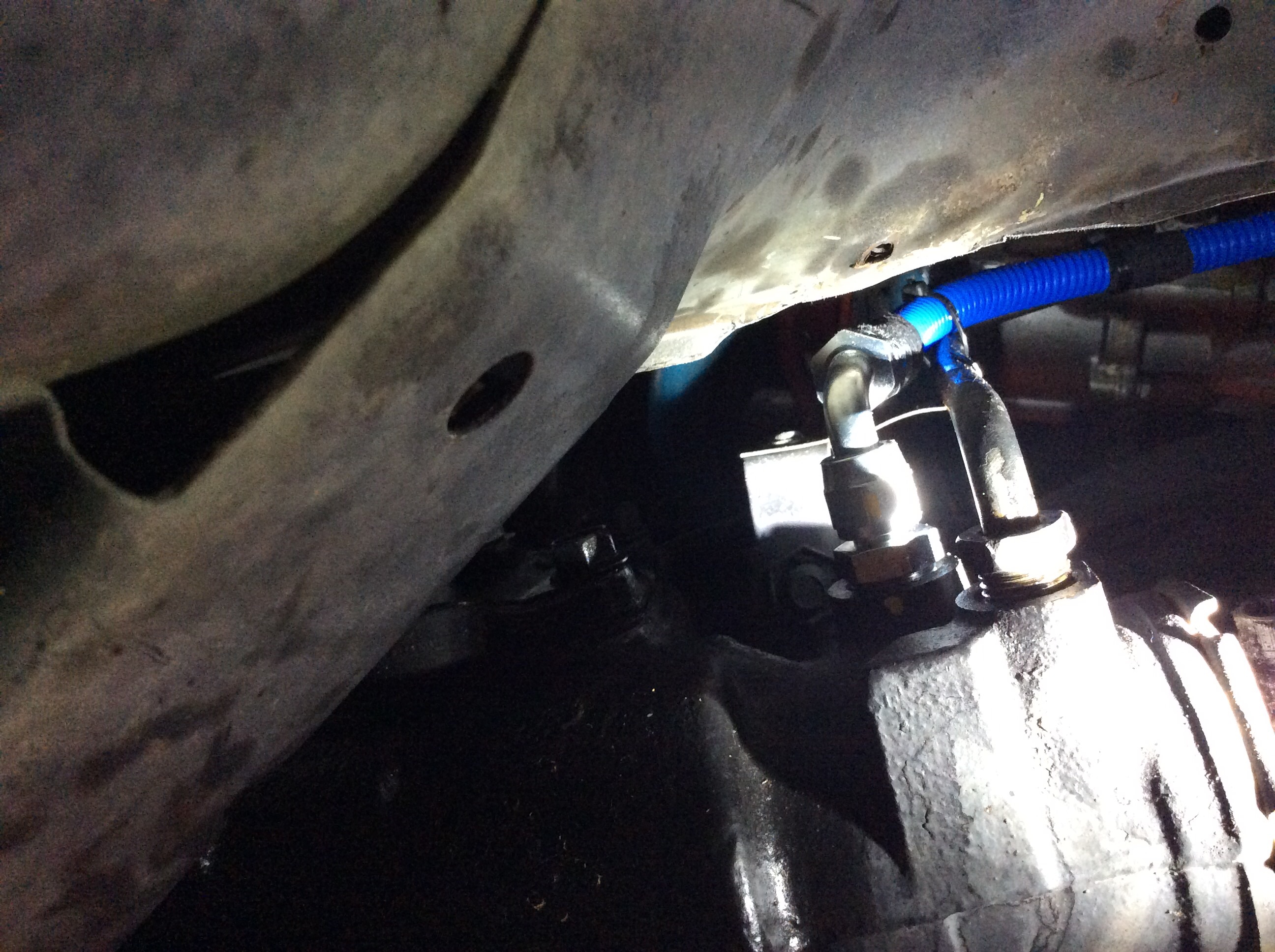

Because of the addition of the fittings to the high pressure side of the Hydroboost line, it raised it up really close to the wheel well sheet metal. Probably not a big deal, but it could be.

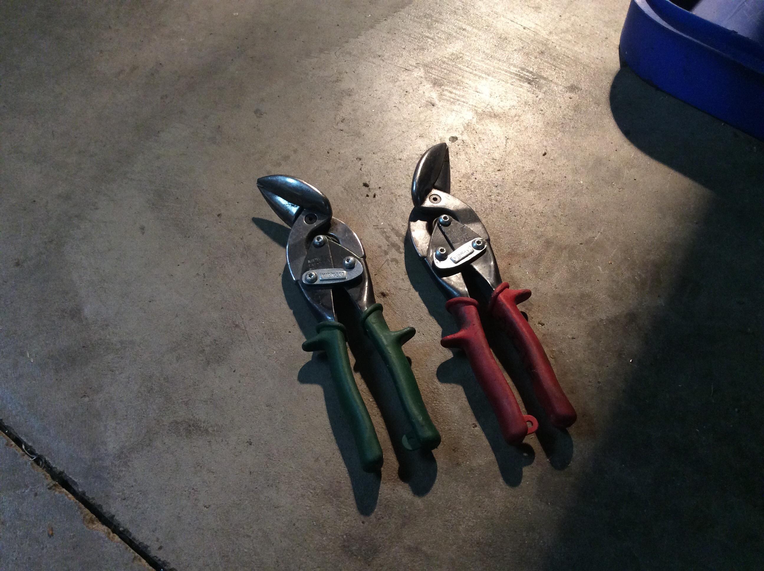

After 32 years of using these darn things, I planned on donating these to the next generation of tin knockers in the apprenticeship, but so glad I still had them for this task.

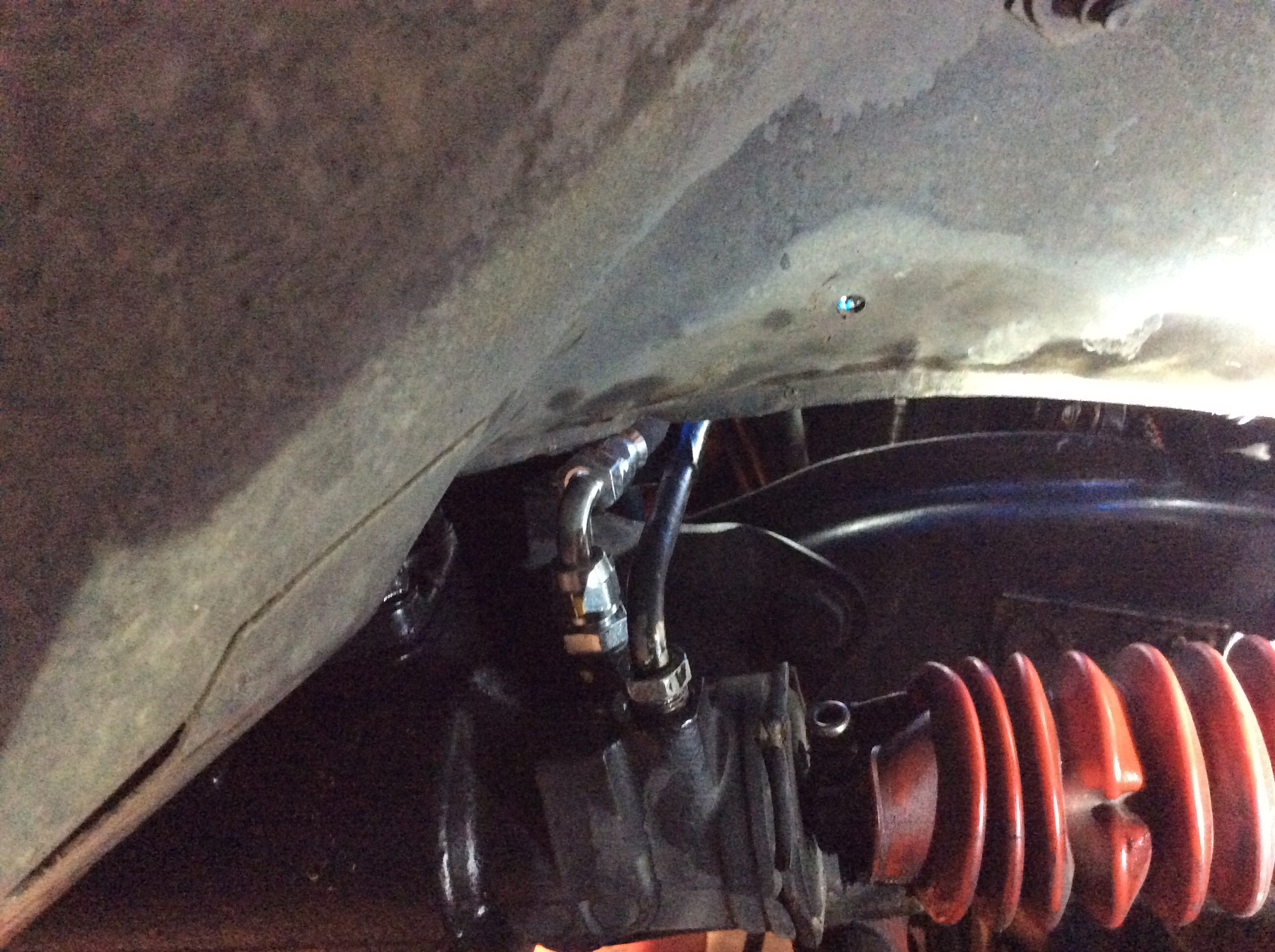

Much better. No fish hooks, or as we call them- "Tinner's Fleas"
