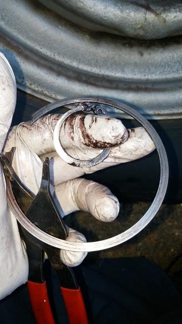

Checking the adjustment on my wheel bearings, as I can't find the reason for the sloppy steering (YET). I will, but this should help me.
Brought the truck to the spring shop I have do my springs. One of the springs I put in back in April of 2012 has a bushing that's a little soft. It could be the reason why my truck is tracking wrong, as the pitman arm isn't moving at all. I did, however get a new nut and lockwasher, but I don't have a 33 MM socket yet, but that will be here on Saturday.

Pulled the hub

Adjusted the nuts with this procedure.

Tighten the nuts down

Installed the clips
