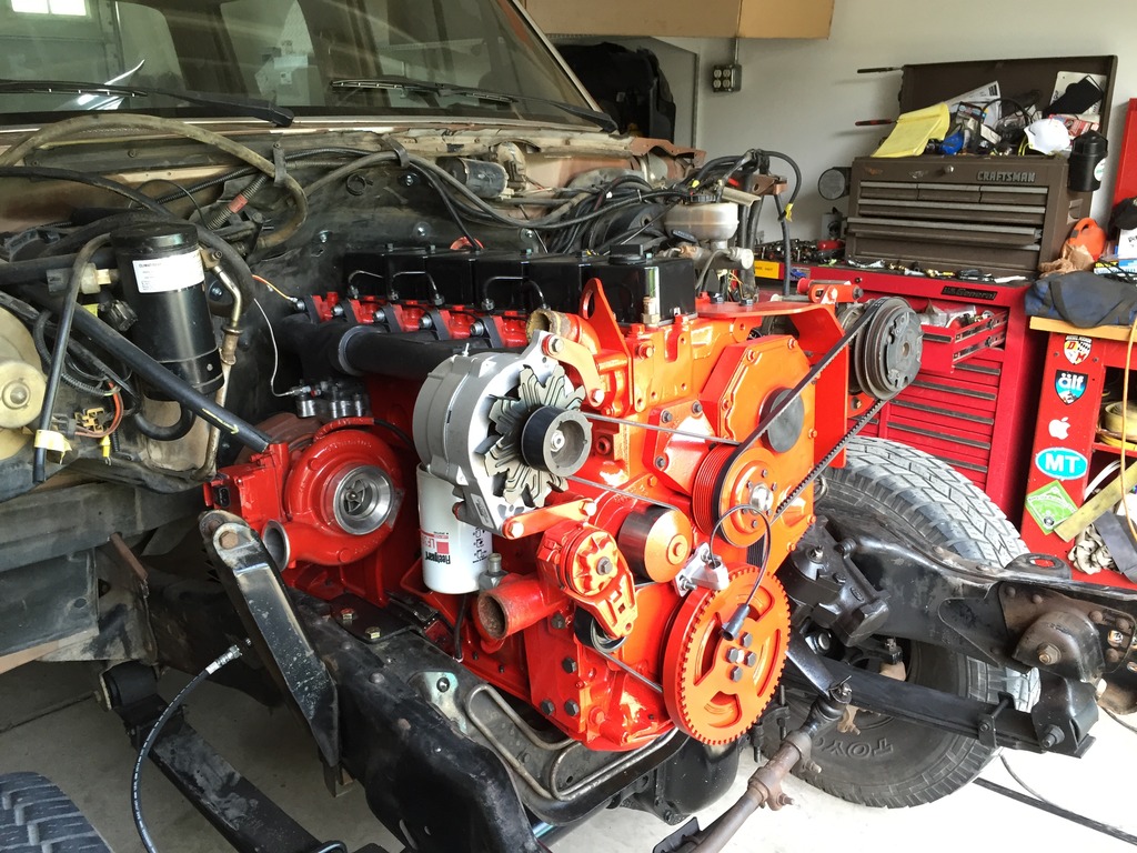

Mounted up an HE300VG turbo to a 1991.0 Non I/C cummins engine. Took a couple hours. Very close to the air box but made sure it won't hit even with motor torquing/shaking in fwd or reverse.

That's looking really nice Nick

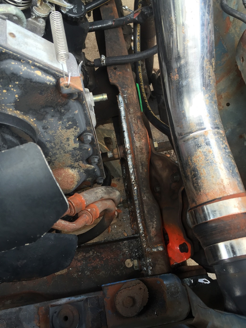

Finally finished the steering box bracing job... Made with 1/4 plate ane 1" 1/4 wall Dom drilled out to 9/16; happy so far, seems to steer a little better. Hard as all get out to do with engine in place and body on.
Size:  360.7 KB Terrible pic I know.
Also started building my homemade two stage rear suspension (you can see in the thread I just started)

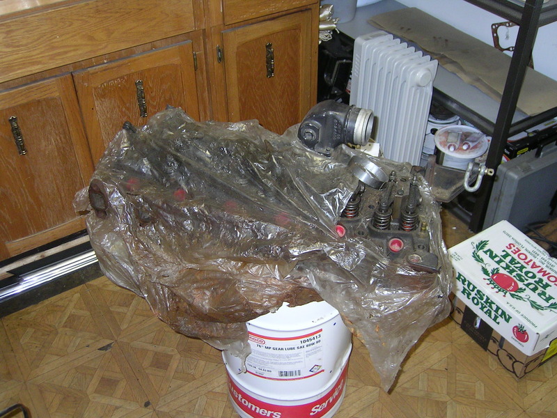

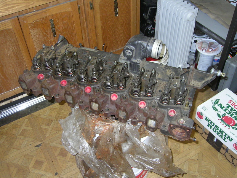

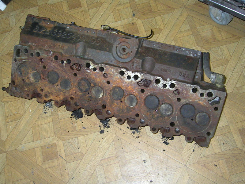

Today was spring service time. Air/oil/fuel filters and oil change, and grease the truck.
Also got a low mileage head from a 95/96 Ford F700 truck...supposed to be about 25K km's. Truck was an insurance write off and parted out, and my friend got most of the engine parts for the P-Pump motor. It had been sitting for a few years, I bartered for it.
Fresh after delivery...These heads are definitely a 2 man job to carry!

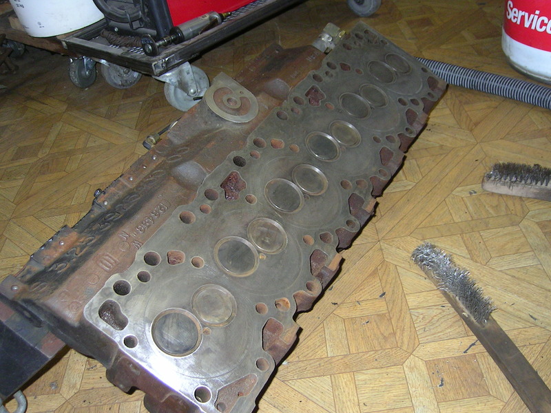

The underside looked worse then it was. A little bit of time spent with a wire brush and then some 120 grit sand paper cleaned it up nicely.

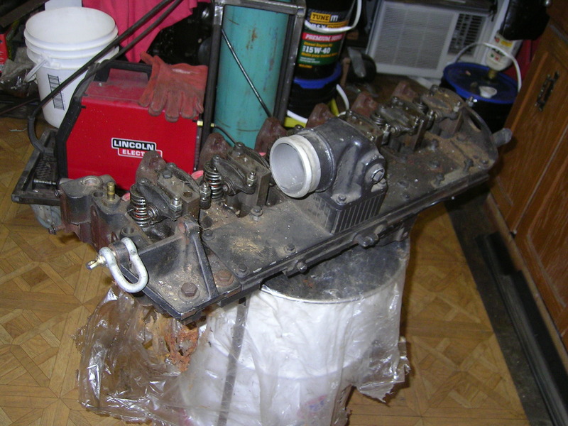

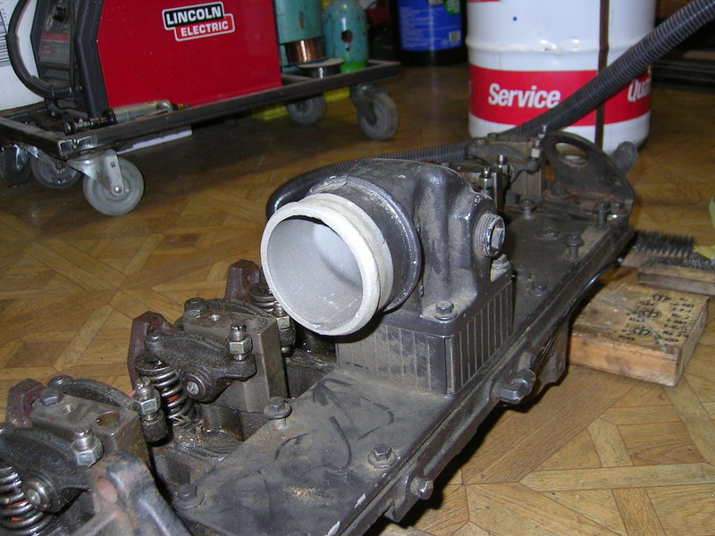

I really like the air intake set-up. It is a grid heater delete spacer and a 3" air inlet horn!
Thinking of adding the grid heater delete to the crewcab from around April to Sept, then swap the grid heaters back on for the cooler seasons.
