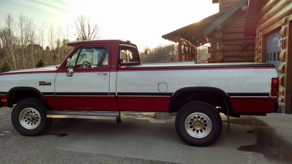

cleaned off all the winter salt. next is rebuild seering shaft then oil it down for the summerAttachment 44702
Looks nice. And good timing I am considering a set of wheels like yours but wasent sure how they would look on a first gen.

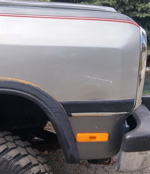

I did this today...
Man..... I'm

Originally Posted by NJTman
I did this today...
Man..... I'm
I did that to mine about a year ago. Like to have wiped the fender clean off the rice burner I "touched."
I did this today...
Man..... I'm
What happened?
