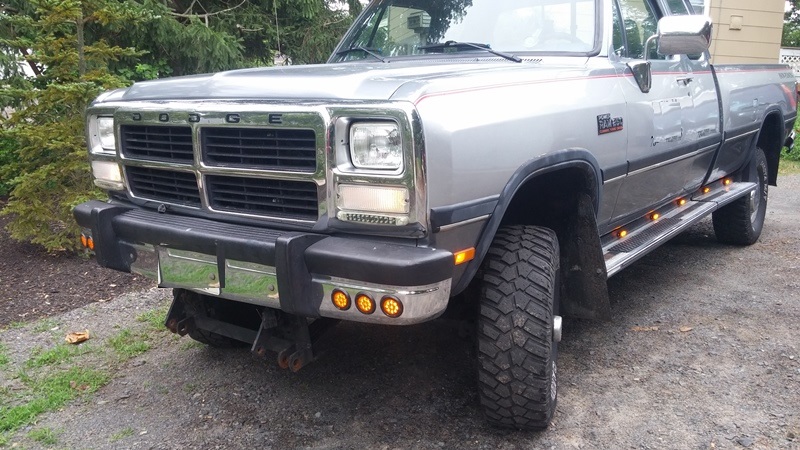

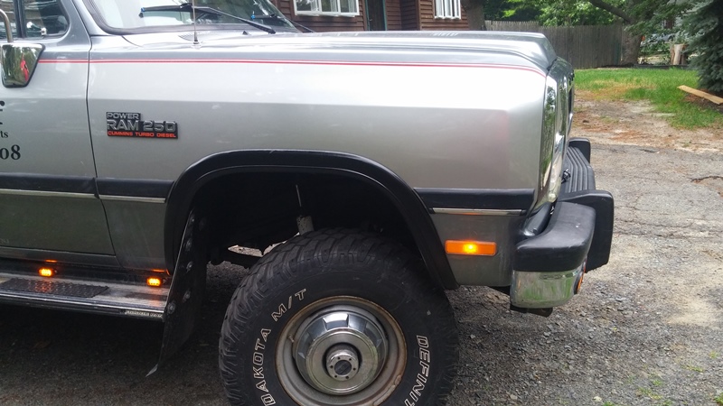

Put my wheel well molding back on after painting it. Not sure if I like the black over the grey that it was previously..

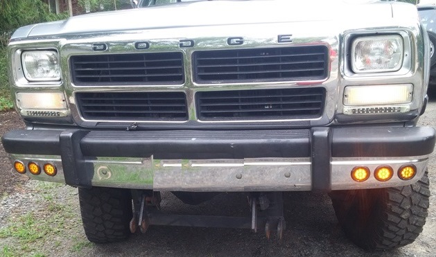

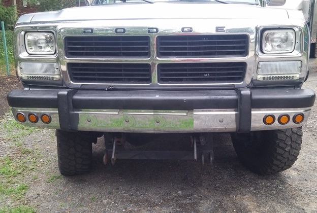

New LED's from Superbrightleds.com
Not much different, appearance wise, but hopefully they last longer than 8 months..

Looking good.
Tman, are those white LED light bars under your turn signals as well, that I see in the pictures?
Are they driving lights that come on with the headlights?
Old Jun 21, 2015 | 06:09 PM
  #1086
Posts: 6,837
Looking good.

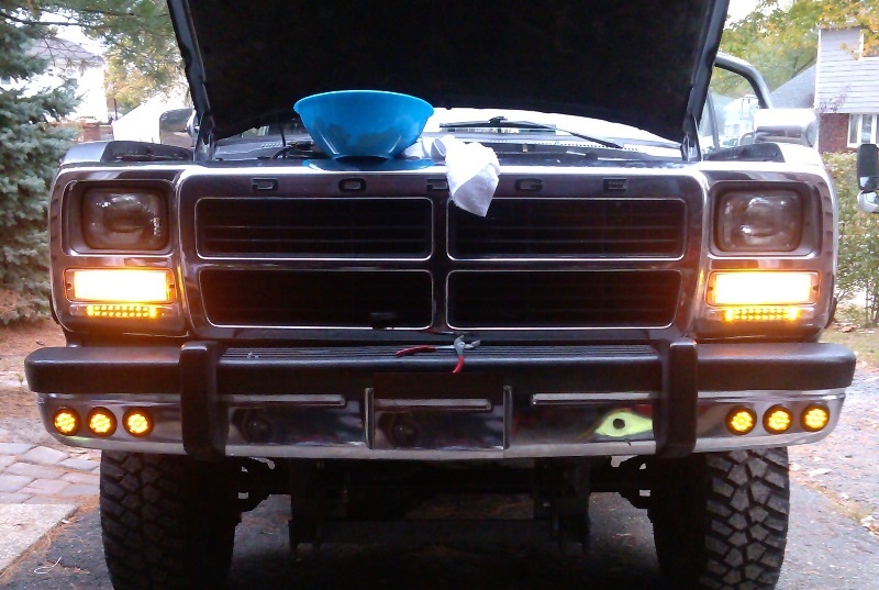

Those are " amber" lights because they come on with the blinkers only, although that's a good idea to get them in white and have them on all the time.
I wanted mine to appear when I was making turns. They're multiple times brighter than our turn signals, and when the turn signal bulbs burn out, like one did the other day, I still have blinkers.

I was thinking the same thing Oliver.
I'd make them my fog lights if I was to have a set installed like that. I like the idea so much I think it is on my "to do" list now.

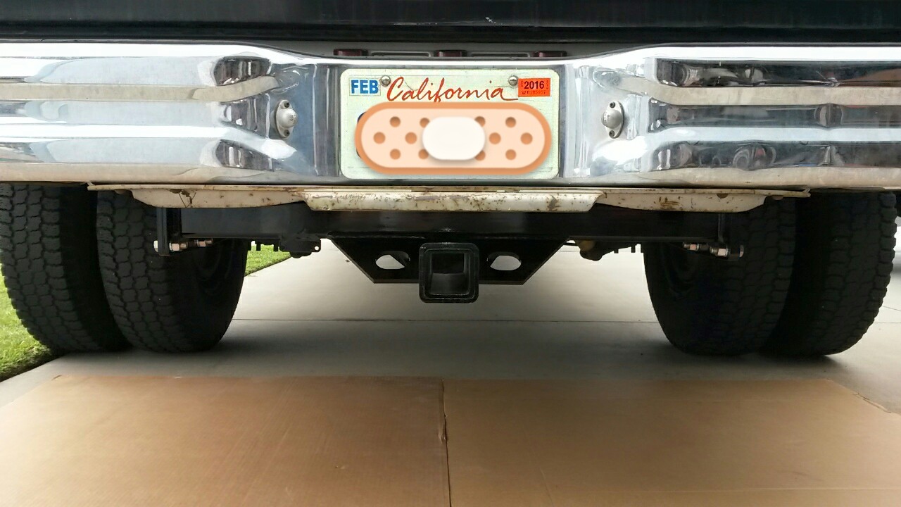

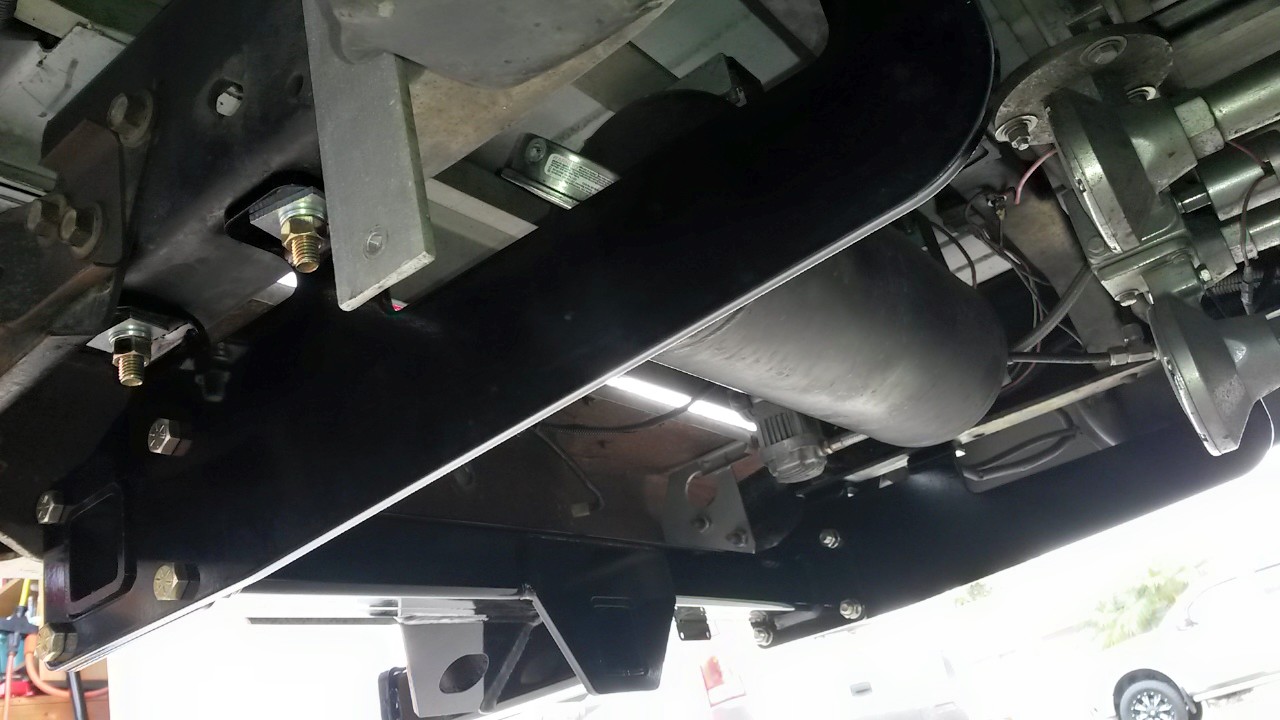

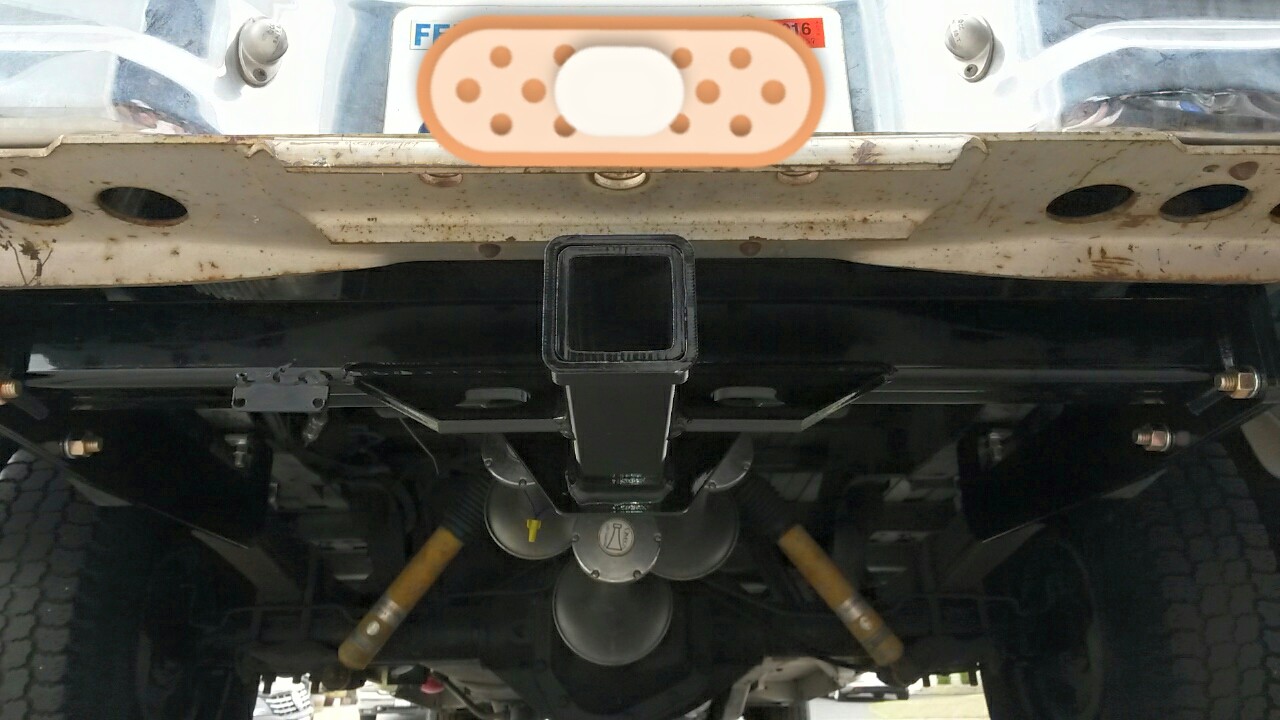

Last weekend, I installed a B&W receiver hitch on my pile, HDRH25122, rated for 16,000lbs trailer weight and 1,600lbs TW with a weight distribution system; 15,000lbs trailer weight and 1,500lbs TW without weight distribution. Picked it up on Amazon through a place called Autoplicity for $157(?) with free shipping. Not bad at all considering MSRP is around $250.
What a stout and solid unit! I don't have any near future plans to tow anything but just wanted to ability to if the need ever arises. And, although, it's rated for so much weight, I wouldn't plan on coming near that with a conventional tow. Should I start to push 12,000lbs, I'd prefer to go gooseneck. Just the added assurance of having a buffer. I've always gone a little overkill on some things .
