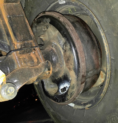

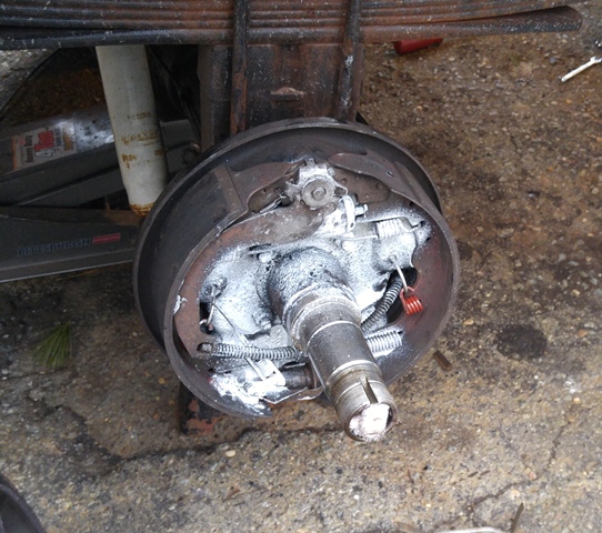

Today, it turned out that the drivers side is not the culprit after all. It was the passenger side.
So, after much fumbling, I got it to release, and then it stuck again. Got it apart.

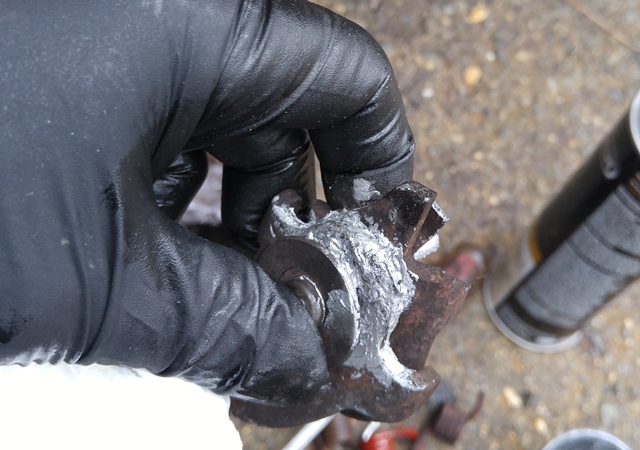

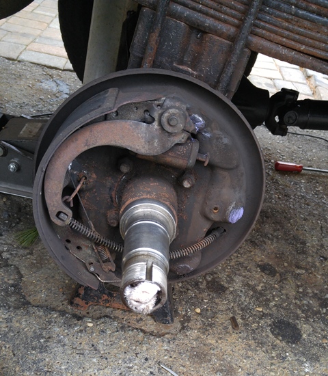

Well it's been about a year and a half (if that) and I found that the new cable to the passenger side (raybestos) had frozen. The jet heater fixed that temporarily, but I also had another issue. The parts I replaced last year are rusting away. Geesh! Makes me want to dump this truck and go buy something new (obviously, I'm not doing this) so that at least then I could buy new OEM parts that won't disintegrate in a year.

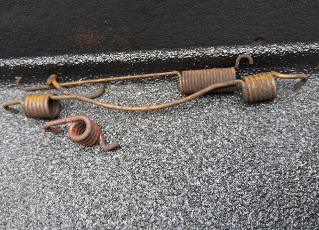

After disassembling everything including the ebrake pivot (which I did last year), I'm doing it all over again. New spring kit, and cleaned out the dust in the drum (which is what I think was causing the issue of it getting stuck.. The dust was so much it made it very difficult to remove the drum. Oh well.
The new hardware set had almost no protective coating on them (go figure, huh?), so instead of going crazy painting everything, I just sprayed a light coat of white lithium on it.. I figure since this is winter, it will stay in place for at least long enough for the brake dust to stick to it, and create a coating. Hopefully I won't be doing this again anytime soon. If it melts, and ruins the shoes.... don't really care at this point.
So, The other side can wait till later.

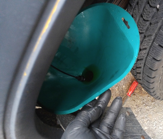

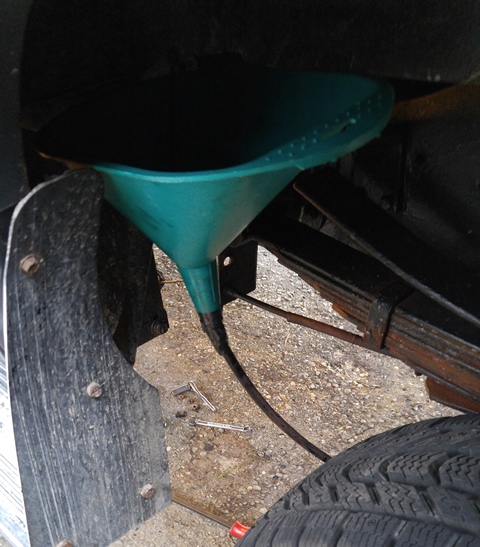

BTW. The cable was freed up, so I did my funnel idea. It worked quite well. Put the cable through a funnel, tape up the end, fill with oil. Moving the cable back and forth drew the oil down into the cable assembly. I filled the open end at the spreader bar / front cable with Never seize for now E brake works amazing now.
BY far the easiest and most precise way of adjusting your brakes is with the axle out, tire off. I have the passenger side down to just before it touches. The I backed it off just enough so no drag at all... So far, no leaks.

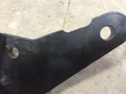

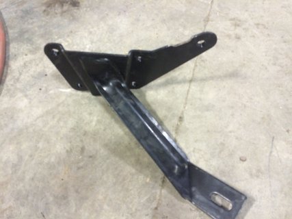

Finally got my dodge connection steering brace yesterday, went to put it on and had to modify it with a grinder a little to clear the little dip for the crumple zone in the frame on my 92. Other than that it fits good.
That is a slick idea....and you can do it while the cable is still on the truck!
Looks good. Never heard of anyone having to clear the dimple in the frame before, Good info. And thanks for the pics!
Welcome for the pics. From everything I had read on them, it should have been fine. But I think that side might be tweaked just a little. Because I noticed the front spring hanger was bolted in place rather than the rivots, like the other side.
