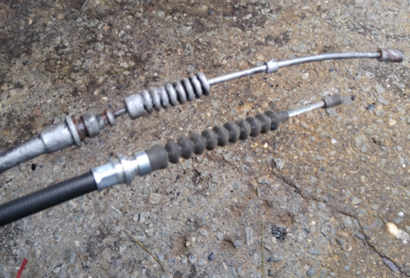

Nice weather day today, so I inspected and lubed up the driver side rear brakes. show you the difference between aftermarket and OEM brake cable. The bottom one is from Dodge. The top one is raybestos. Huge difference, and why they fail due to water infiltrating the casing.
I did what Oliver said with the heat shrink tubing.
Well see..

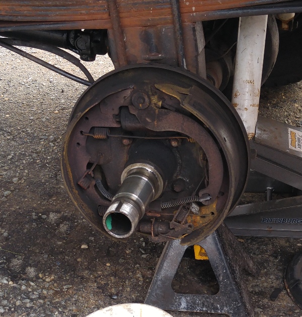

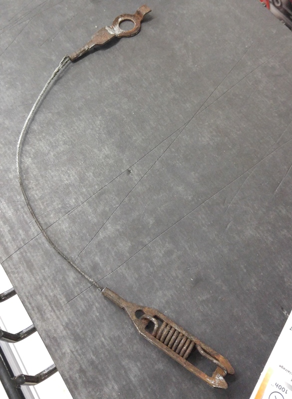

Rear brake shoes still good. Everything looked okay except it was all rusting. Replaced the springs, lubed the center pivot for the E brake lever, and luckily I took it all apart, as look what I found inside which was hidden by the e brake lever .. That would have snapped, and the spring cage and wire would have got caught between the drum and shoes.

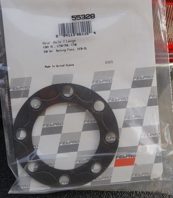

These Fel pro gaskets are well worth the couple dollars each. It makes it so simple to do the cleanup, as they're really isn't any. Pull the axle, wipe it down, replace the gasket with new, tighten bolts. No goop to scrape or real cleanup.

Good idea about the axle gaskets.

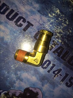

Hillbilly, curious on your fitting type. Are they black, plastic, and the wrench flat area above the NPT threaded portion more of a star shape deal rather than a hex bolt shape?

All brass Gates fitting. Part number on Napa receipt: G31104-0402

Ok, I see the issue now with not having the room- thanks
