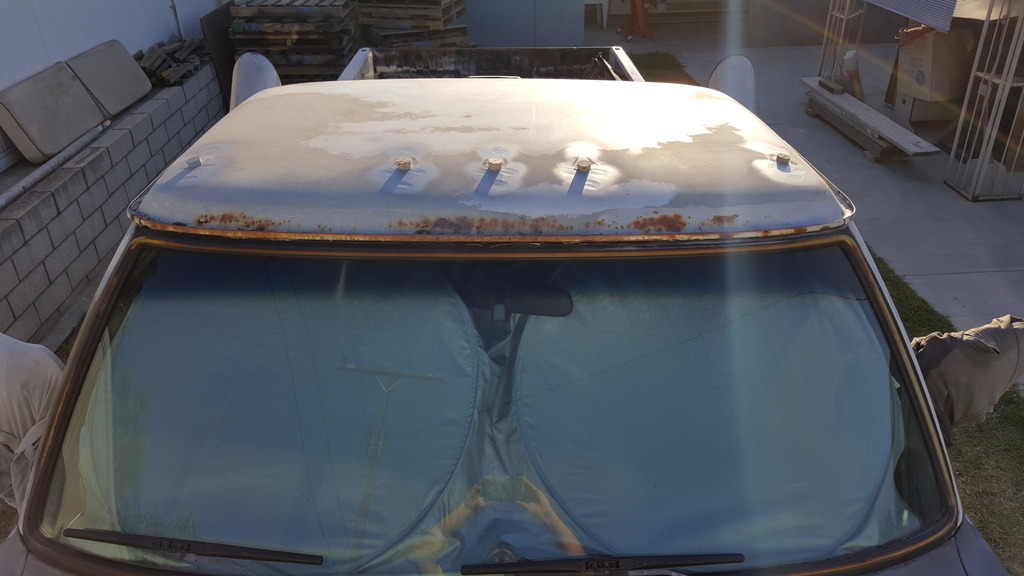

Finished up filling all the existing cab light mounting holes. Ready for the 3rd gen lights to go on.

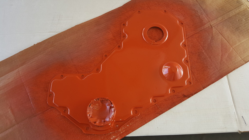

Back to some engine work. I painted the timing cover which I think is the last of the engine parts.

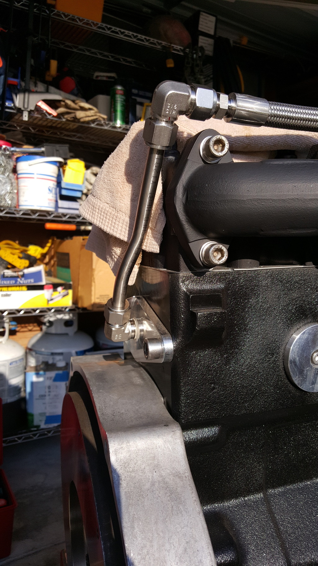

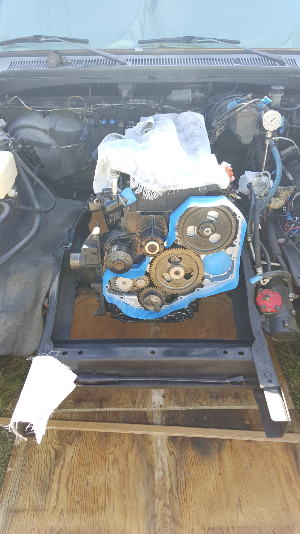

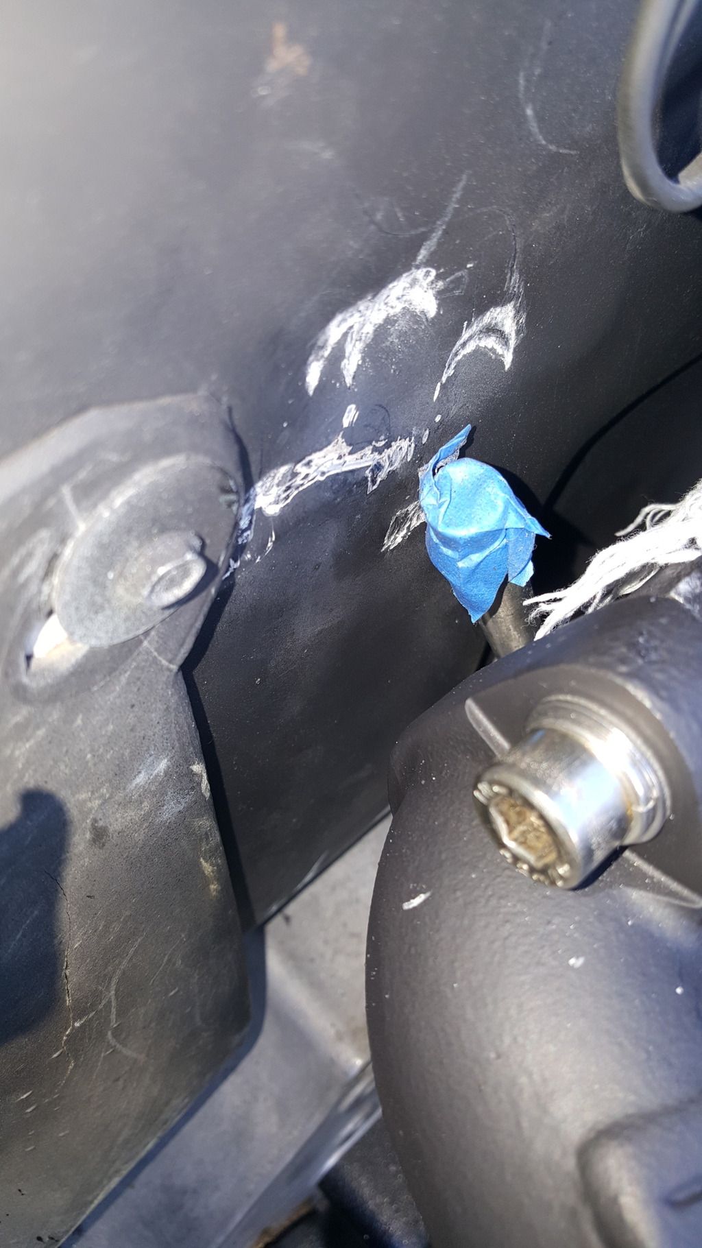

Been a long time since I've seen the engine sitting in the frame. But had to take it right back out after seeing the lack of clearance for the coolant bypass.

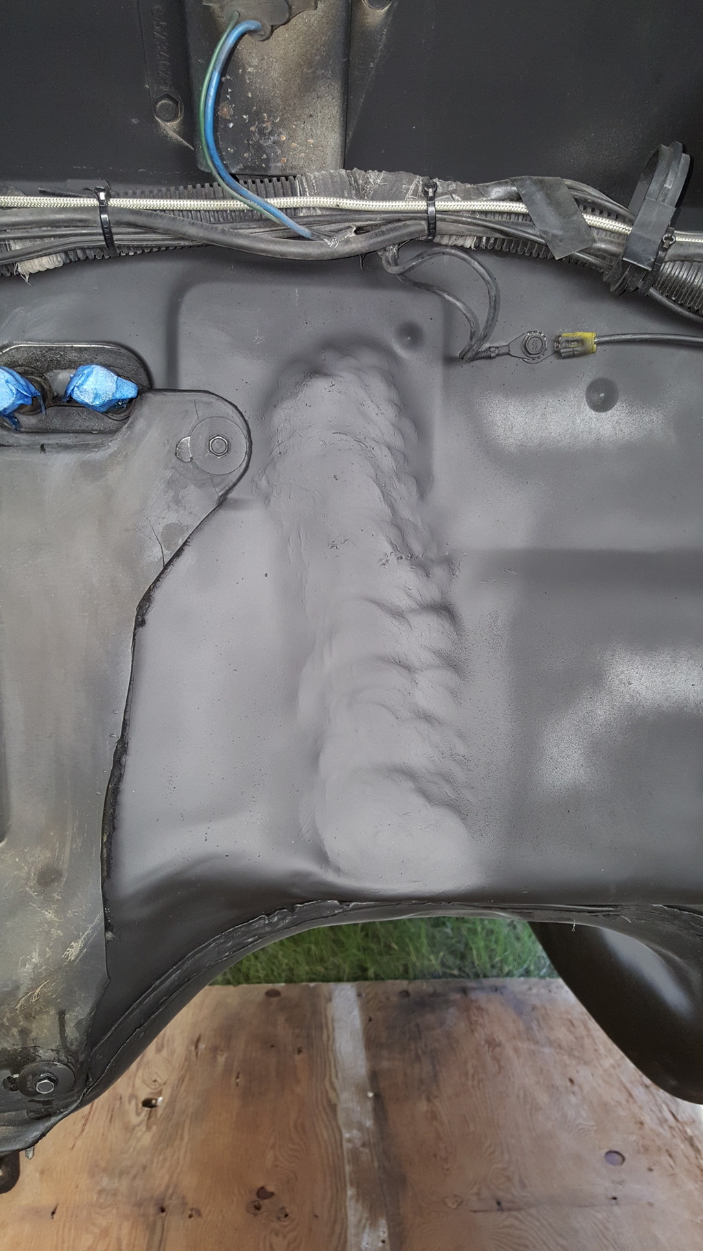

So I tried my best at body work with an 8lbs. sledgehammer. LOL Thankfully, nobody will see much of this.

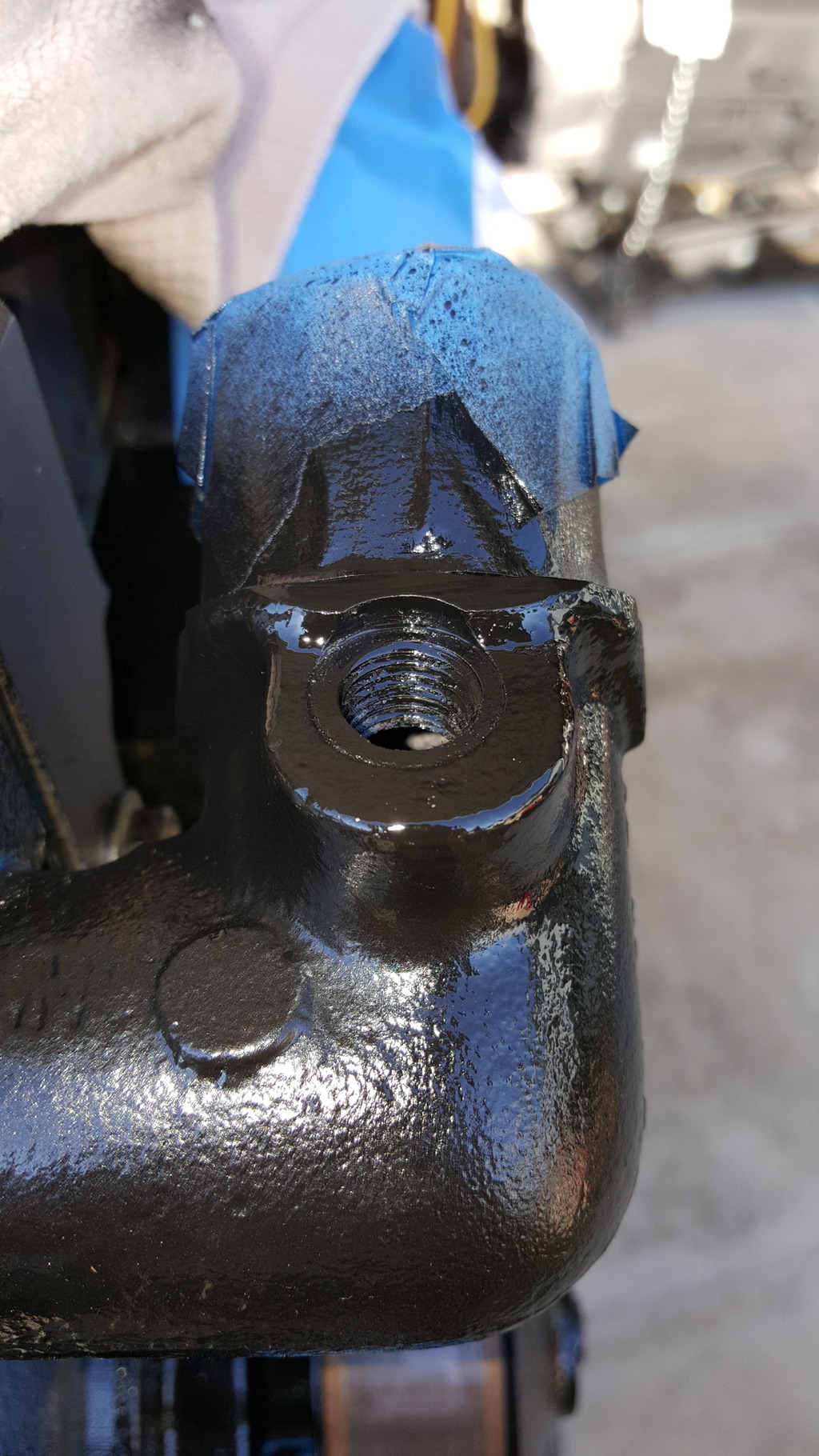

So I had to change things up a bit. Earlier today, I picked up the stainless hose I ordered.
I ground off some of the shoulder on the thermostat housing neck.

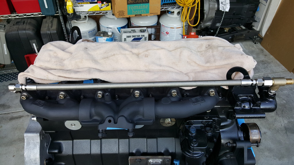

Made a new length of tubing with a slight 'S' bend in it.

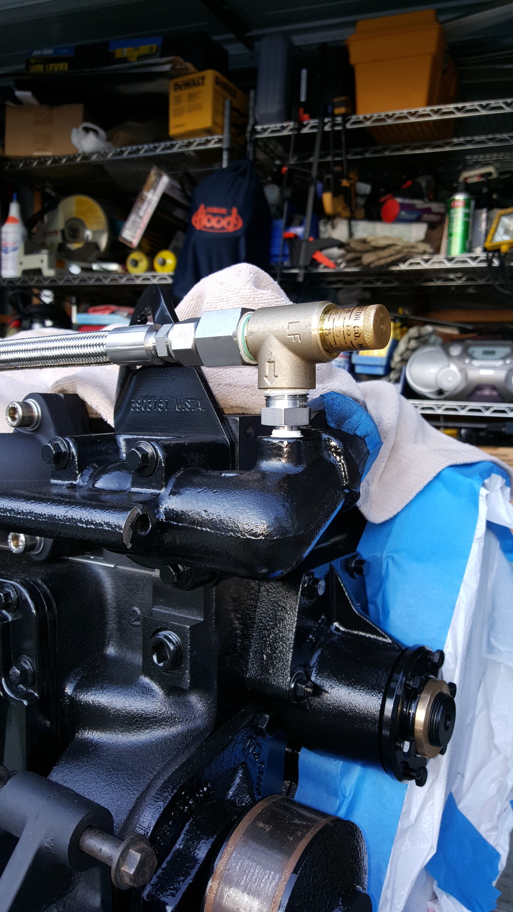

Used a 1/4" x 1/2" stainless nipple and put the PRV at the thermostat housing.
I'm diggin' it!!
Luckily, a solid 3/8" of clearance at least for the fan blades.

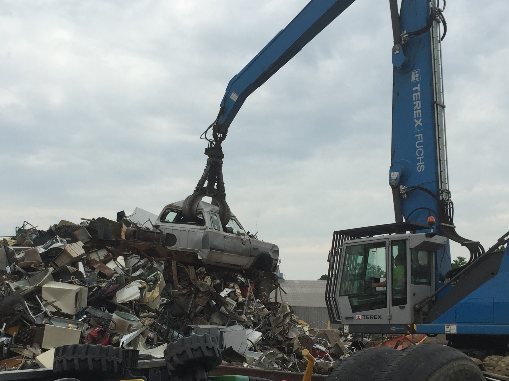

Used the 92 W250 to haul off what was left of the '93 D250. Bye bye rusted pile, hello $150.
OH MY!!! HERESEY!!! So sad, poor 1st gen . I could of used those mirrors, mine are starting to give in to wind resistance...and that like gold, trim molding pieces...Could of warned us first, "Image may be disturbing to some viewers!"
haha... believe me i pulled every good part off of this thing! what was left was either rusted out, broken, or bent.
Rusty pile?!?!?!?! That cab's nicer than EITHER of mine! Lots of good parts left on it too....
