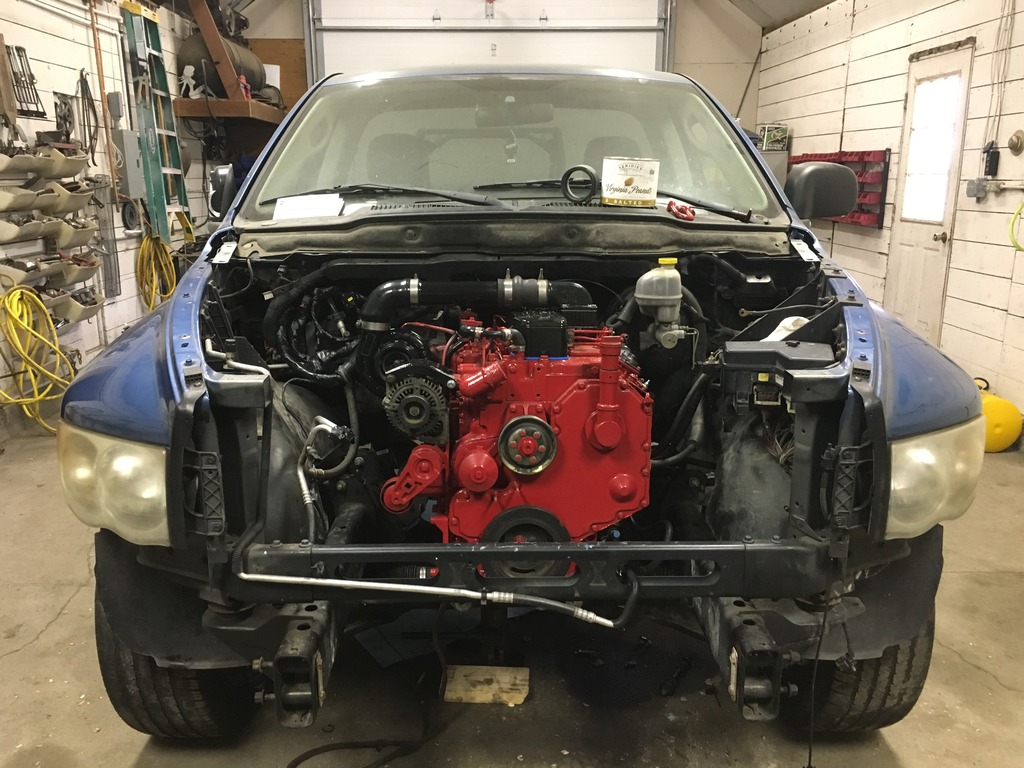

been working on this project for a few weeks now. have a build thread on cf.com. i'm 1st gen to the core and with a 1st gen drivetrain, i can't help but share this with y'all. i get excited every time i can make a 1st gen part work for something on this project, lol.
Looking good justin....are you trying to make it look like an ISX cummins?
I had to google "ISX Cummins" to even know what that was, lmao. Had IH red paint in the shop so that's what I used.
Or N14
Looks good Justin,
What did you use for the intake. looks interesting.

Originally Posted by mknittle
Looks good Justin,
It's the grid heater with a grid heater delete on top and then the IC intake horn turned around. Turbo is just clocked up with a 2.75" to 2.5" elbow. The pipe between is the stock turbo side IC pipe off of my 93. Didn't even have to cut it down, it just fit, lol.
Thanks, for some reason I was thinking the horn was a different shape.
