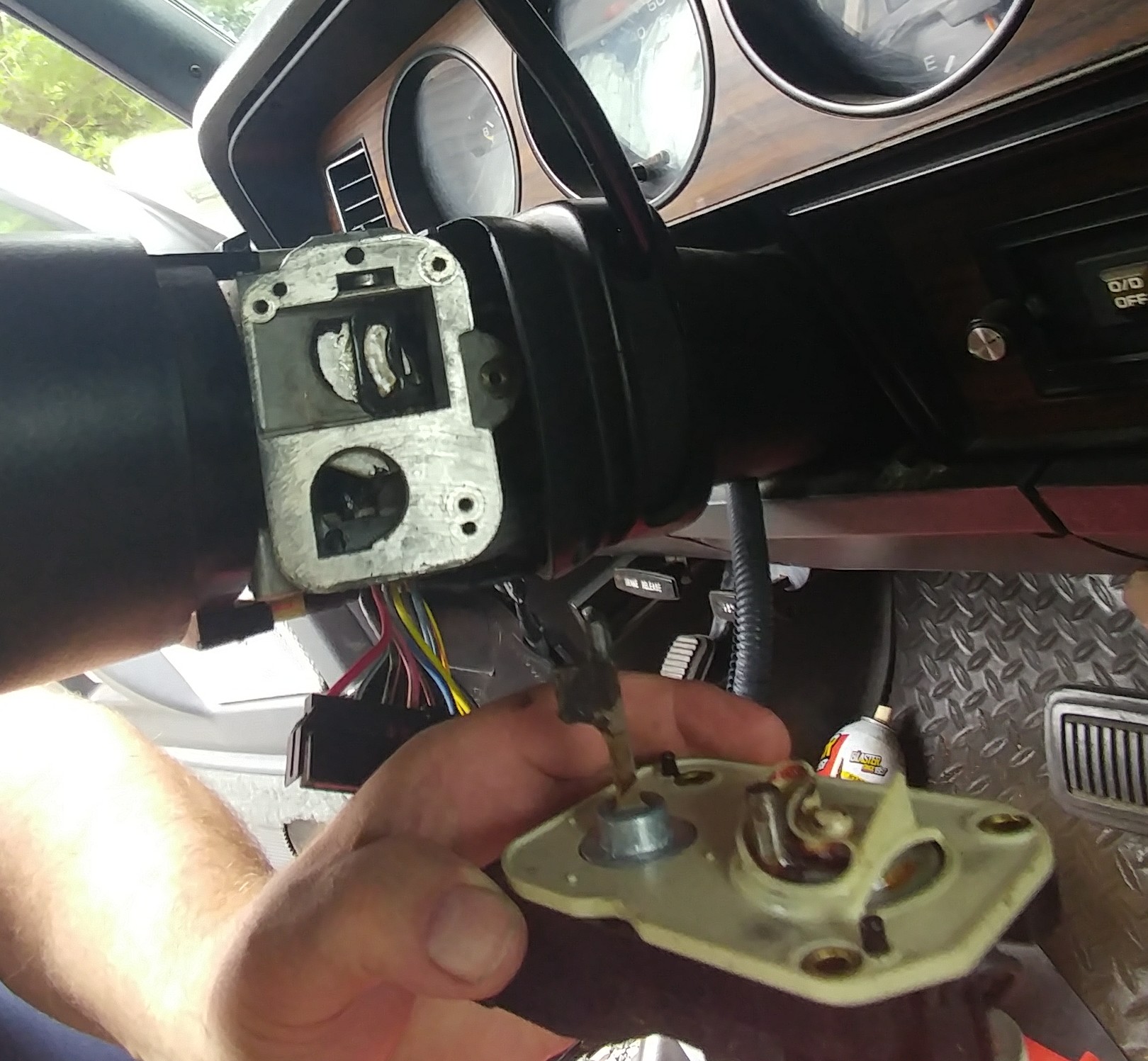

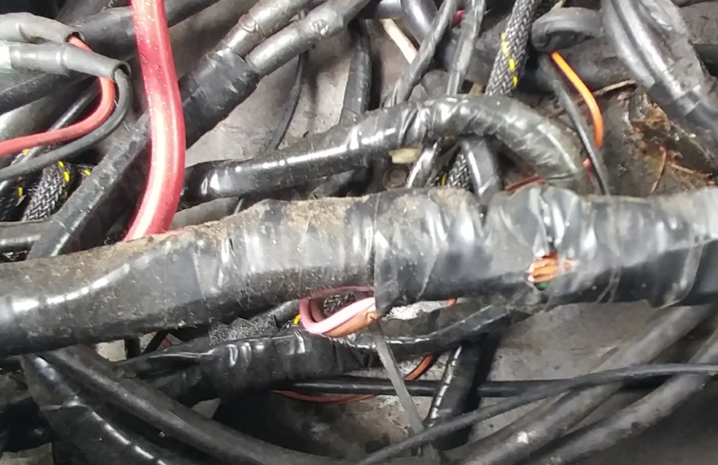

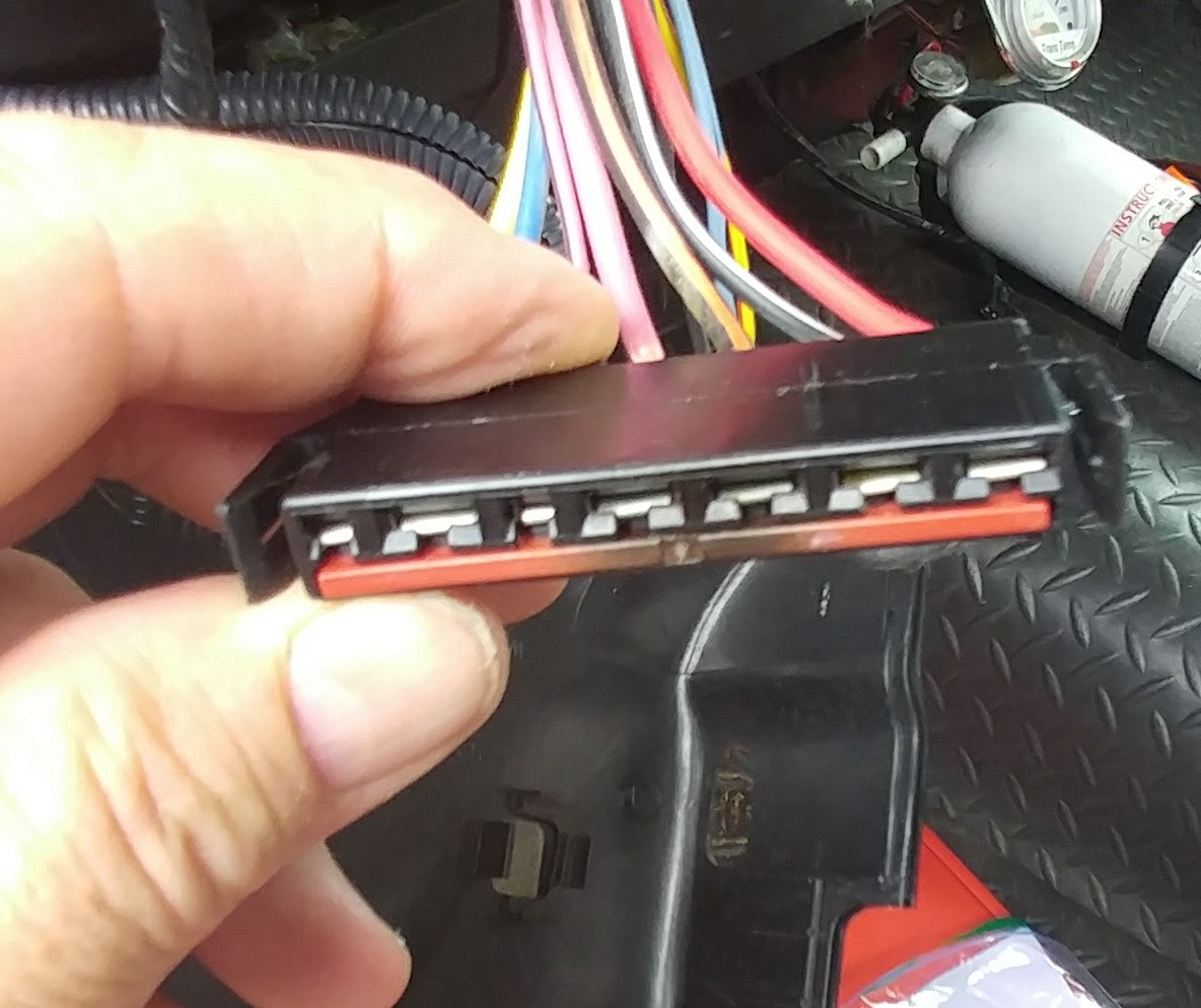

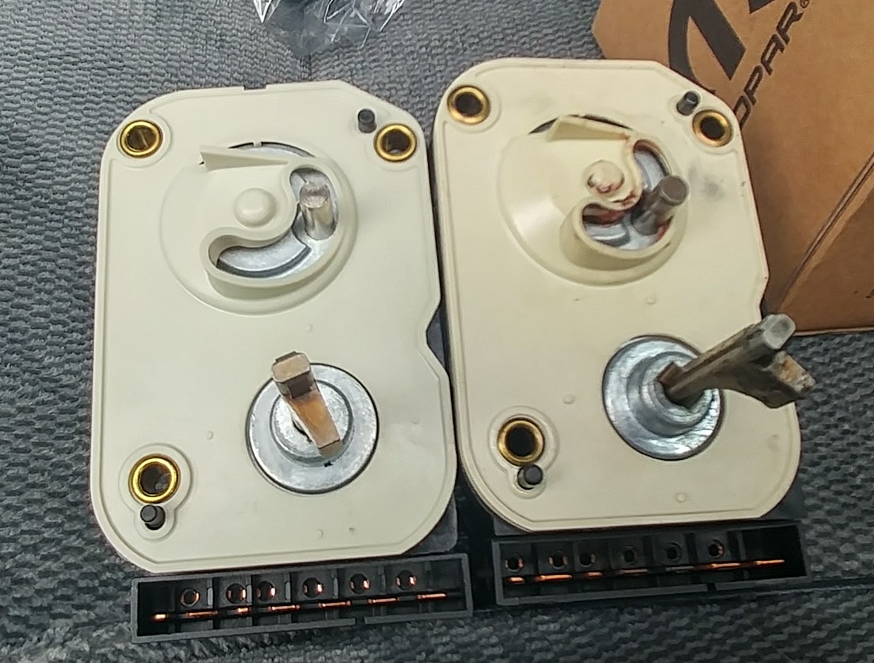

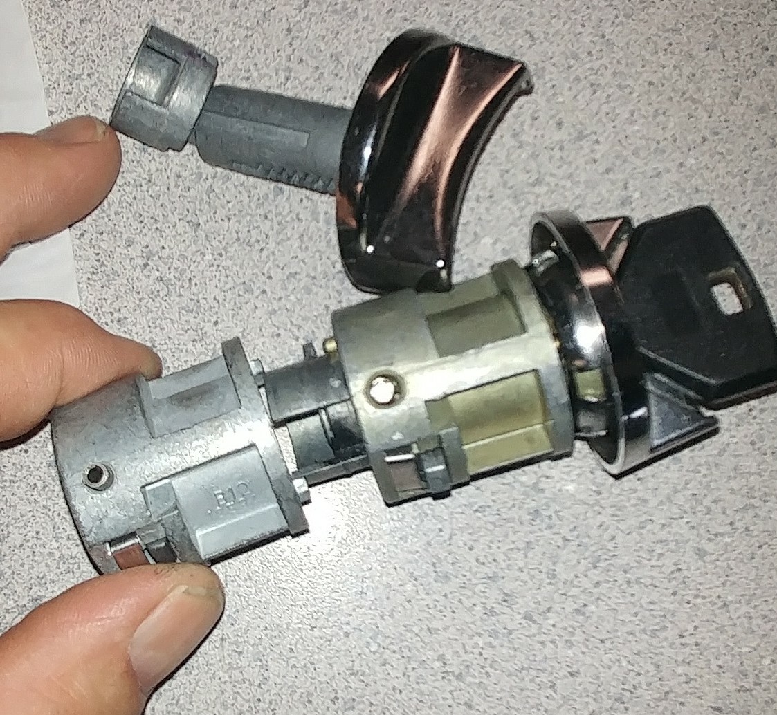

Got the dead brick running today. Replaced the sticky ignition switch, and since dodge sent me,the incorrect lock cylinder, I reused it temporarily. Still works.. Just a bit sloppy.
The no start condition was not the ignition switch or the lock cyl. It was the 25 year old starter relay. Relay wire from it to the connector where the starter solenoid quick connect is, melted and popped the fuse where it was a fusable link. Temporarily fixed it, but ordered new 30amp relay harness from Hella. At least I can drive it again. I was in withdrawal..

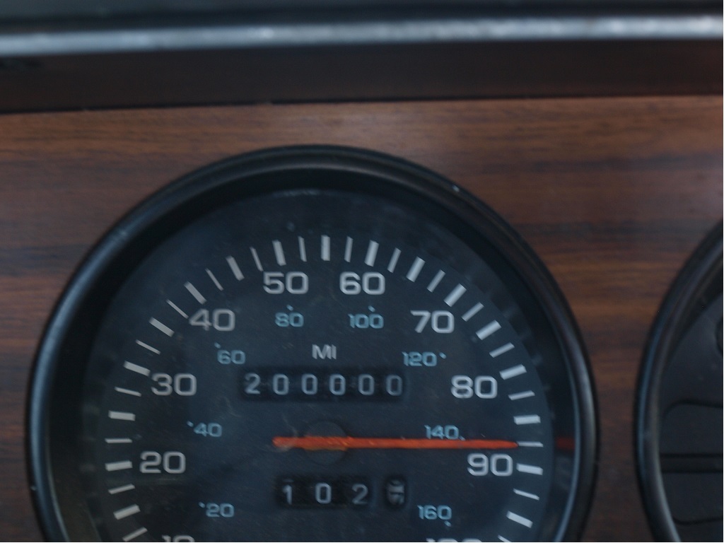

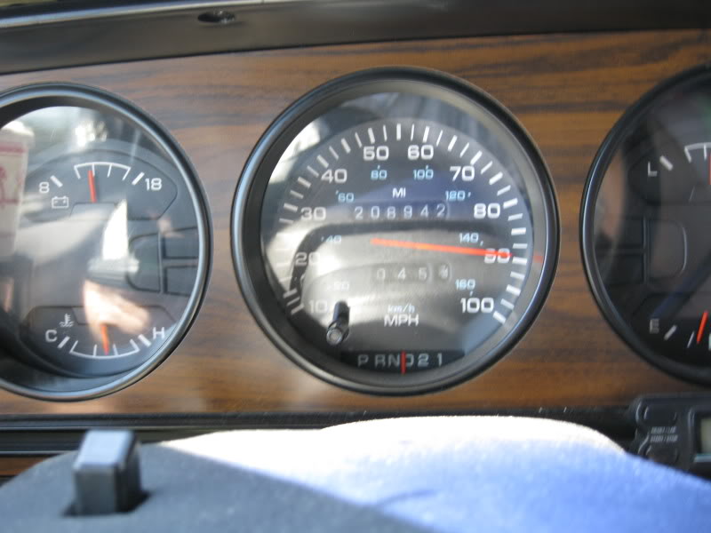

My rig is bone stock, except that the pump is pushed to the head...Mark
