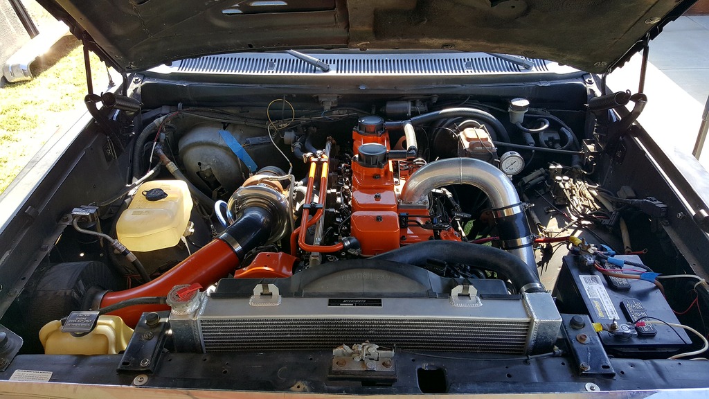

Swapped out my stock injectors for the OEM set I cleaned up last week. Took me about 4 hours to do the swap last night. Took it for a quick burn and it does seem smoother and quieter.
But my past experiences has shown that after I do a change or repair it seems to take a few days for things to "settle" and I can get a good reference if things have gotten better or worse.

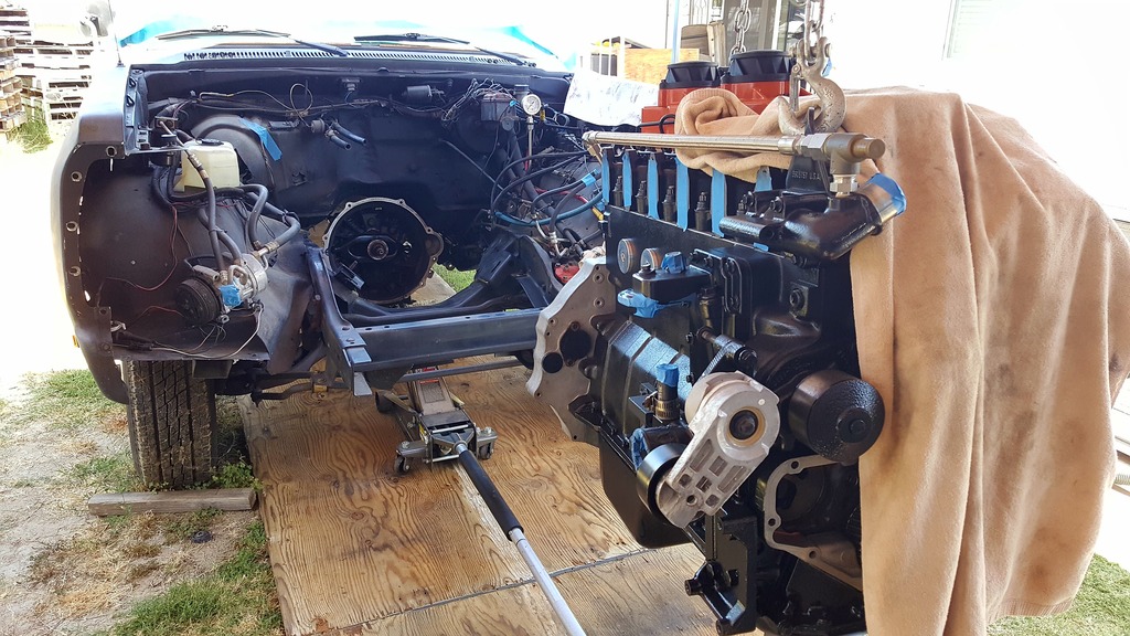

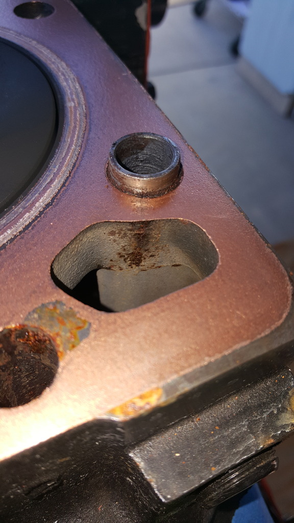

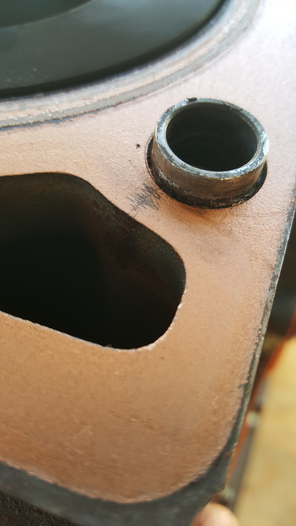

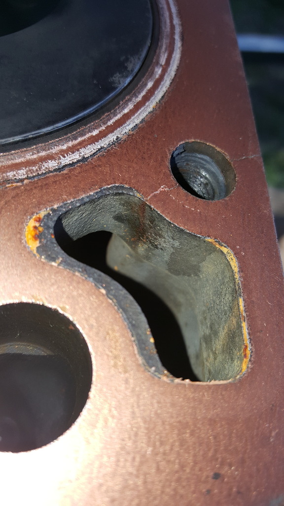

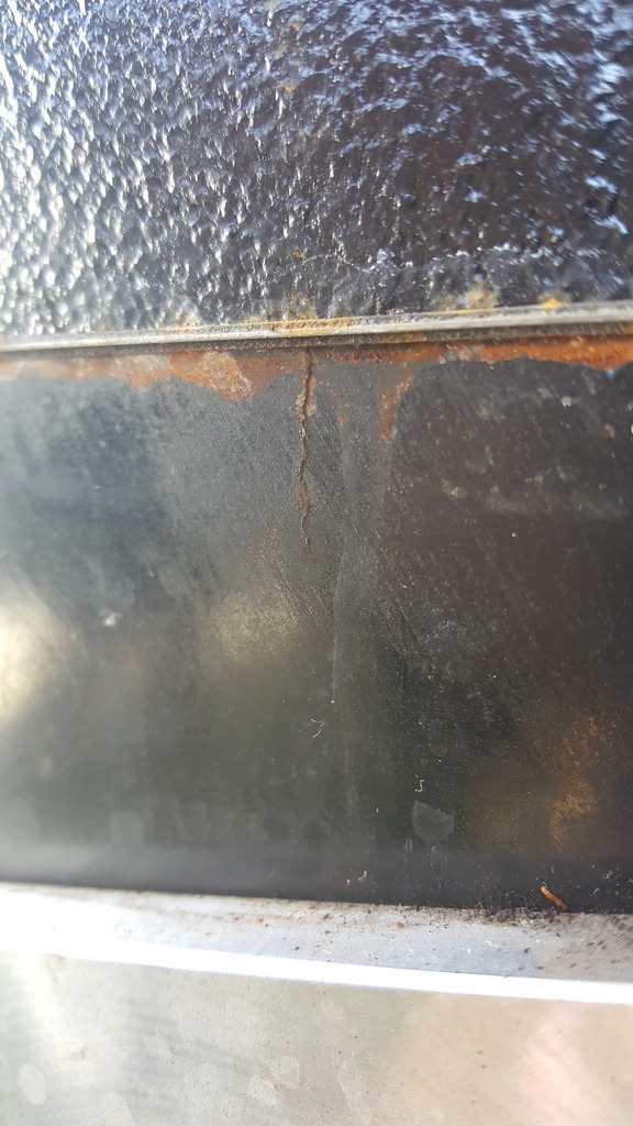

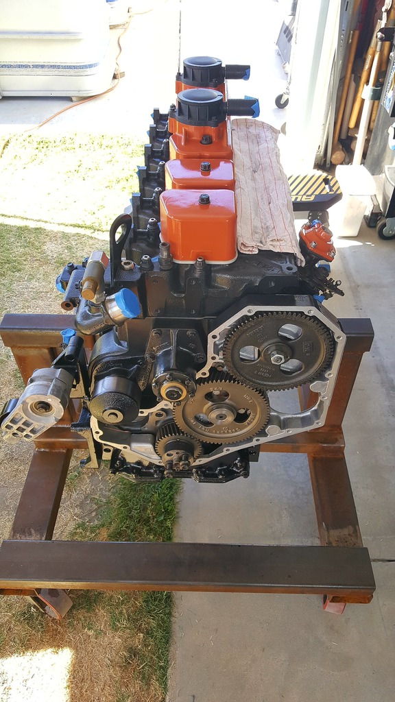

Lucky me, $100 bought a shortblock with a cracked timing case from a buddy of mine. Now I have spare engine parts to sell that will pay me back and then some. Took them both to a local machine shop and had them disassemble both blocks and reassemble the replacement block with all of my internals. The new block was cleaned, magnafluxed and inspected with good news. Along with having the cylinders punched open .020" to accept the new pistons, I opted to have the deck surfaced to get it flat just as the head still was at this time. The deck had .006" of material removed to make the true.
I took all of last week off of work and still worked like a dog to get it back together and back in the truck. Friday evening, I cranked it to build good oil pressure, bled the injectors and let 'er come alive for a few minutes. Saturday, I buttoned up a few small details and filled the block with antifreeze. With the luck I had after the first rebuild, you can probably imagine how nerve-wracking this was for me. So much so that my hands were shaking. I was dreading that I would see it leak again.

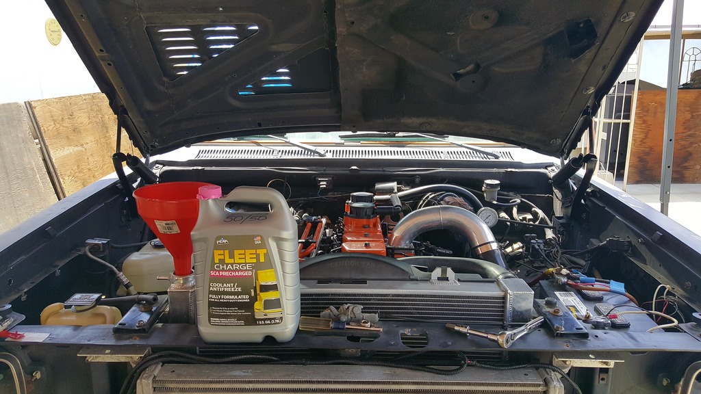

However, I'm happy to report that it held nearly all 4 gallons! After finally getting the truck out of the backyard and onto the street again, I opened it up a little to get things up to temperature. As of late last night, it's still leak free. What a project! What a year!

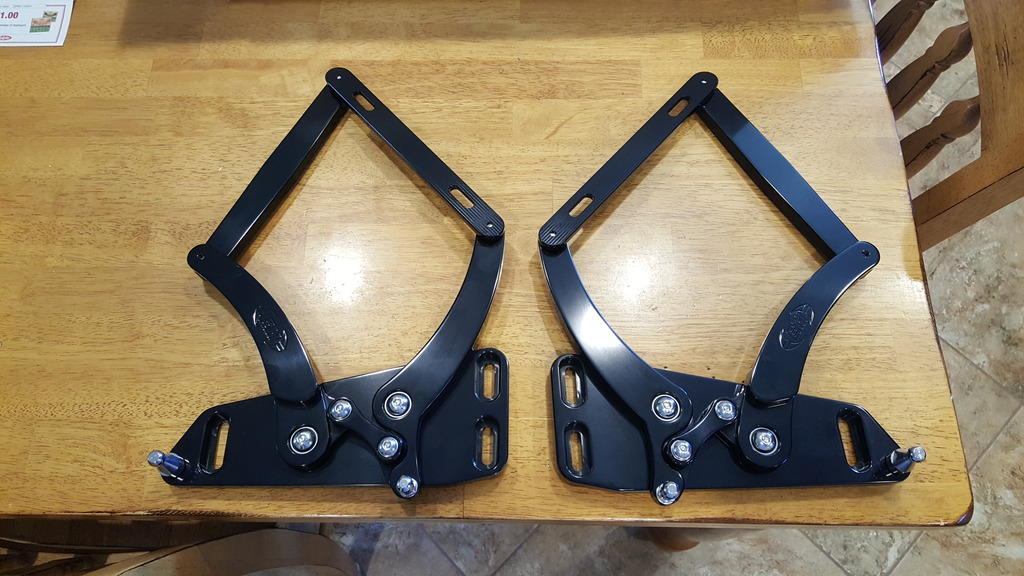

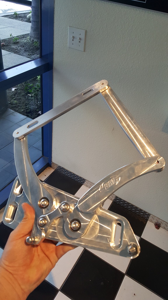

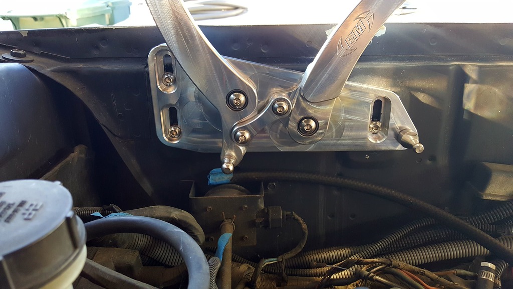

In the middle of my motor's second rebuild, I went on a weekend getaway to Vegas for Mopars at The Strip. Or as it's been renamed to make the Ford, GM and other guys feel more welcome, Muscle Cars at The Strip
. While checking out some of the show cars, I mentally noted that the 67-70 B-body hood hinges looked very familiar to the truck's hood hinges.
As the weekend went on, I noticed other B-body cars had billet aluminum hood hinges with small nitrogen struts attached.
Now this piqued my interest. I posted last year sometime about trying to figure out how I could adapt nitrogen struts to my hinges or hood. My original springs are certainly worn from years of usage. They hold the weight of the hood but don't do much assistance in lifting. I couldn't seem to come up with the info I felt was necessary. Seeing these billet hinges sent me on a mission. As soon as I got home I started searching on Google. One of the first results listed was a place called Eddie Motorsports and to my surprise, they're less than an hour away from me.
So what did I do??? I grabbed one of my hood hinges, drove on out and had a chat with them. The only way I could test these, of course, was to buy a pair and put them on. If they didn't fit, I'd simply return them. Being that they were just a trial, they suggested a raw, unfinished set.

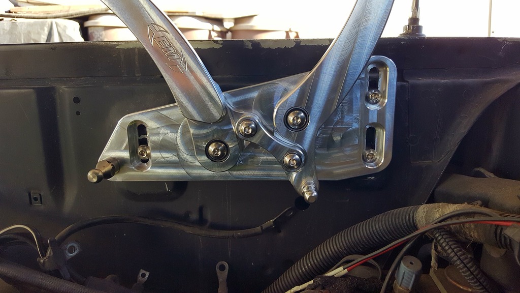

Over the weekend, I was finally able to see if they would work. Fitment, geometry and stainless hardware provided is all spot on! Alignment was good but they would need only very slight modifications to make them perfect. As you'll notice in the following pictures, with them at their highest, the back of the hood sits about 1/8" low on both sides. It seems simply lengthening the slots in the fender flanges would do the trick. I noted this as I would share with them my findings and see if they would be willing to help with the modifications.
Next came testing of the struts for function and capability. The hinge sets come standard with 300lbs. struts. I weighed my hood prior to buying the trial hinges and mentioned that among the discussion. I wasn't able to get a comparison weight of a factory, steel B-body hood though. However, they said if the struts are too strong or too weak, they would exchange them for the next step up or down.
The passenger side and its retaining clips popped on easily. The driver side, I hadn't noticed until this moment that one of the ball studs was too small. I didn't feel comfortable pulling down on the hood with only one strut installed. I removed and repacked all of the pieces and drove to their shop the next day.
In speaking with the sales manager whom I had spoken with initially, when I asked about lengthening the slots for more height adjustment, he told me that they wouldn't do any "one-off" type of work and because the hinges were made for a different vehicle. Obviously they won't guarantee they'll work on another. "Hey, no problem. I can do what's needed to make them work for my truck." I mentioned the one small ball stud on the driver side hinge and was informed that it was installed by mistake and is actually sized for a weaker strut.
So, knowing now that I could make these hinges work yet still had to test the struts, I had to decide on a coating. Clear anodizing would take up to a week and a half since they run them in large quantities. I chose anodized black. The new set was checked for the correct ball studs for the 300lbs. struts.
I still need to test the struts but I should be able to make that happen this week.
These certainly aren't for everybody and most will say the price is hard to swallow or not worth it at all but to each their own and I agree. $535 for the raw, unfinished set. $645 for any coated set. I've shared my findings with others who have any 72-93 show trucks that they may want a nice set of hinges for.
