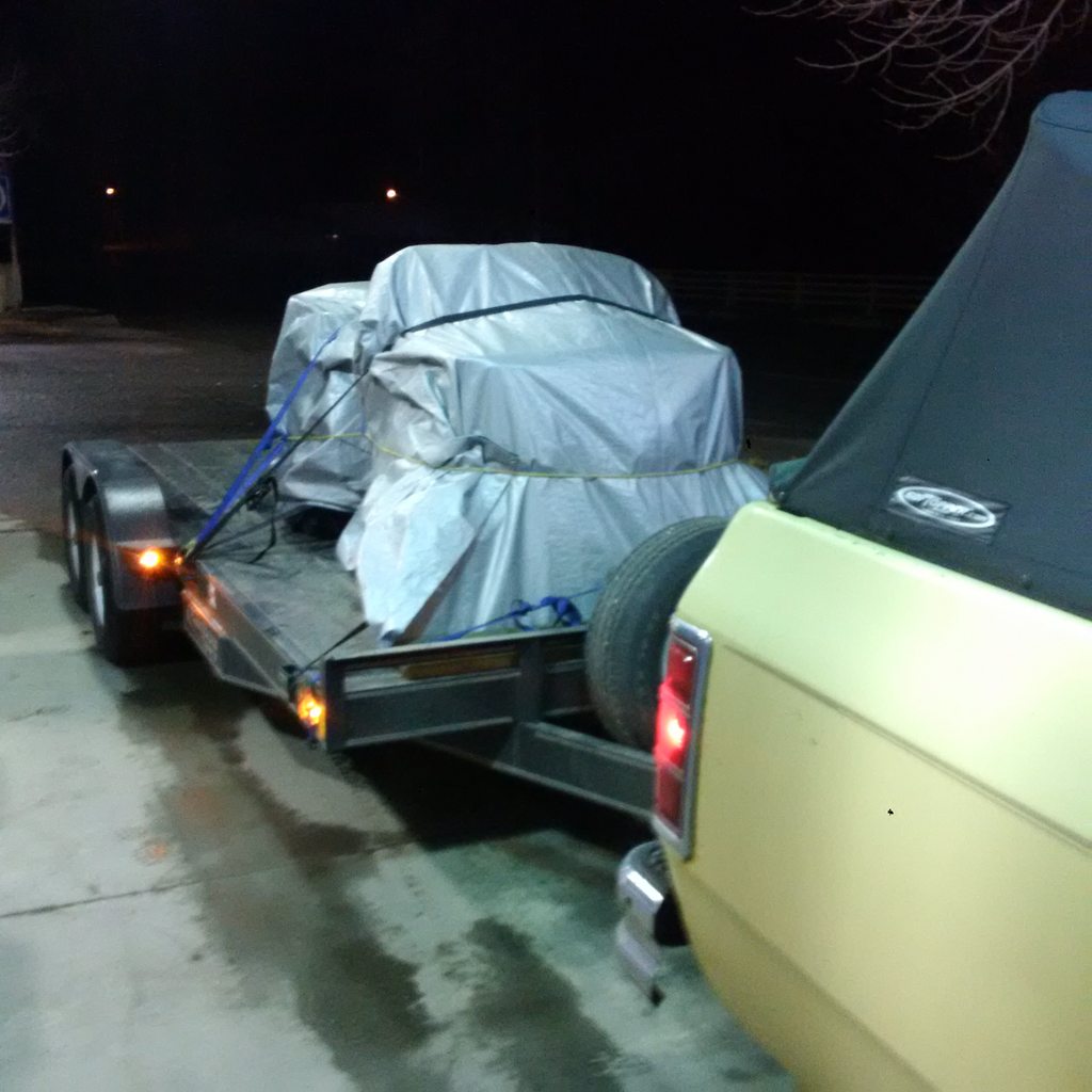

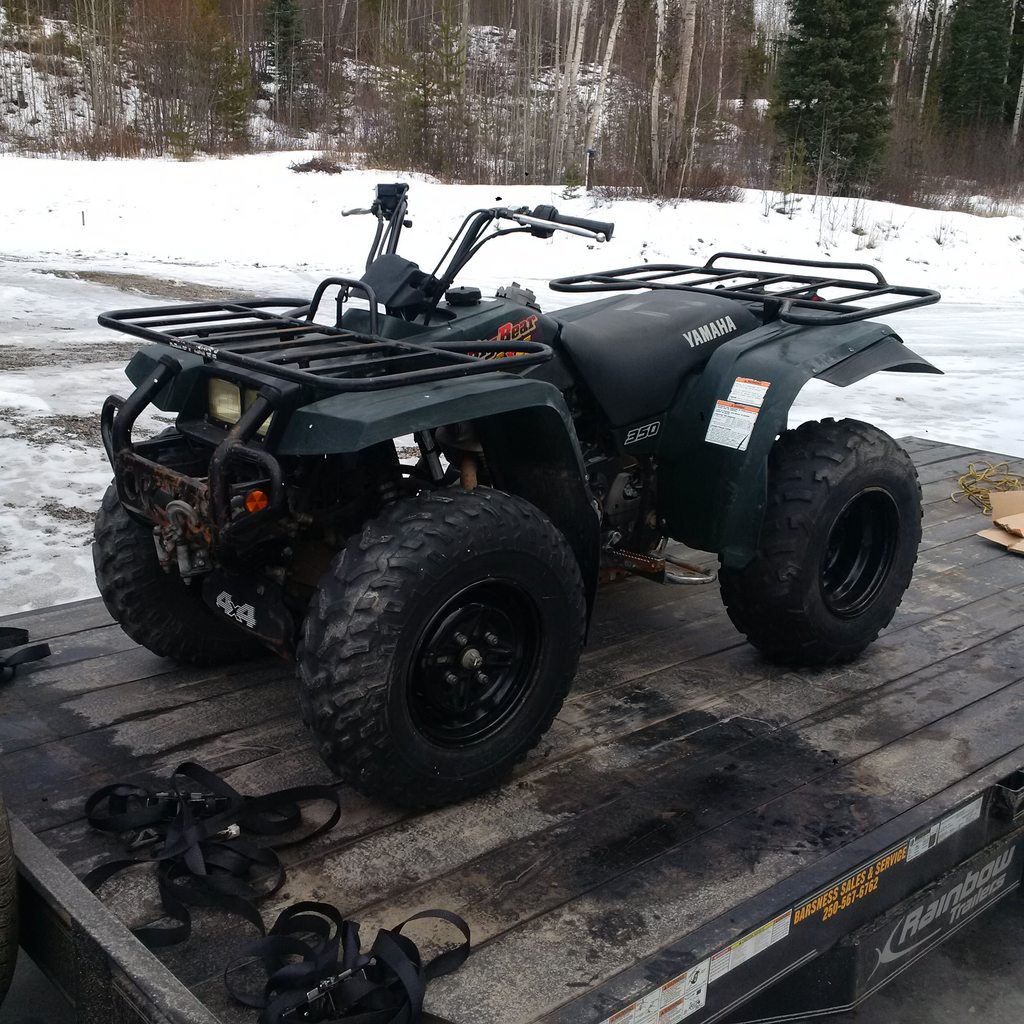

Drove 1100km's yesterday pulling my trailer to go pick up a quad. Been looking for another quad for a few months now but most local stuff is BEAT and over priced. Guy was selling a 96 Big bear 350, original owner and in amazing shape....only issue something internally in the motor/tranny went "ting" and there is metal in the oil. But motor's are easy to fix, and I got it for a great price.

So that will be my winter project...tear down quad, rebuild/fix motor and re-assemble. Should be fun since I have never worked on a quad motor before....love learning new stuff!
