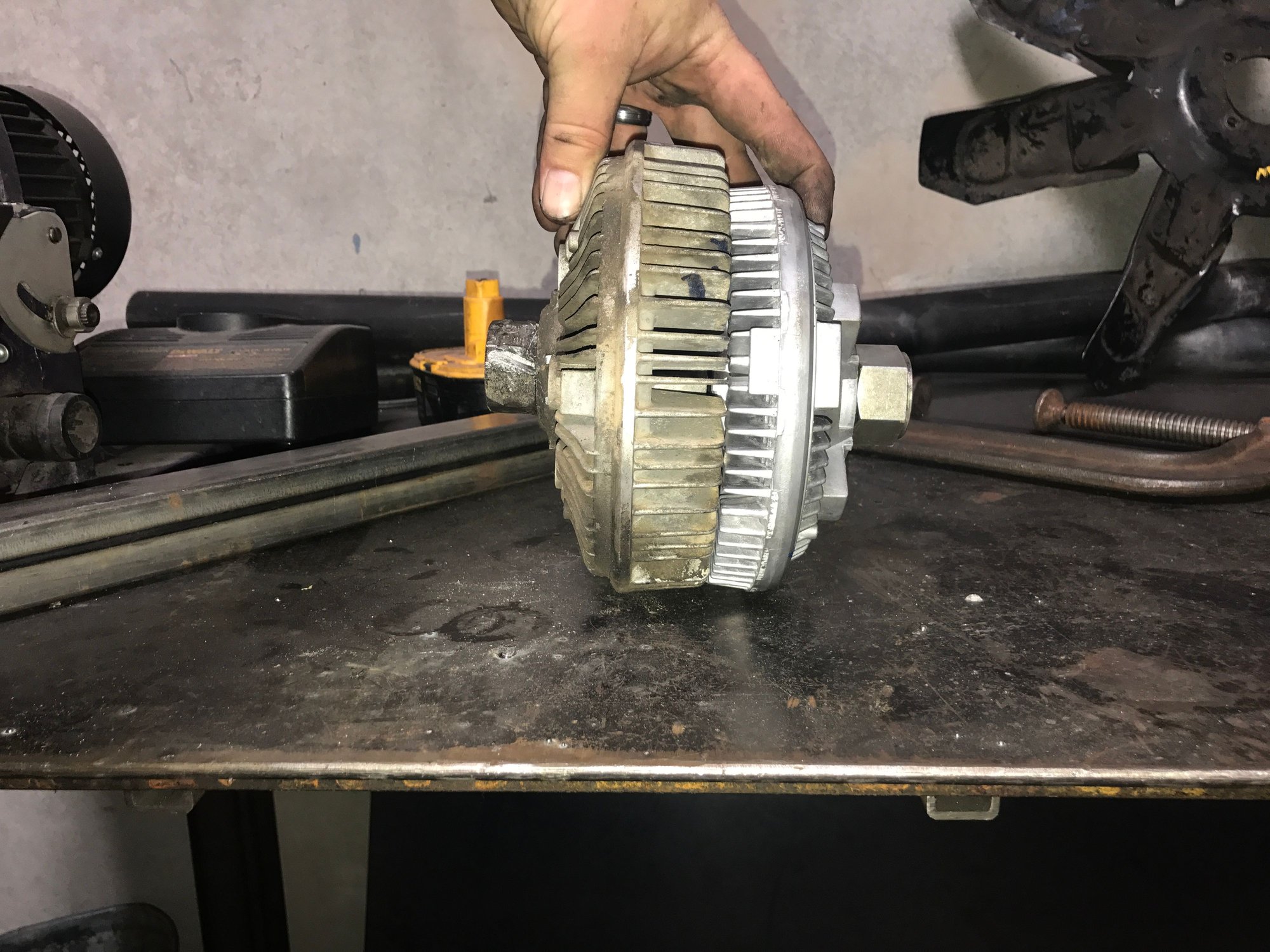

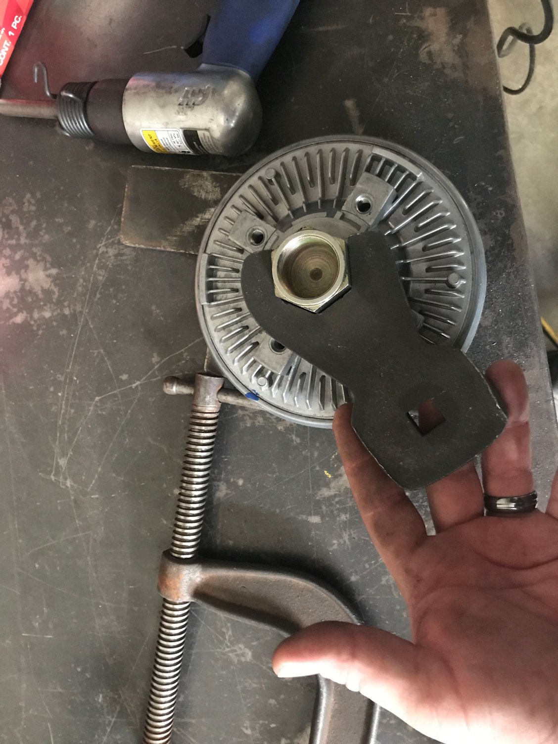

    I replaced mthe fan clutch on my truck (2nd Gen motor, radiator and intercooler). I needed a little more clearance between the fan clutch and radiator. The new one came from autozone. Made a wrench from a “nut wacker” (for removing air-cooled VW axle nuts) which happens to be 36mm and broached for 1/2” drive. The nice part about it is, you can hold tension with the breaker bar, and wack the tool with a BFH and it cracks loose with hardly any effort!

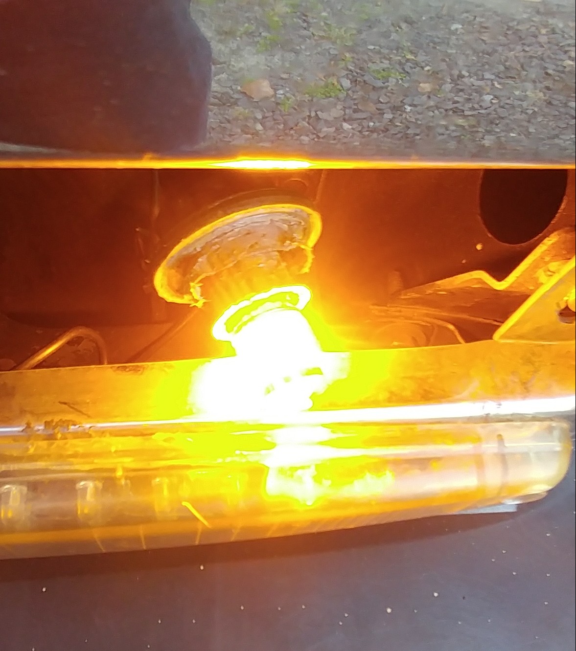

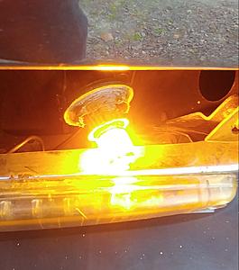

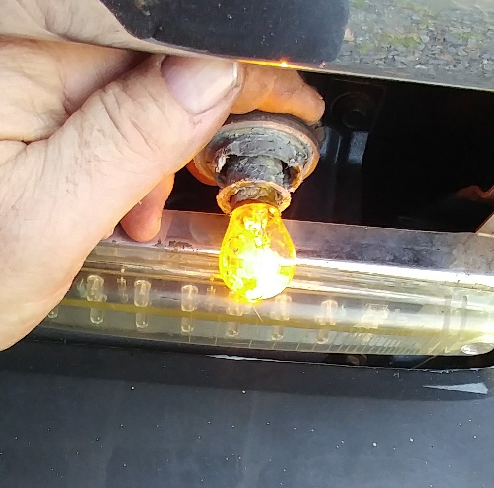

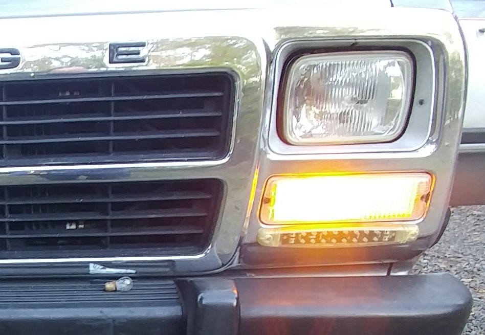

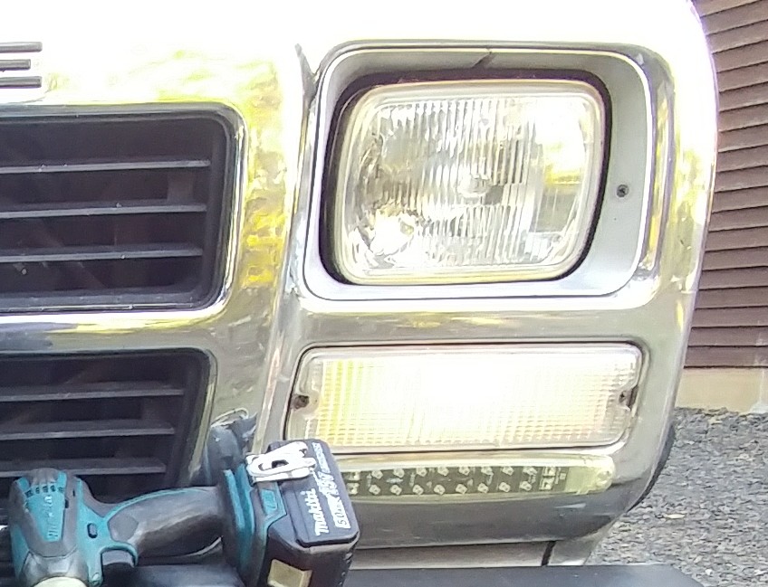

Put LED turn signals in the brick over the last few days. Amazing difference in visibility.
All worked well, until I changed the last front turn signal on the passenger side. Once I pulled the incandescent out, and put the LED in, my turn signals failed to work if the parking lamps are on. PUt the old bulb back in, and all works fine.
I need to put a resistor in there, or add another incandescent to the housing. Any thoughts as to which one needs it ? The parking light circuit, or the turn signal circuit ?
I can play around with it until I figure it out, but I figured I'd ask ahead of time.

Did you change out the flasher? I’ve got LED taillights from LMC Truck (which work awesome, even with the stock flasher), and haven’t swapped the front turn signal bulbs yet... I know when I bought the LED turn signal bulbs, they recommended a flasher with a ground wire attached to it...

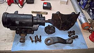

UPS delivered the parts for converting to RR steering on my W250 frame.
I already had the steering box bracket, but could not find the pitman arm.
Ended up buying the entire package from a gent in Illinois.

Have to say I'm a little bit jealous right now!

I've been using that type of electronic type of flasher since I purchased the truck 6 years ago. The only difference is the ones I have don't have a ground wire. I see its LED compatible. Maybe that's the key to it. I'll order one up today.
Again, everything worked normal until the last standard bulb was changed, then no more. Once I have a little time, I'm going to play around with it, adding either a resistor, or a standard bulb in line somewhere.

You will enjoy the new feel.

Before and after
