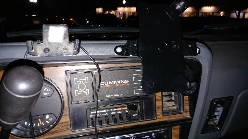

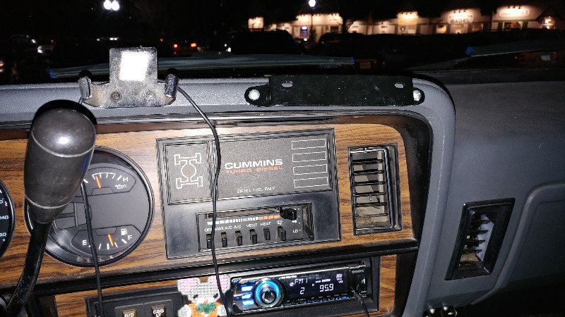

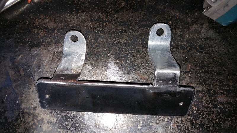

Made a custom cell phone hanger bar. This will allow me to hang my cell or tablet for GPS use.
Black of course

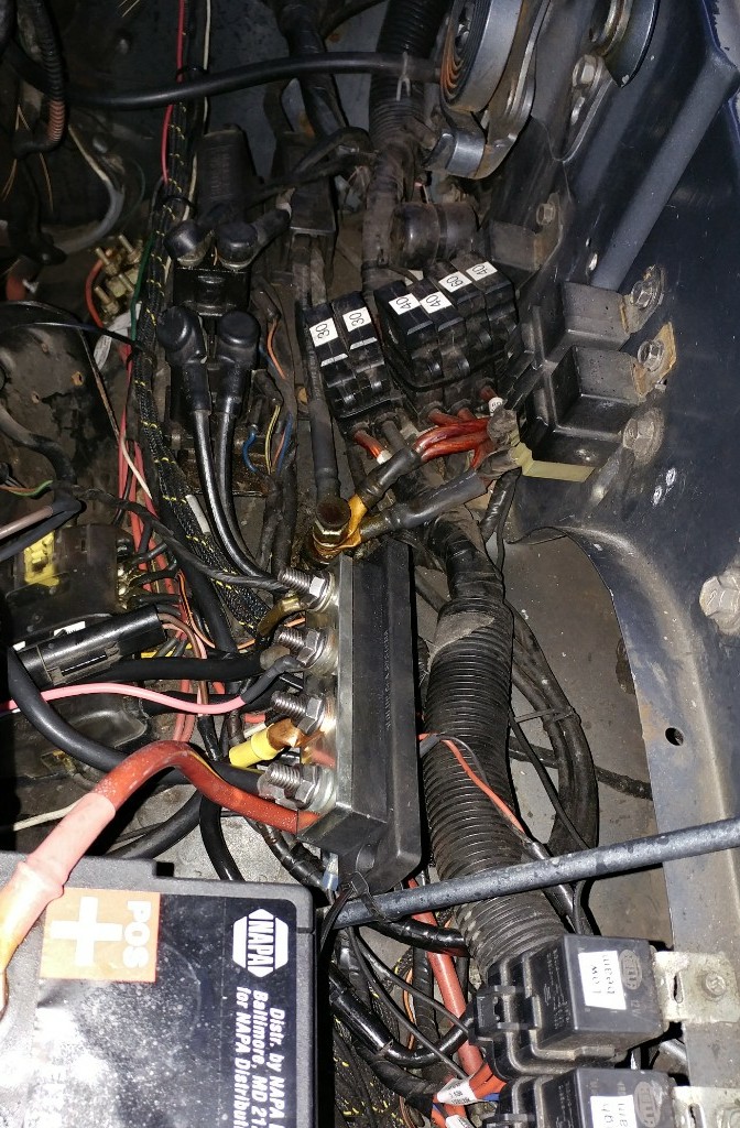

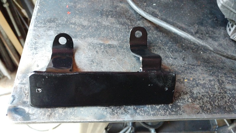

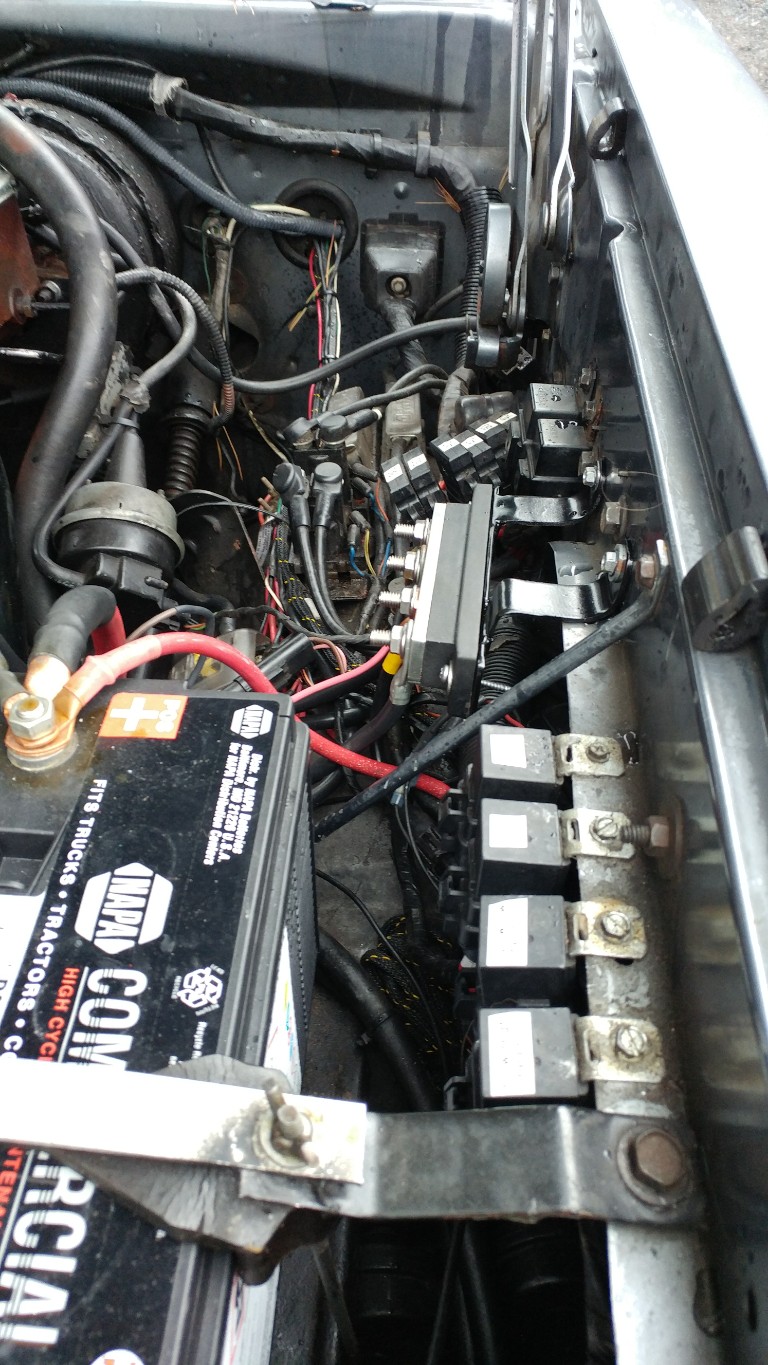

Custom bracket for under hood junction block

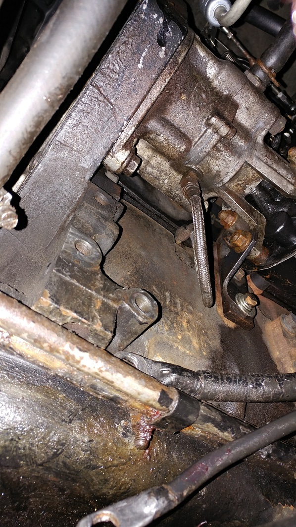

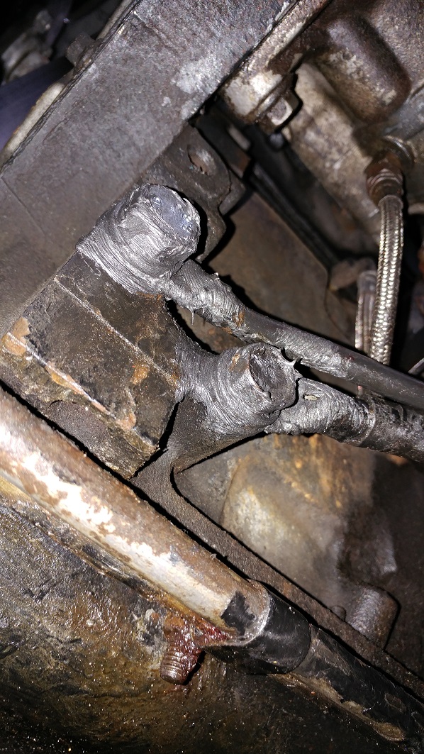

I guess this place is a bit quiet lately. -37C I guess has you guys frozen in your homes, eh ?
Man, that's freaking cold.....
A few weeks back I replaced the battery, converted it to screw post, but never addressed the other end of the wiring system.
How many of us ever do ?
After 2 or 3 years of being bolted on, it was a tad rusty. Cleaned up everything, used dielectric grease between the bolt, wire and block, and then coated it all with neverseize after it was all done.
Silly little maintenance things that keep this truck a running without much fuss...

Done...except for a rubber coverflap I want to make up
