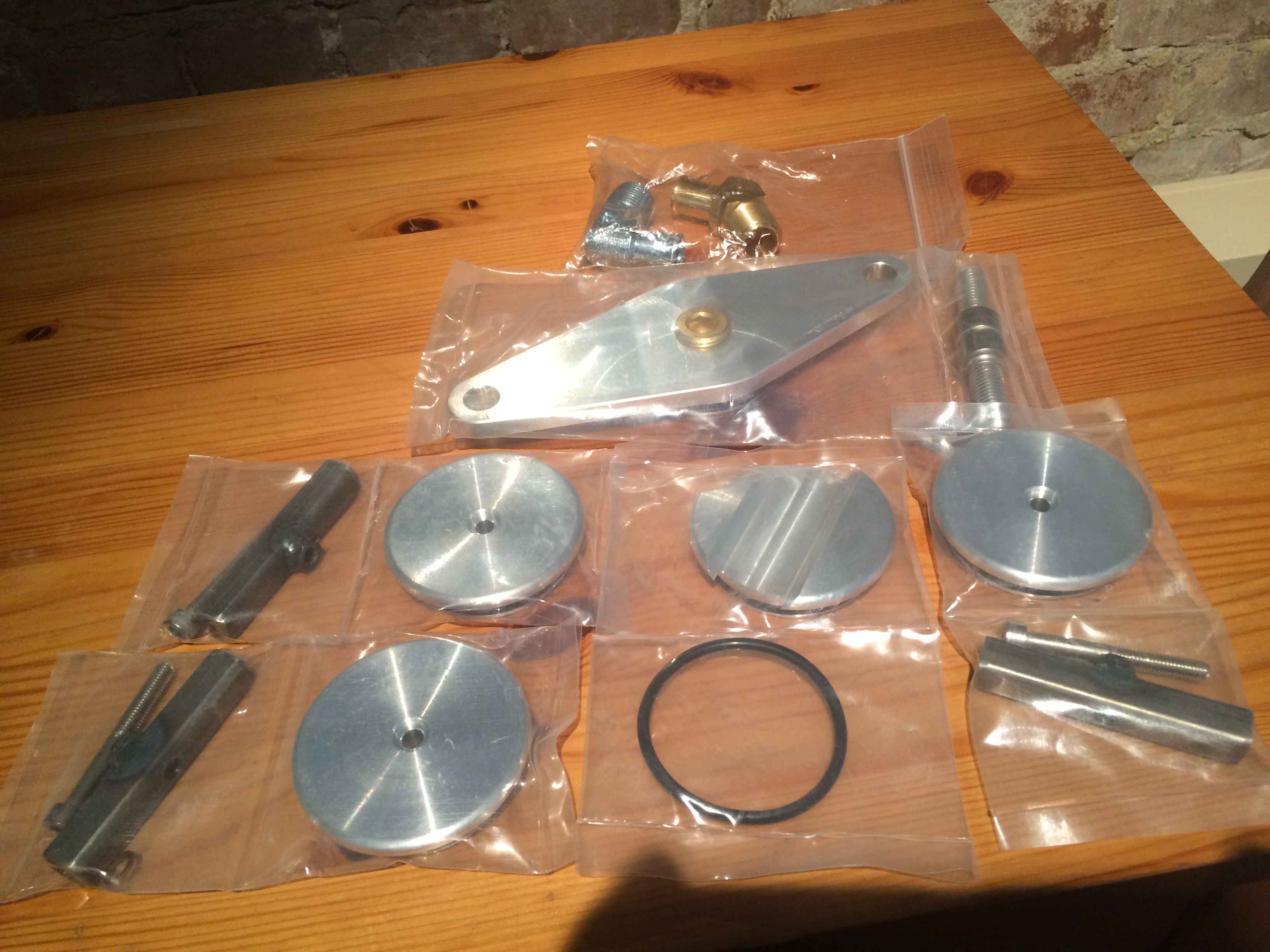

boeingguy you good man.
Keating bilit 100% aerospace spec, almost as good as NOS Mopar spec that make Cummins famous.
BC - I send you NOS 1993 Amsoil NLGI#2 grease for O-rings, never leak. You make trip up & practice install on my truck while I drink beer plz.
boeingguy - u plz send BC same custom SNECMA hydraulic fittings you sent me?
Originally Posted by boeingguy
first pulled out old rusty leaking freeze plugs.. then get proper aircraft approved 90* scotchbrite setup... then refurbish holes to proper surface finish requirements per boeing spec... then install bilit freeze plugs after applying boe lube to orings for perfect fitment and seal integrity. fill with mopar coolant (not 100%) , then continue driving many more trouble free miles .... i see in some recent pics , where these are seeping on many trucks , do your PM guys an gals..... all aircraft approved beyond 30,000 feet

fittings
Attachment 47188[/QUOTE]
which fitting? 90 degree brass? or 45 ?

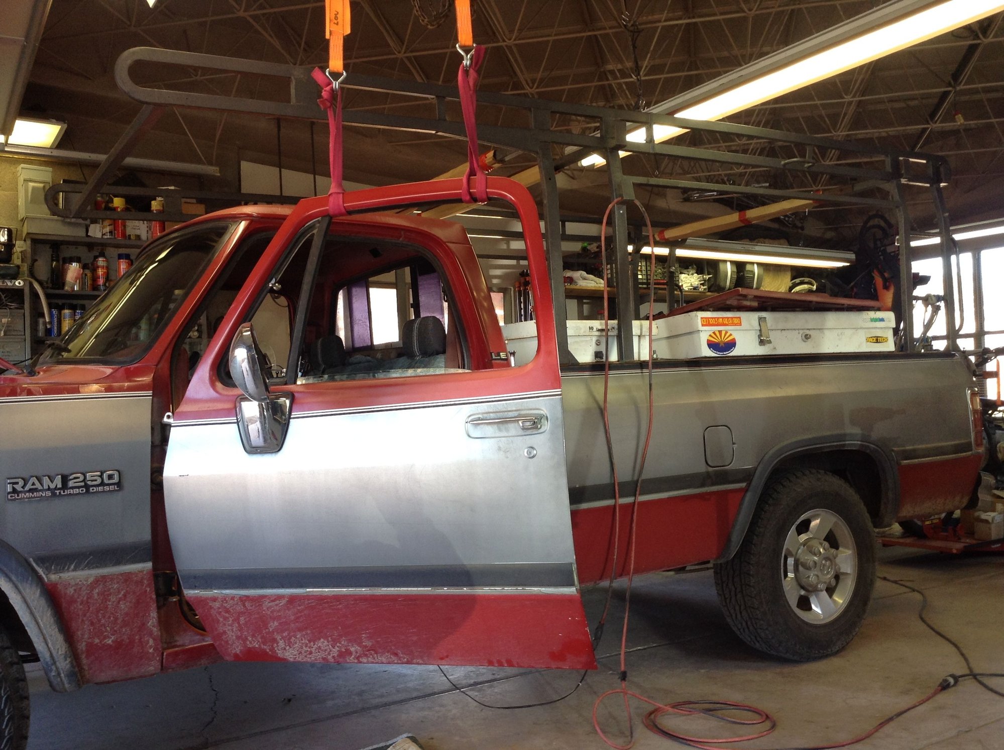

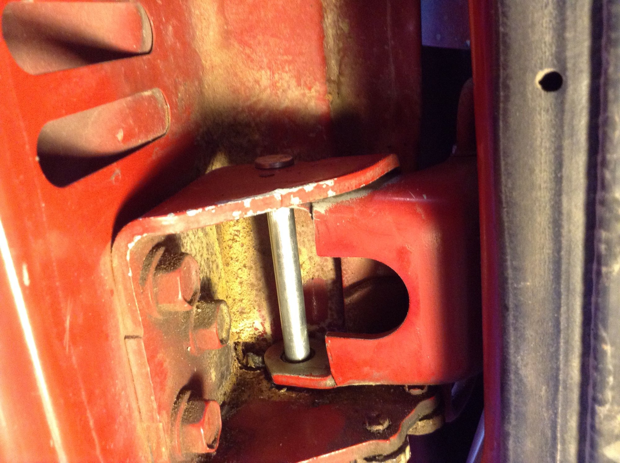

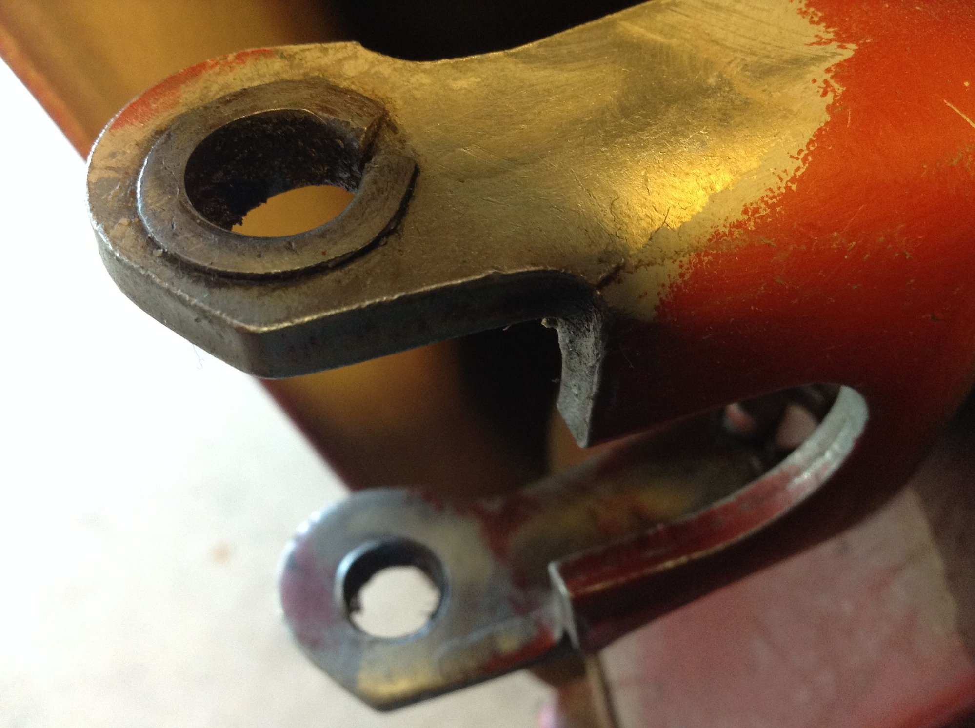

C
Drive old pin out with a long drift
Hinge pin out
Door hung for hinge pin replacement
Old pin out and old bushings exposed
Notice the wear and tear
Close up of old bushings
Close up of new bushings
New pin and bushings/upper
New pin and bushings/lower
Finished! Next...new rubber.

Ugh I need to do the door hinge bushings on my truck too.
Is the bottom bushing (on each hinge) put in from the underside or set in from on top like the upper bushing? I think I see it both ways among the pics?
