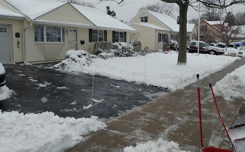

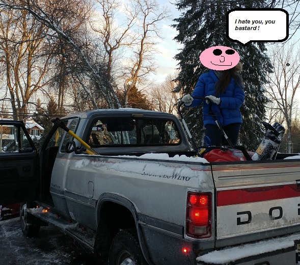

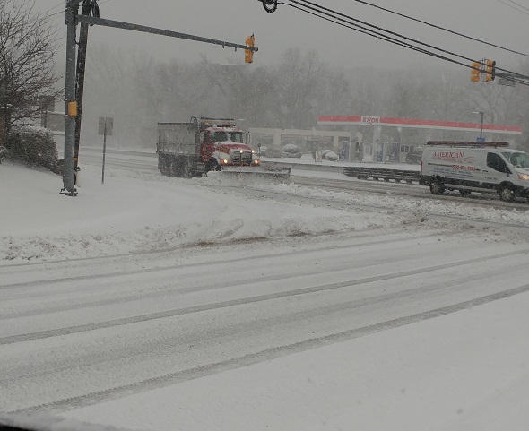

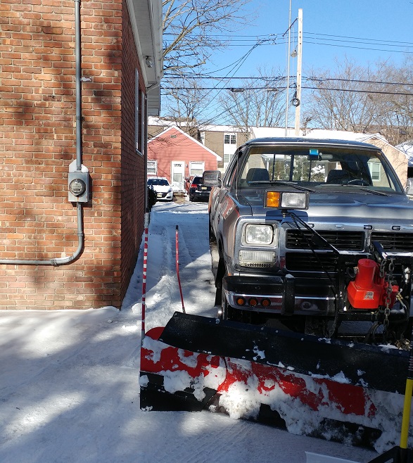

Did some snow pushing the other day.... 12 hours and the truck performed flawlessly except for the driver who was tired by the end of the day and tapped my fence post again...
So, the tailgate froze / busted (will determine this week), and the wife shovel-monkey had to help lift the snow thrower out of the back of the truck over the tailgate after about 6 hours into the day.
Man that sucked......

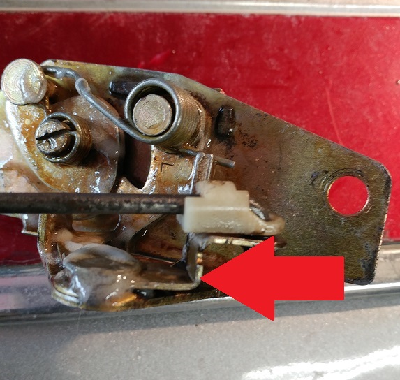

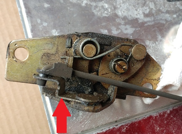

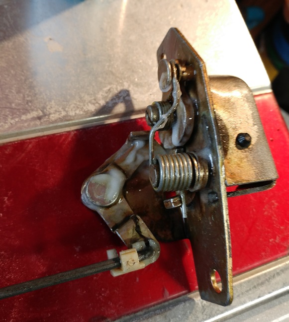

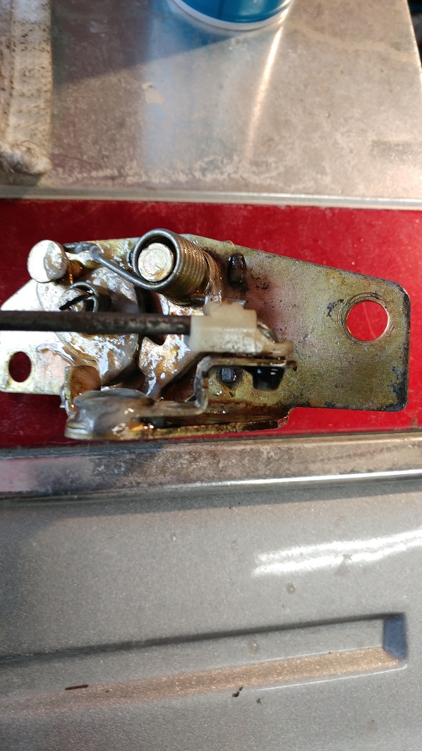

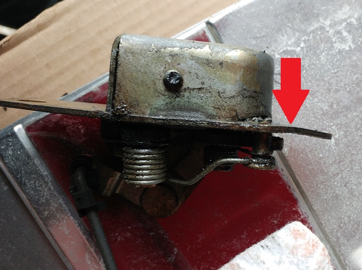

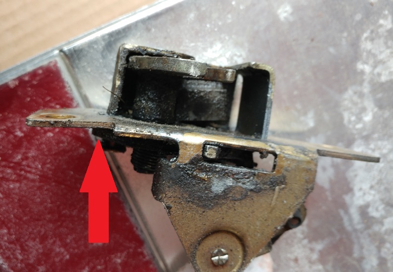

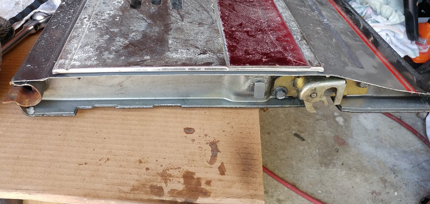

Got around to fixing the tailgate latches today.
Found out that when the tailgate has been opened and closed, slammed, punched, kicked and spat at, (kind of like what Geraldo Rivera's life was like) the years of abuse take its toll on the parts inside the body, mainly the latches. Today, I investigated...
The chunks of ice between the tailgate and my sandbag ballast cages prevented the latches from opening up the other day. This, with all my monkey muscles caused the little levers inside the latches to bend, making the distance longer than they should be to get the latches to release. In other words, the lever bent further away, which means that the limitation on the handle had been reached, which is why it required manual manipulation to open up the latches. The connecting linkage was just stretched a bit.
Cleaned up everything, re bent the levers and everything is back up an running. The plates which mount the latches to the tailgate body were tweaked as well, assuming that the tailgate had been stressed at one point or another by putting a lot of pressure on it while closed. this in turn compounded the issue.
Lubed it all up, reassembled, and works good as new....
