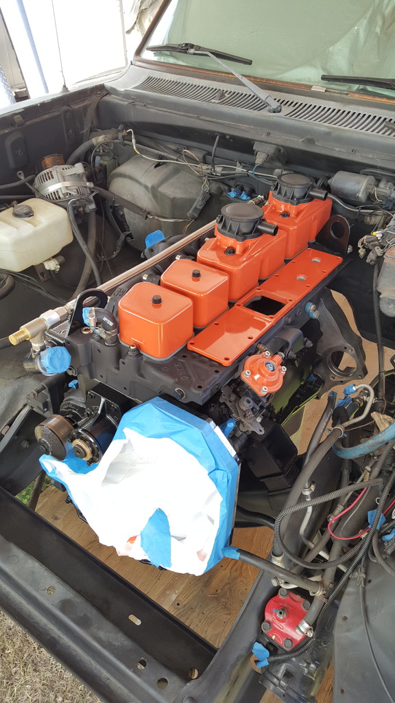

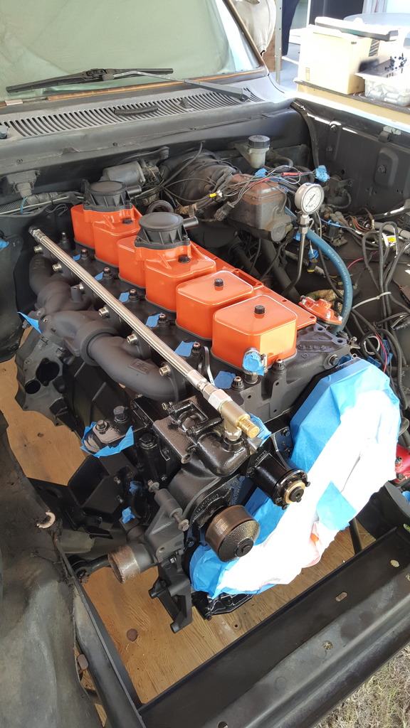

Been a while since I posted any updates. Huge progress made yesterday! WARNING: Picture heavy post. Not safe for women and children of any age.
I don't think you guys will complain any.
I whipped up a new length of stainless tubing for the rear of the coolant bypass. I bent the tubing a few more degrees than the previous piece and was able to suck it in closer to the head; giving even more clearance from the firewall and about 1/8" from the back of the head. Looks better running along above the exhaust flanges as well.

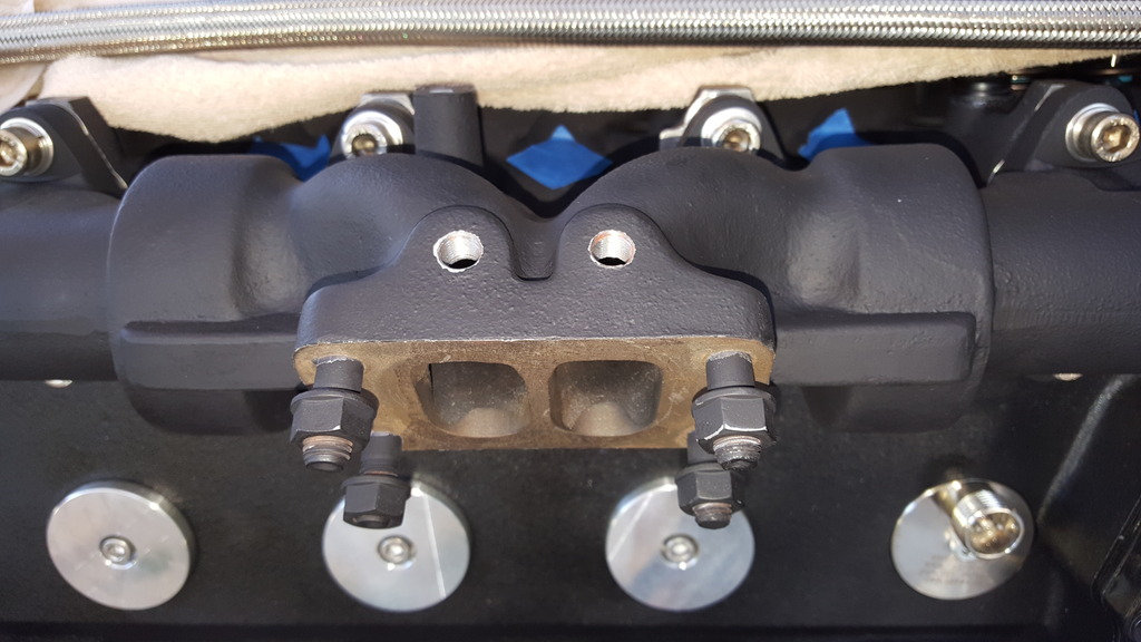

Drilled and tapped the front volute of the exhaust manifold to ultimately hook up a drive pressure gauge.
"Gentlemen, rest your sphincters!"
We have touch down!!
Lotsa room! Probably could've done without my fancy body work after all.
The beastly NV5600 got a new fork pivot ball and HD throwout bearing. All greased up per South Bend's recommendations.
Believe it or not, I managed to get all of that done in less than 12 hours. Along with wrestling the transmission into place.
Should move along quite smoothly from here!
