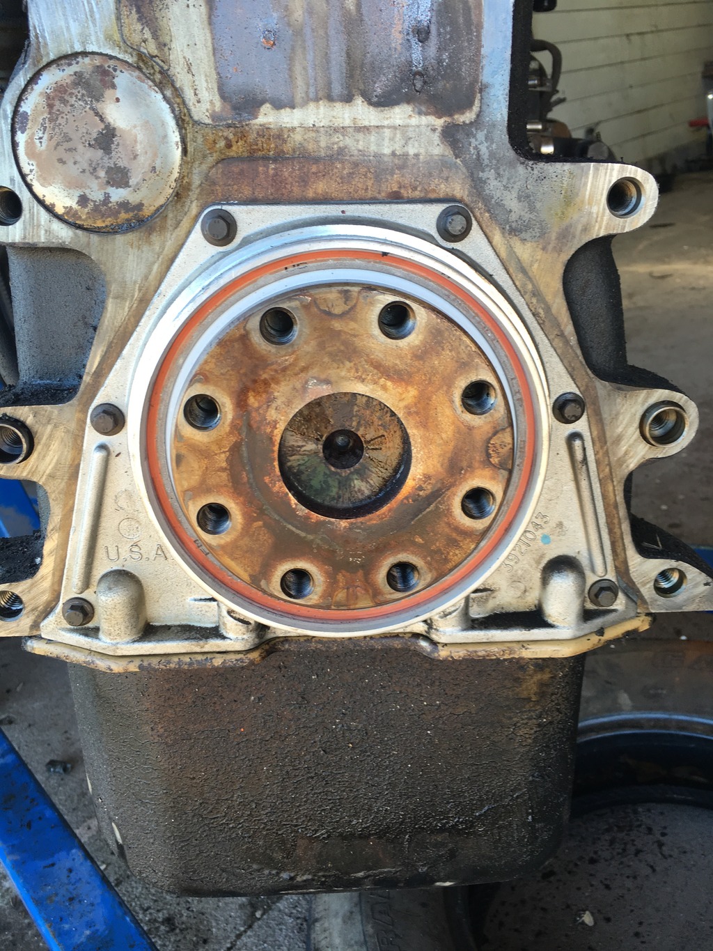

Well, since it's not in the truck yet, I can still claim that this is 1st gen related! Haha. Prepping the 12v for the swap project. Did a little grinding on the stock pin, installed 3200 spring, 2 turns in on the fuel screw, 3 turns up on the starwheel, smoke screw flush, flipped the idle screw around for easy adjusting, drilled and tapped afc cover for 1/8" npt elbow, skipped a tooth on the pump gear, tabbed kdp, loctite on case bolts, new front seal, rear main seal, oil pan gasket, fuel heater delete nipple. Then just stripped everything off to prep it for pressure wash and paint today.

and before i took the oil pan off and scrubbed it clean
