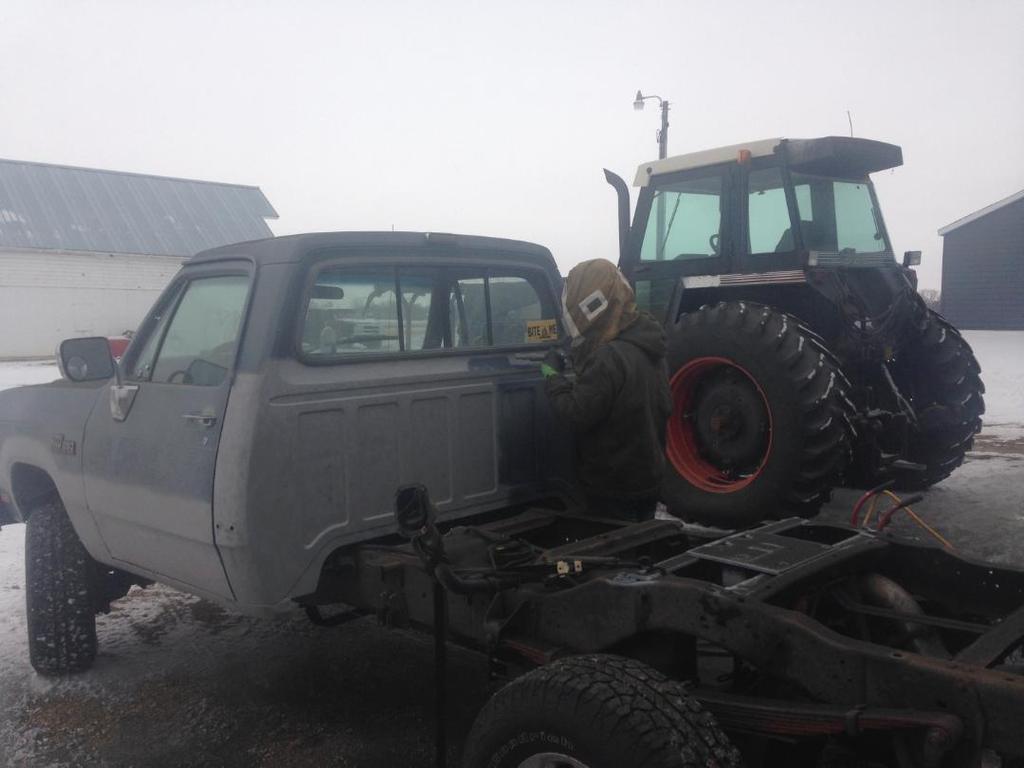

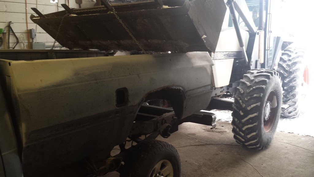

well, up here in south dakota, taking full advantage of my resources here. tractors, big heated shops, and every tool you'd ever need.
first day i got here we got that old rusted bed off

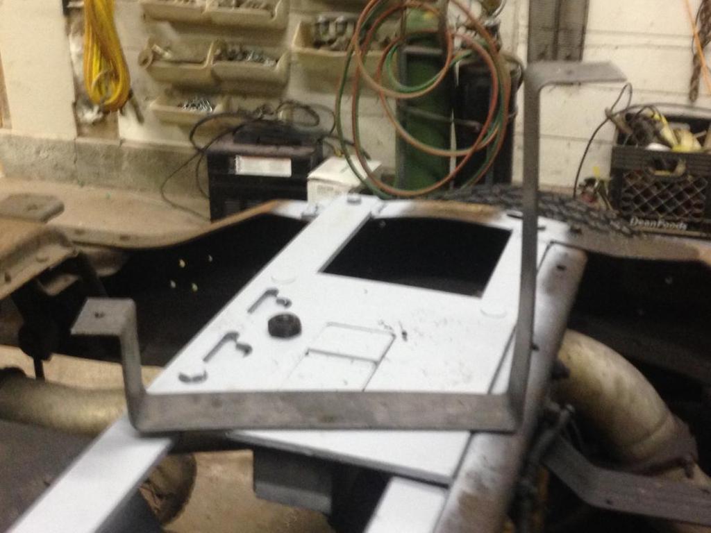

then i finally fixed the broken fuel tank strap. been secured with a ratchet strap since I bought the truck. bent this one from 1/8" plate.

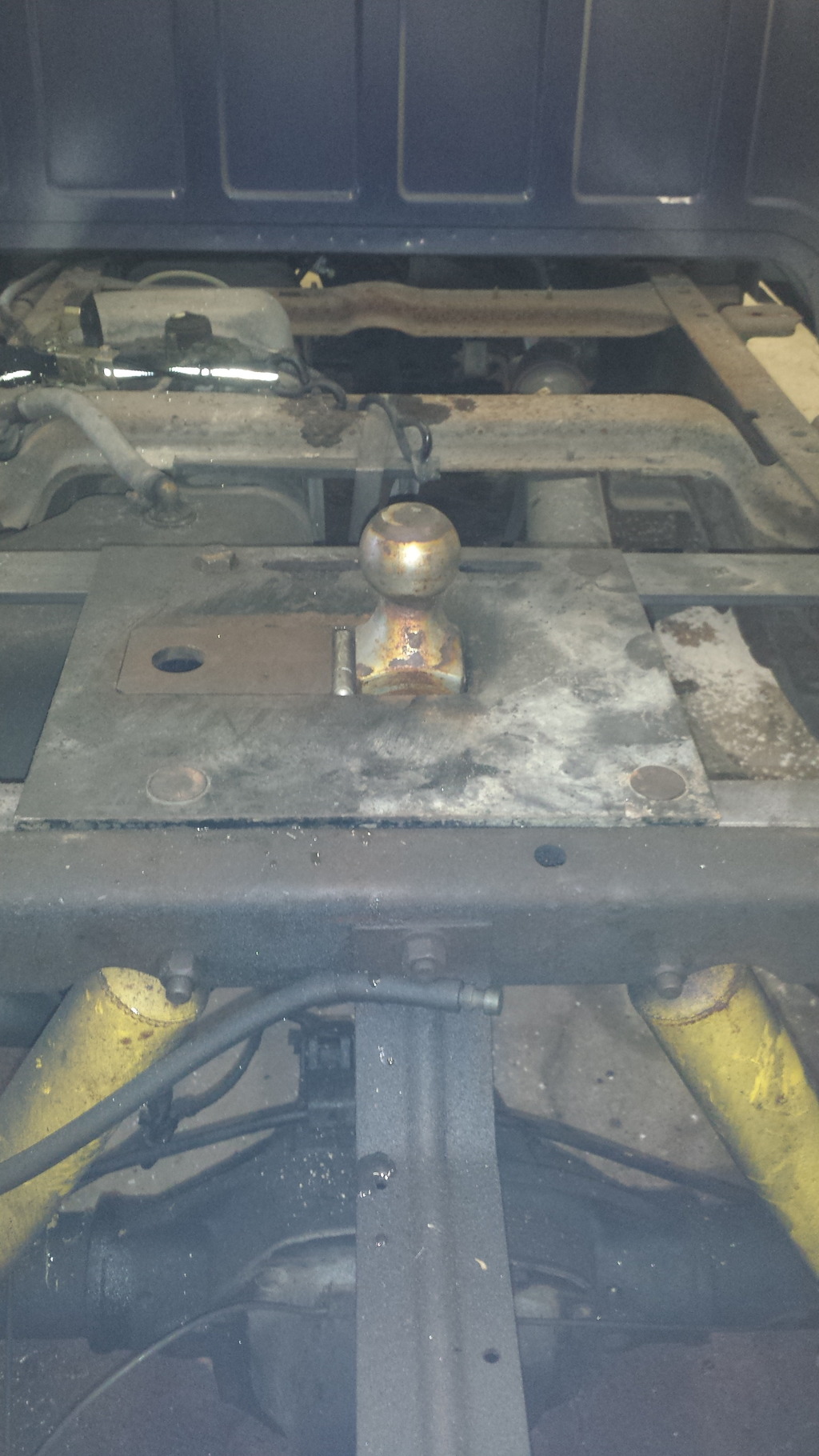

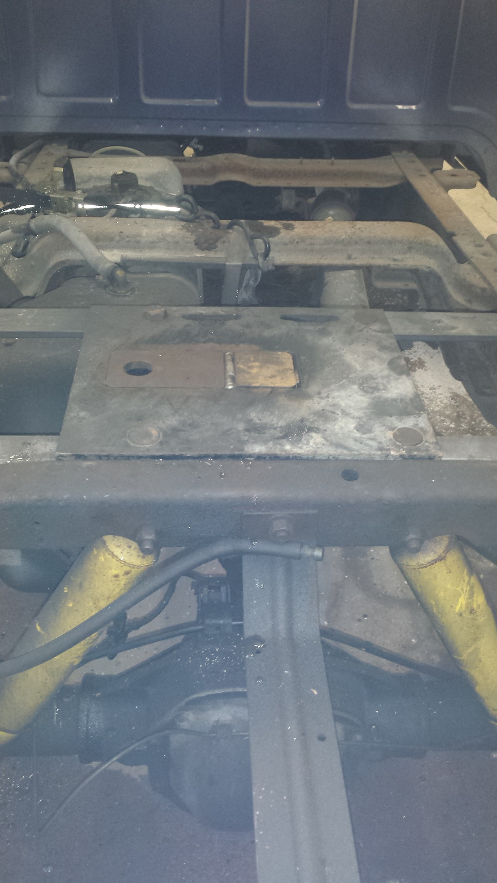

also made a hide-a-way gooseneck hitch. this was surface mounted inside the bed of a 90s chevy 6.5 diesel. used 2" x 3/8" angle from rail to rail. hooked up about 15k trailer to it as a test, works great!
