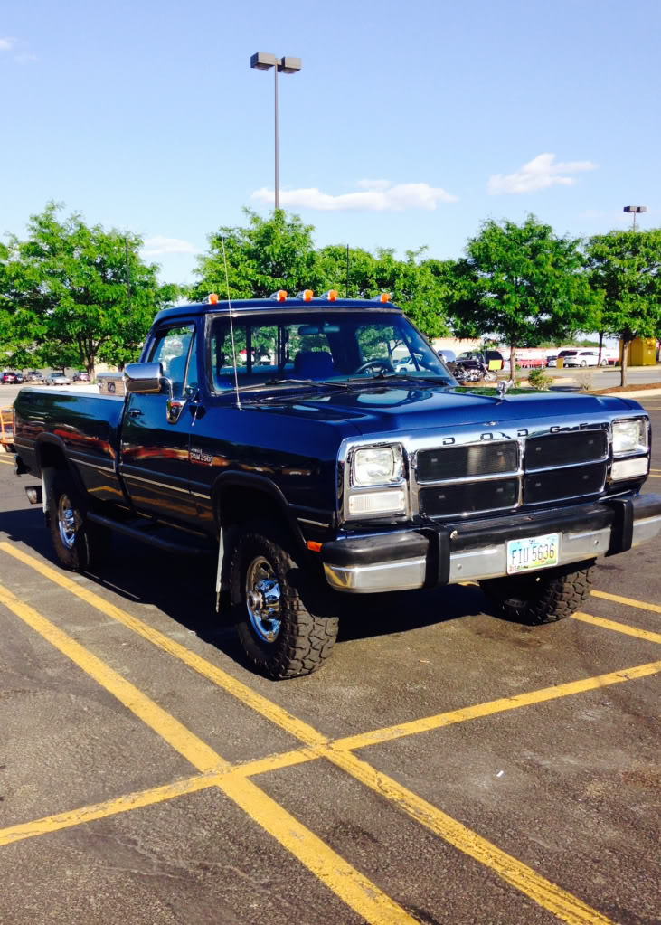

Jaybird1962's Avatar
Joined: Sep 2011
Posts: 99
From: Ohio
Cleaned her up today she need it.
Old May 31, 2014 | 07:16 PM
  #240
mknittle's Avatar
Joined: Aug 2013
Posts: 4,918
Likes: 603
From: Tulsa, OK
That is one nice truck!
