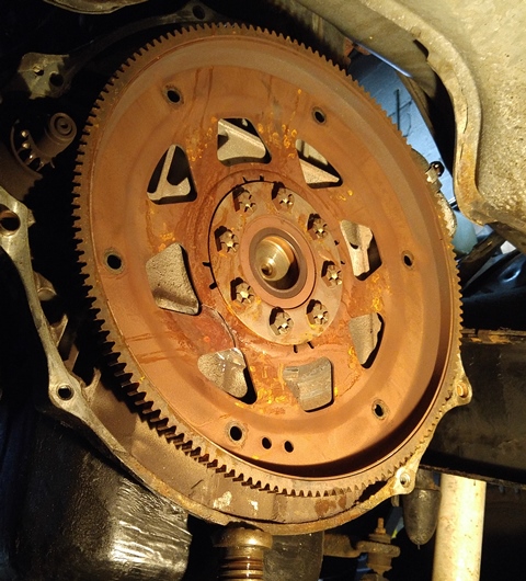

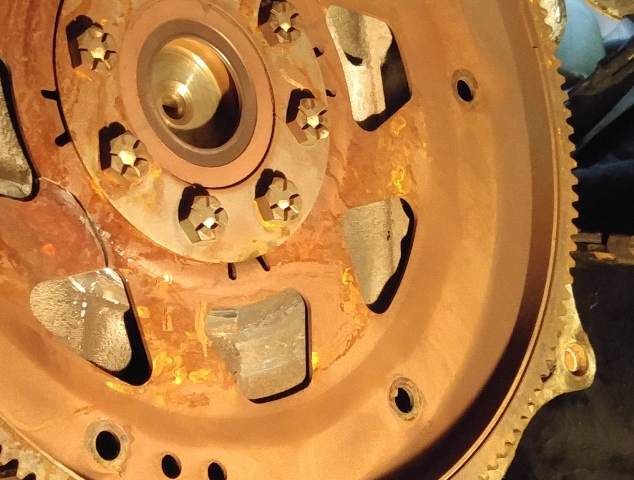

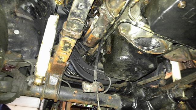

Well, I finished the brick, and it's back at home safe and sound.
I kept and used the flexplate from PRW, and I'm very happy I did.
When I took the old POC out I was FLOORED that the original one was so thin. I mean.... THIN!! If you put it up against Twiggy, it would have made her look fat. What a Joke..
Anyway, Minimal scuffing done on the flywheel housing (that's what Dodge calls the Engine Adapter to Trans plate). Glad it wasn't toast as I would have had to get in touch with Oliver to get a new one shipped ASAP. The original flywheel housing had a broken bolt in it where the exhaust hanger was, and one bolt missing up at the top of the trans on the passenger side. I guess when the trans was rebuilt the just didn't feel like putting it in.
So, drilled out the bolt, installed new bolt, cleaned everything up, installed the new PRW flexplate (which is at least twice the thickness of the original one... which means it will never fail with me using it), and put it back together with some new odds and ends such as dodge flywheel and torque converter bolts, some new bolts on the cross member, new shift linkage bushings, and coated just about anything that had any rust on it with neverseize. Painted stuff in the past, but it just all flakes off again...
Fun. (no not really) job..

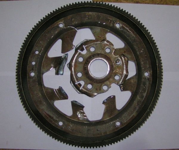

I bought my flex plate used, so the PO probably cleaned up the burred holes etc. which really don't make much difference in the scheme of things. What's important is accuracy in dimensions, and of course enough meat to stand up to the 5.9 CTD. For the price, I think this is a pretty good plate.
You still had 3 or 4 miles left in that one. This is what DW did to mine.
Thats crazy..
I cleaned up the burrs before install. The plate fit perfect. It had the proper spacing as required, so all went well
