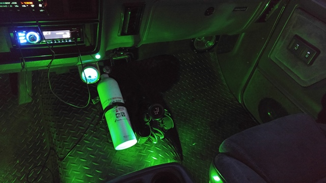

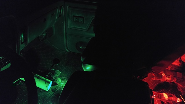

Finished my interior lighting for now.
green LED's in the front, and red in the back. I'm ready for Christmas

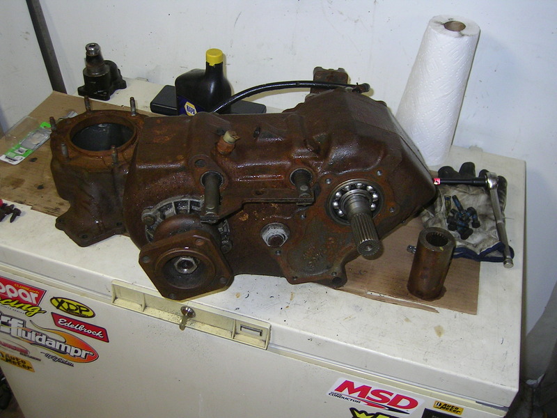

Went a picked up a 23 spline NP205 today....was too good of a deal to pass on!

Nice score on the NP205! I got one with the parts truck I bought. It's a good thing that you got the 23 spline coupler because they are NLA and as far as I know nobody reproduces them. I heard that there is a place that will custom make them for a couple hundred bucks.

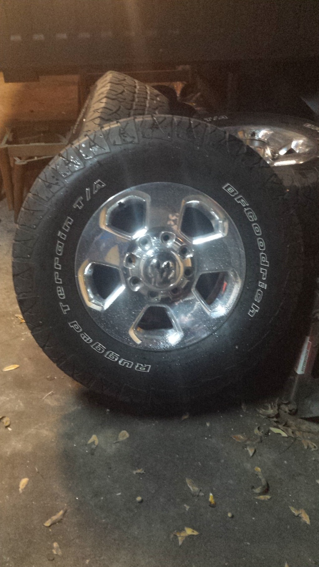

finally found some tires i could afford for my new wheels. 17x8" wheels from a 2014 power wagon. tires are 285/70/17, about 60-70% tread left, couldn't pass them up for the price. they'll get me through the winter. just needed something to last me until May
