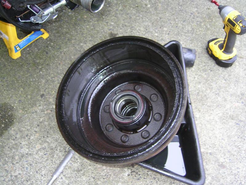

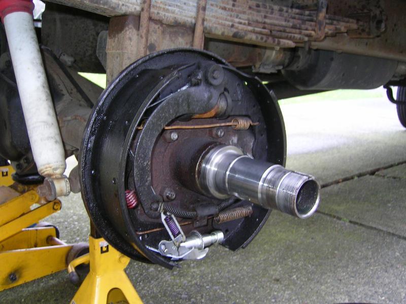

Well i redid the rear brake hubs a few weeks ago, new bearings and seals, but yesterday on my first day off in about a week I noticed that there was gear oil on the ground by the passenger side rear tire....Doooh!
So today I tore into it to see how bad it was....
All that oil everywhere...that can't be good.

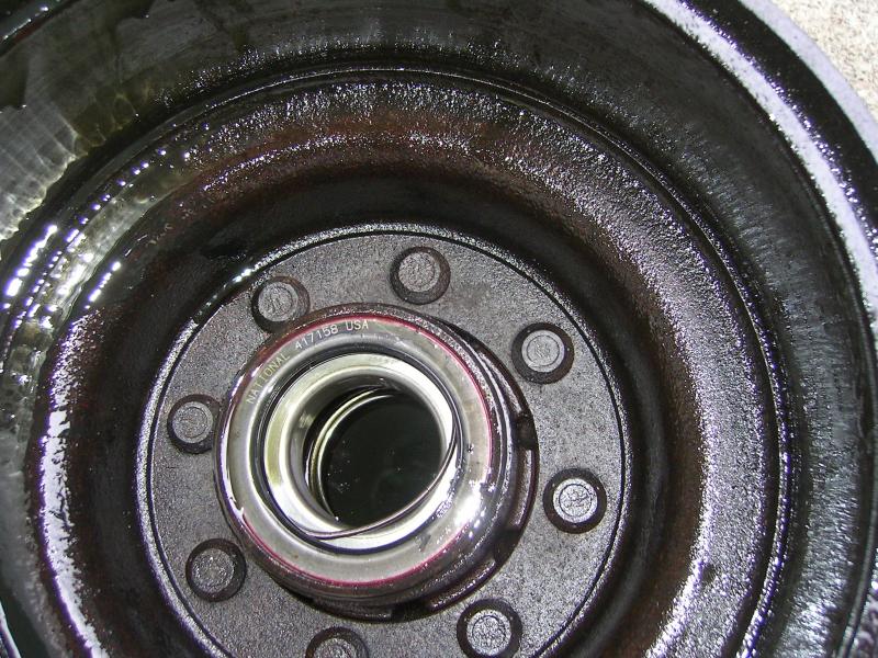

Turns out I nicked the inner seal on the threads when installing it. Gouged the seal and popped the spring loose as well.
And with all that oil everywhere the rear shoes were toast!
So off to the parts store for some new Wagner riveted 12x3 shoes, and SKF inner seals....Did not want to use the raybestos bonded units.

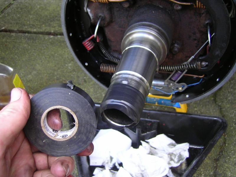

Lots of cleaning to get that gear oil off everything. But finally got everything clean up and start re-assembly. This time I used some black electrical tape over the threads to smooth things out just in case I get weak and wobbly trying to lift that drum and hub into place.
So it turned into an expensive day. Amazing what a small nick in a seal can end up costing you....a big chunk of change, and half a day.

Originally Posted by NJTman
Hey TC
There are TWO different seals spec'd out for our trucks with a very small difference in the seal size. The OD is the same of the metal lip, but the ID of the seal is different. Although you think they're going to work, they don't, as they do exactly what happened to you. One is TOO TIGHT vs the one that works, and it pops the spring out.
I learned this by trial and error, and wasting good shoes a couple times.
The drivers side was nice and clean and dry. So I know it was the nick in the seal and at the same time it popped out the spring. I had the right seals I'm sure of that.
But that is still good info to know.
Old Feb 14, 2015 | 09:50 PM
  #821
Posts: 6,837
Turns out that in the catalog that the 415009 and the 417158 are very similar, as they both fit the hub. The 415009 has a smaller diameter center hole and it actually fits the front hubs on the D60 axle. Somehow when I bought the truck, the 415009 was in there, and I replaced it with the same number. It failed a few weeks later. Replaced it again, and it failed again.
it wasn't until I actually looked up the seals in a national catalog, bought both seals, and test fitted them on a dry spindle right out of the box, before installing in the hub. They both fit, but the 415009 was just too snug.
Glad you got it all worked out..
Just think.... Your backing plate will never rust out now....
