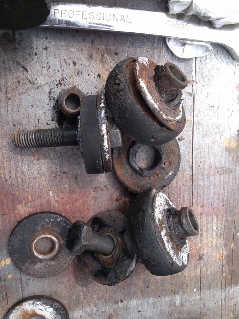

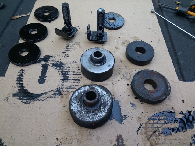

Originally Posted by diesel402004
stick to OEM rubber ones. Anyone know of place to get rubber ones still?
Bought mine at napa, but they're made for napa by anchor.
I epoxy coated the bolts, washers and ferrules. Didn't overtighten the bolts either, as you can overtorque them. FSM has the specs.

Beware that some of them are "boxed wrong" from Anchor. I purchased them, then had to get different ones again, as they were boxed without the ferrules or washers. You need them to do the job right, and if the box doesn't have them, they're wrong. Both sets were bought @ Napa. One box just was missing parts, and when they reordered them again from the warehouse, they came in correct.
Called Anchor direct, and they were aware of the mixup. Don't reuse the old parts, as you can see why below.....
