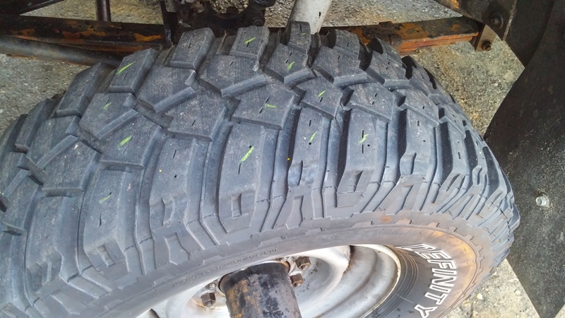

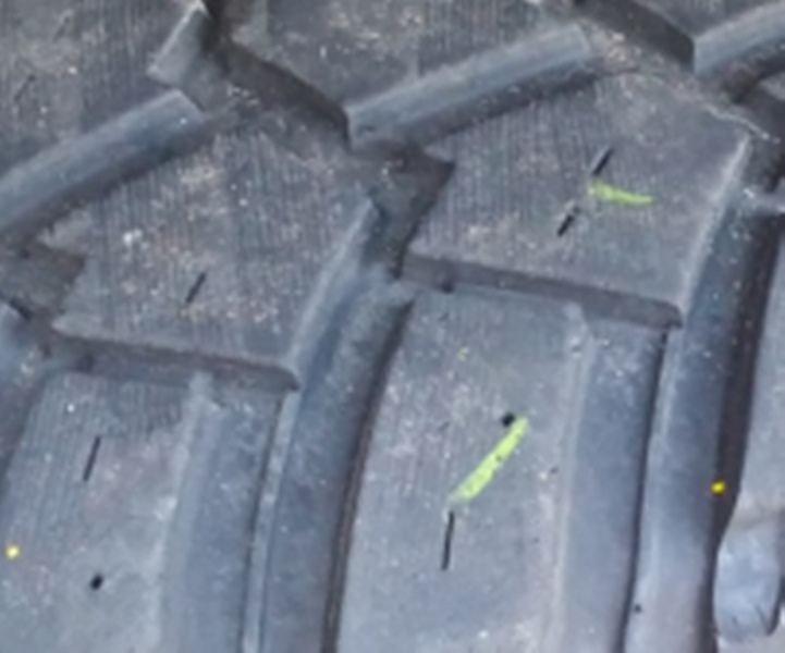

Rotated and Siped my tires today.
Don't understand siping a tire, than look at this.....
We'll see how it all works when the weather turns to crap...

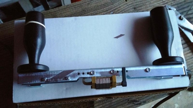

This is the tool to do the siping..

Siping is not needed if you buy the best tire in good better best scale.
that film you see is about as phony as you can get. both those slabs of rubber are made of 2 complete different compounds hard vs soft. Hard tires will slide easy. soft tire dont slide as easy. Les Schawb I wouldnt let them clowns fix the tire on my lawn mover.
I only buy the best tire never better or good. never has the tire peddler told or offered to sip my tires. while the guy in front of me he sold him on siping.

Have you seen one of those displays and picked up the rubber and felt it? I have and the ones I have seen have been the same rubber.
You are correct about buying the best tire, if that "good, better, or best" tire has a lot of molded in siping, you would be wasting your money to have them siped. For instance if you had a good "snow" tire you would be wasting your money on siping. But on a mud grip with solid tread blocks it will help.
With that said, siping is most beneficial on ice and wet roads. (Just like a "good" snow tire) Won't help much on dry pavement. The downfall to siping is if you frequently travel a lot of gravel or rocky terrain you will chunk out your tread.
I do not have any affiliation with Les Schwab or any other tire shop that sipes tires. I have in the past ran a set of Toyo MT's that were siped and after I had worn them out put another set on that were not, and my opinions are based on my experience running the same tires in the same terrain one set siped and one set not.

Thanks Bob
4 year old. Mudders (winter use only ) and i wanted to see if the siping works or not. Dont have the $ for new tires and this is my way of seeing if the process really works or not. Dont have any les schwab around here, and i could care less bout the video except that it explains the siping theory. Never heard of siping before i read about it a few weeks back.
Either it will work or not. A good learning experience either way

About 10 years ago I bought a used truck with fairly recently installed by Schwab their top of the line house brand (Multi Mile) Wild Country XTX that were also siped by Schwab when new. They had about 5k miles on them and chunks of tread were coming off. I took it into Schwab and they said tread chunking had nothing to do with siping and the chunking was due to driver abuse and poor maintenance. I bought the truck from a grandpa type. Schwab offered no warranty. The fractures in the rubber were right along the sipe cuts. I called Multi Mile and they said all warranty is managed by Schwab and they would not normally warranty tires that were siped. I tried to contact Schwab HQ in Oregon but it's easier getting Obama on the phone. I drove the tires for another year and watched chunks of tread regularly come off. Later Spent $1100 putting proper tires on the Mopar.
The only tires I'd sipe would be take-off desert military tires (Michelin Xls come to mind) and would not be on a car seeing regular street duty. To each his own.

I had a set of Mud Kings on my old Ford truck and they were pretty worthless in the snow. Siping would have been a good option but I ran chains instead. I bought them cheap froma local trucking company after they were taken out of service on their rigs. They were fine for my purposes.

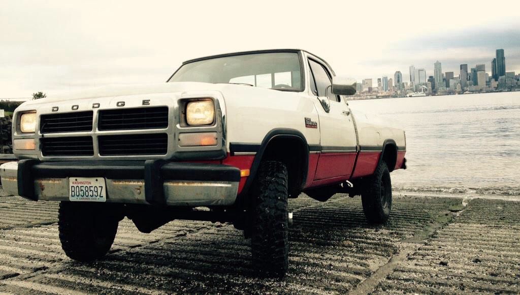

Installed 255/85r16 Maxxis. Handles a whole lot better than the 285 BFG that were on it.

Looks like your at the armeni ramp
