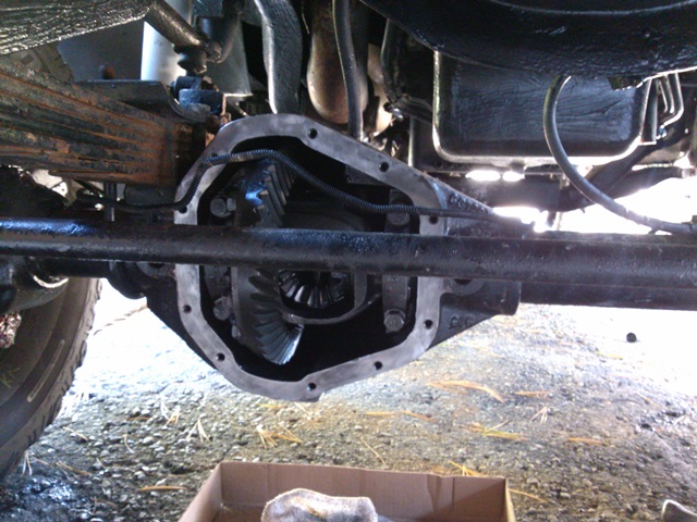

Changed the gear oil in the front diff today.
The rear diff will get done sometime later in the week.
