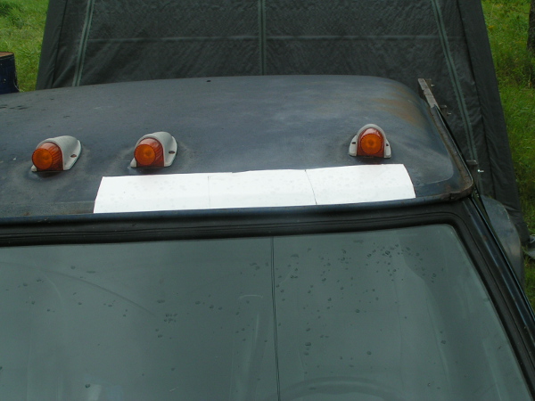

Fixed the leaky roof. RV sealing tape. Worth more than the metal it's on.

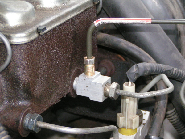

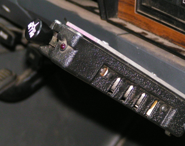

On the camper towing truck, replaced the "pendulum and guess" brake controller with a past era Kelsey hydraulic actuated one. (81740B) Mounted it so it's actually usable from a seated position.

I haven't seen one of those in a long time.

Bought 3 of them, a plain, A, and B model on EvilBay a year ago. They're getting pretty proud of them since MaxBrake et al took a dive.
I'll have to put a series resistor system in with it to compensate for different trailers. I'll use a .25 ohm and a .5 ohm, with bypass toggle switches. The combination will give me 4 max force settings with the switches.
Towed the boat with it Saturday. Smooth braking fer sure. Hardly notice the trailer is there.

You didn't buy the vintage appropriate compensating resistor (with the wing-nut & sliding clamp)?
I can't believe folks use anything else, to be honest. (I guess they use too much volume for modern ABS systems, but even so)
I have mine mounted vertically in the dash, next to the radio, but your install looks a little cleaner & more normal. Well worth the effort!

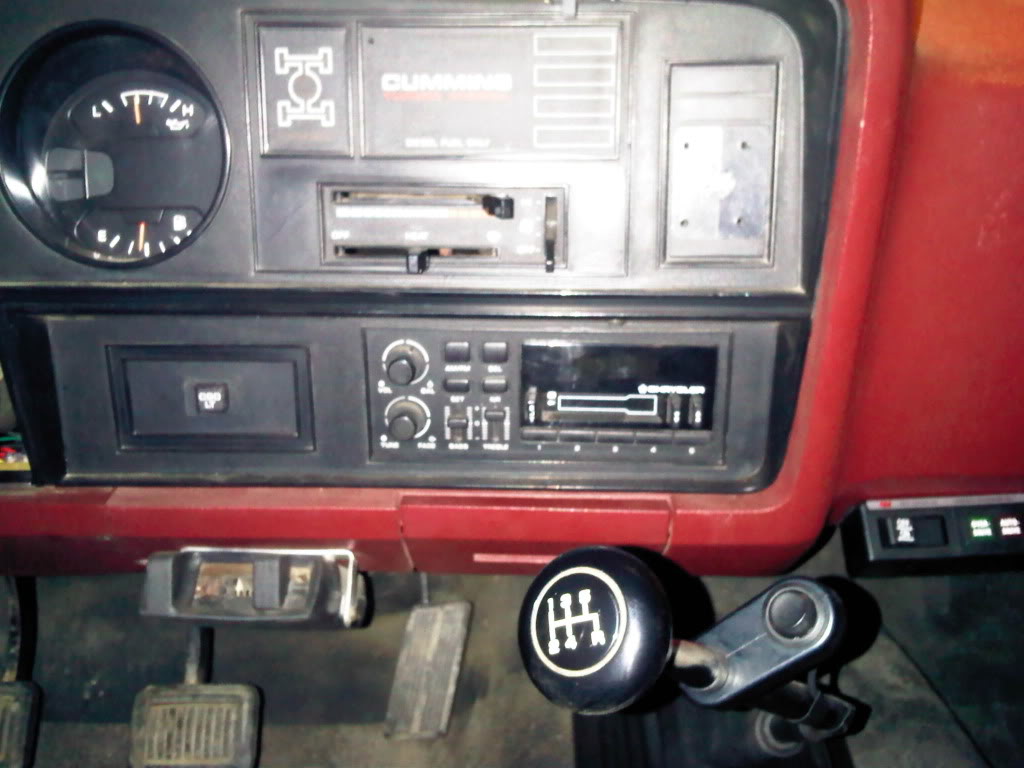

So what is the advantage of the hydraulic sensing type? more linear? I have one on my truck but i have issues with my 7pin connector so my trailer brakes don;t work half the time lol.
I really need to fix that 7 pin, trailer lights are not working great either.
Can be seen in this pic, different than yours but still has a hydraulic line hooked up to the master.
