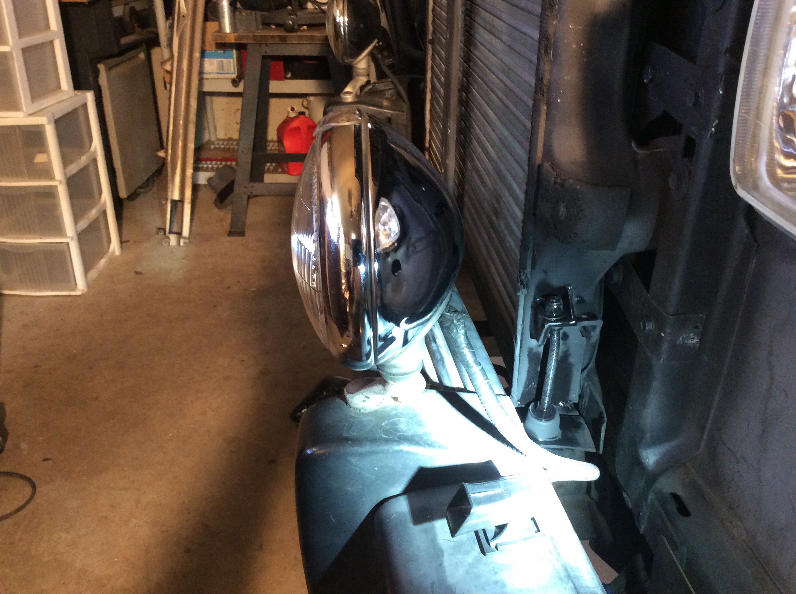

Finally got around to fixing the bracket on the drivers side, holding the powerstoke intercooler I put in awhile back. All thread, lock nuts, and a rubber isolation bushing.
Also, while I had the grille off, re tightened the 1/4" wire mesh over the intercooler, to keep the large bugs at bay from kamakazeing into my intercooler
