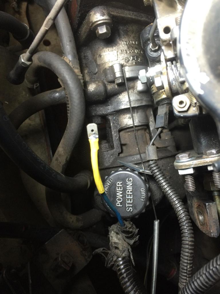

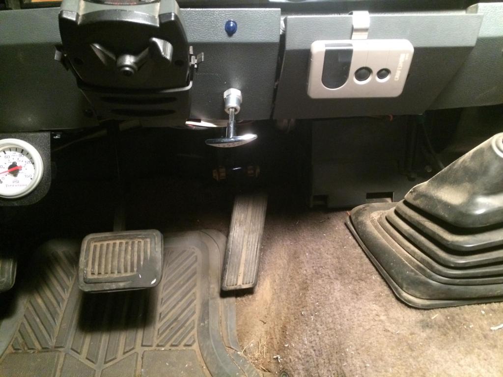

today I cut about 6' off of this because it was the only one napa had in store with a turn-lock function. they also offer a 5 footer of the same variety, as well as many others in their catalog to choose from.

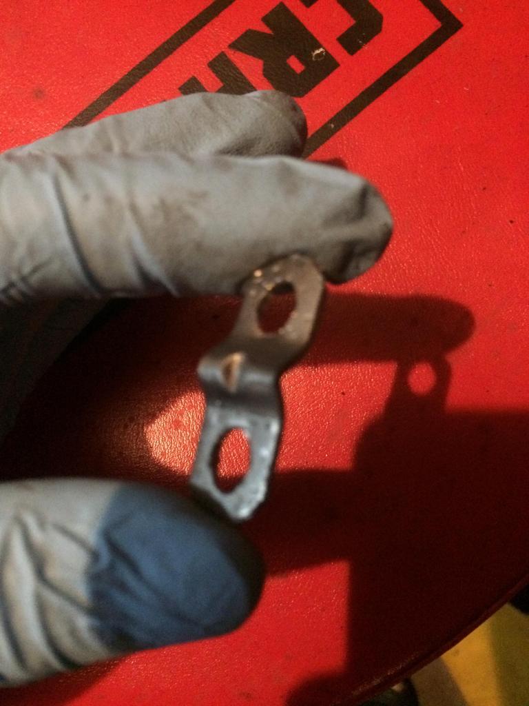

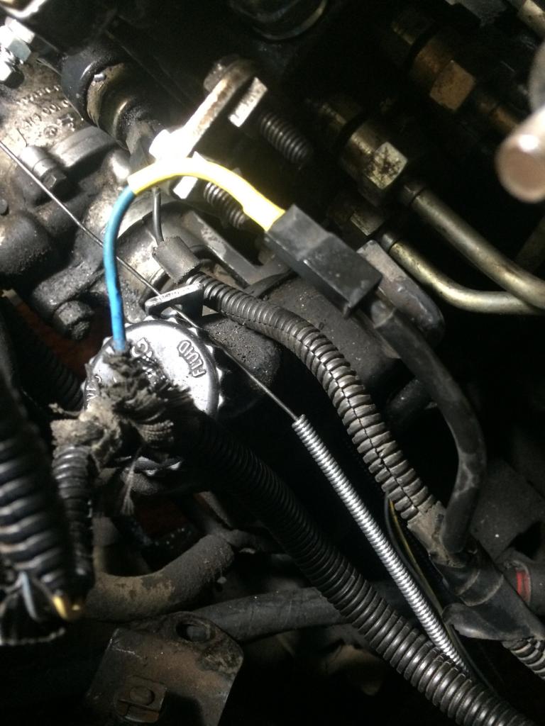

the process:

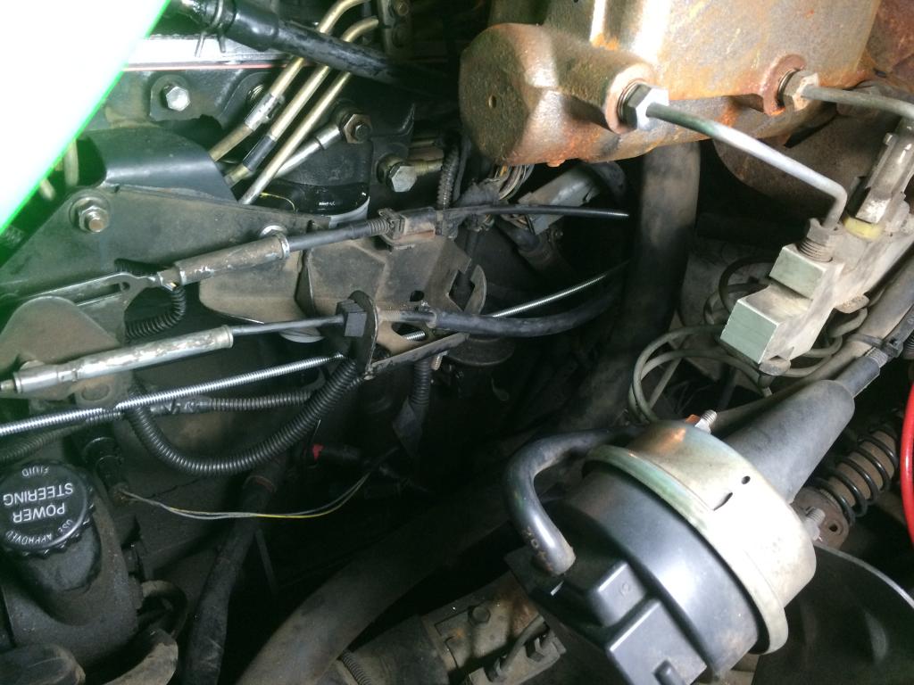

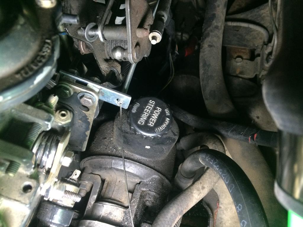

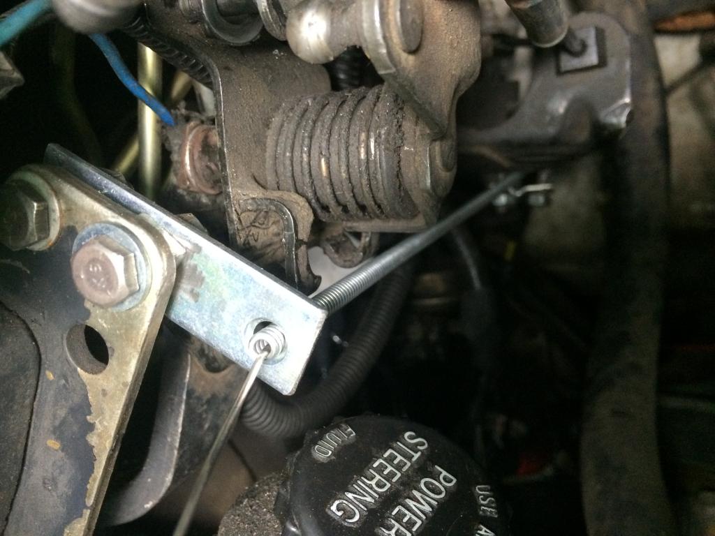

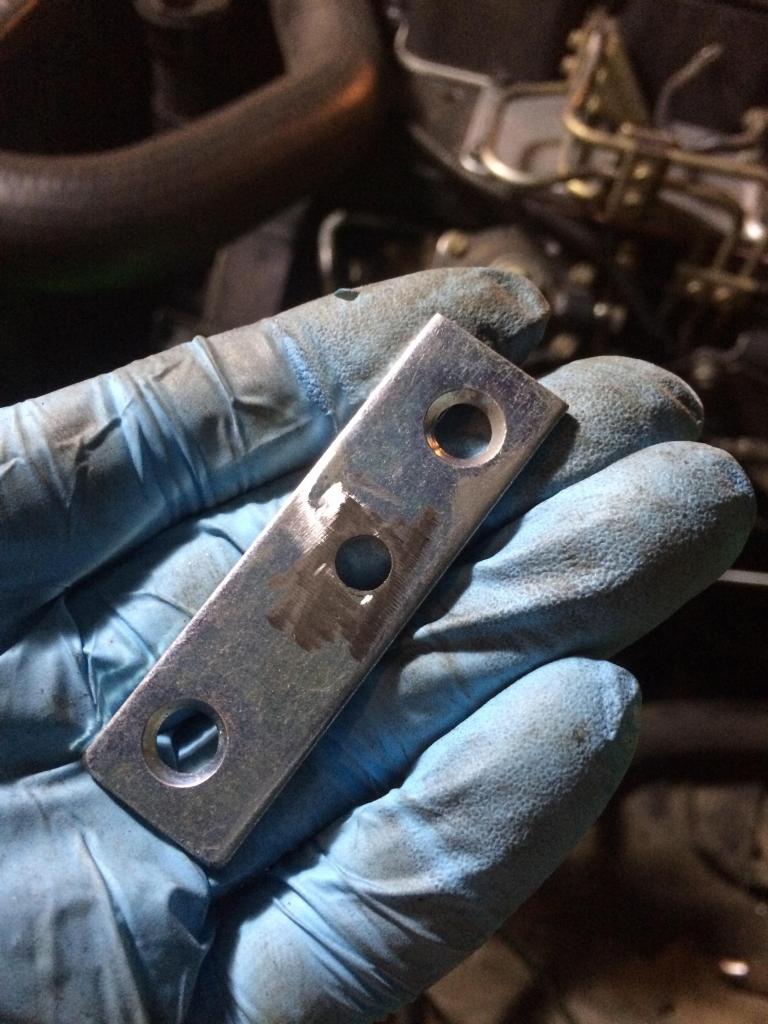

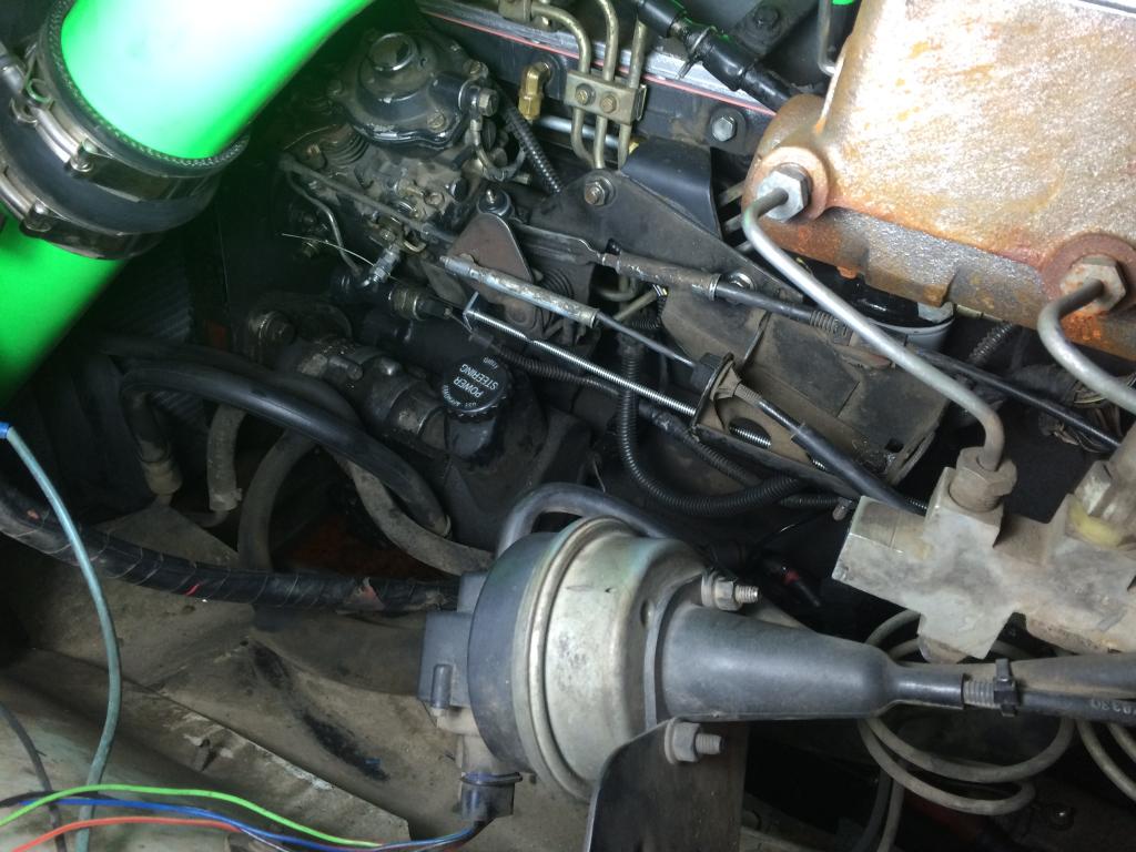

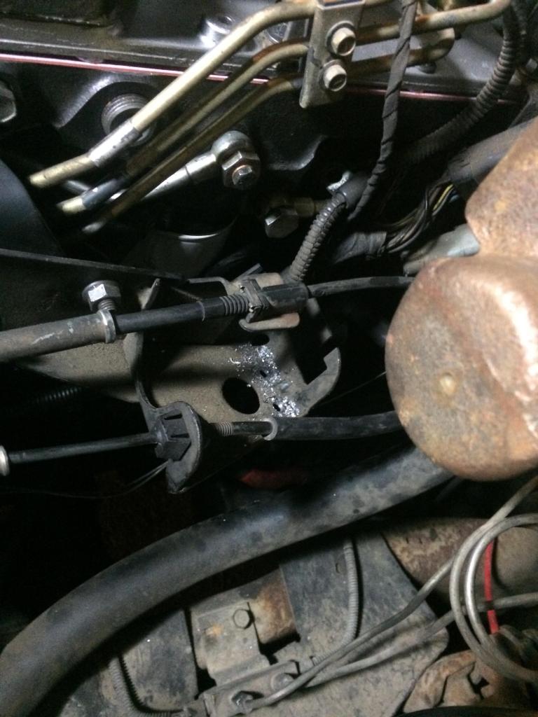

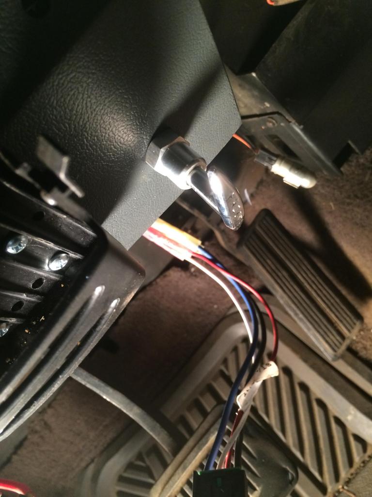

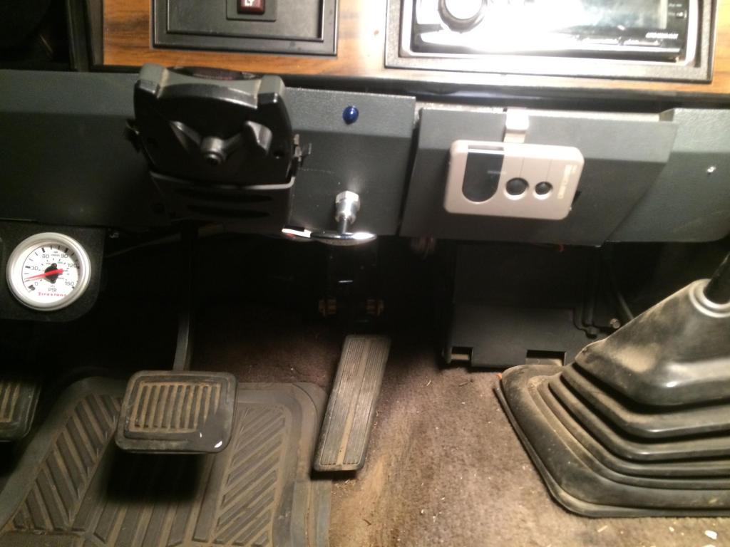

all finished up:
underhood:
fuel:
no fuel:
don't forget to use a rubber grommet in the firewall

I thought initially that it was going to be a high idle set-up....but a manual shut down is good too. Well done!
high idle would be sweet too.... if I had a PTO
turns out I fudged something up on my manual kill lever and now at full pull it will not shut the engine off haha. so now im looking into that.
That would be lever travel on pump VS cable travel.
