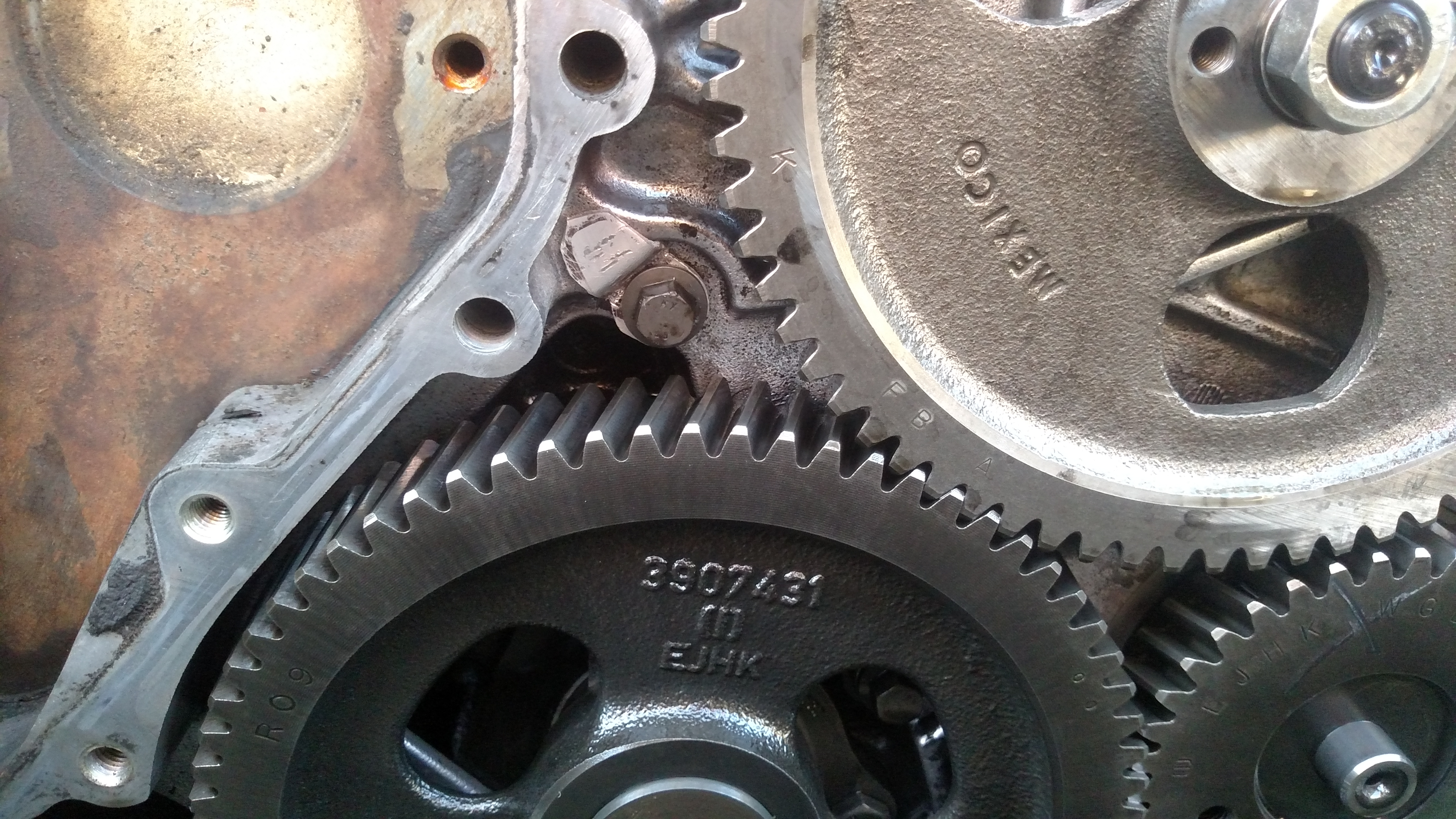

Made a KDP tab out of some thin scrap.
The KDP bolt and the bolt below and to the left were both sorta tight. Maybe 5 ft/lbs and the two bolts behind the cam gear were actually loose. Not out but just finger tight.
The two bolts at the lower corners outside of the cover were tight.
It's amazing how outta sight outta mind things can be. I'm glad I didn't wait one more second to do this!
It's funny how the KDP gets more ink on the forums then the case bolts do...and it's almost always the case bolts that are sitting at a potentially disastrous state.
Glad you got them all sorted out!
